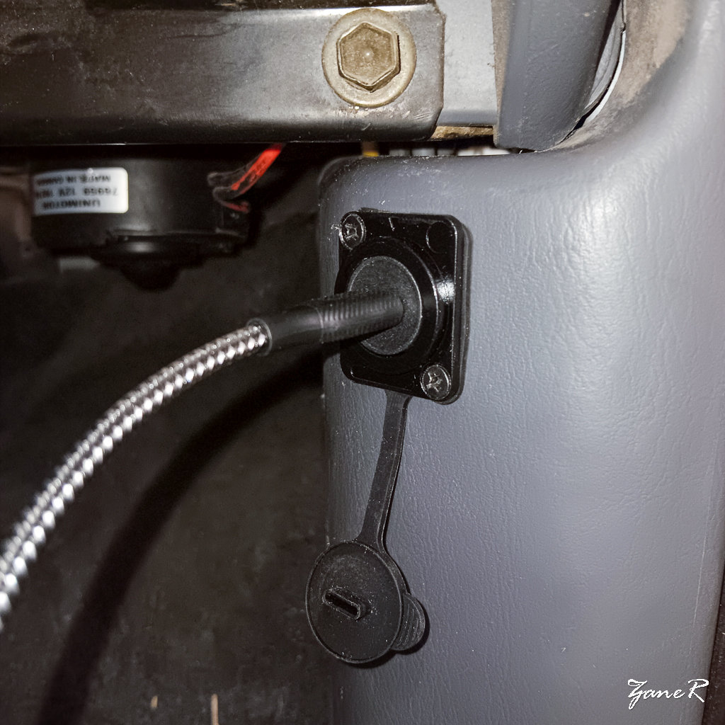

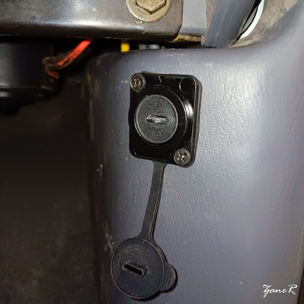

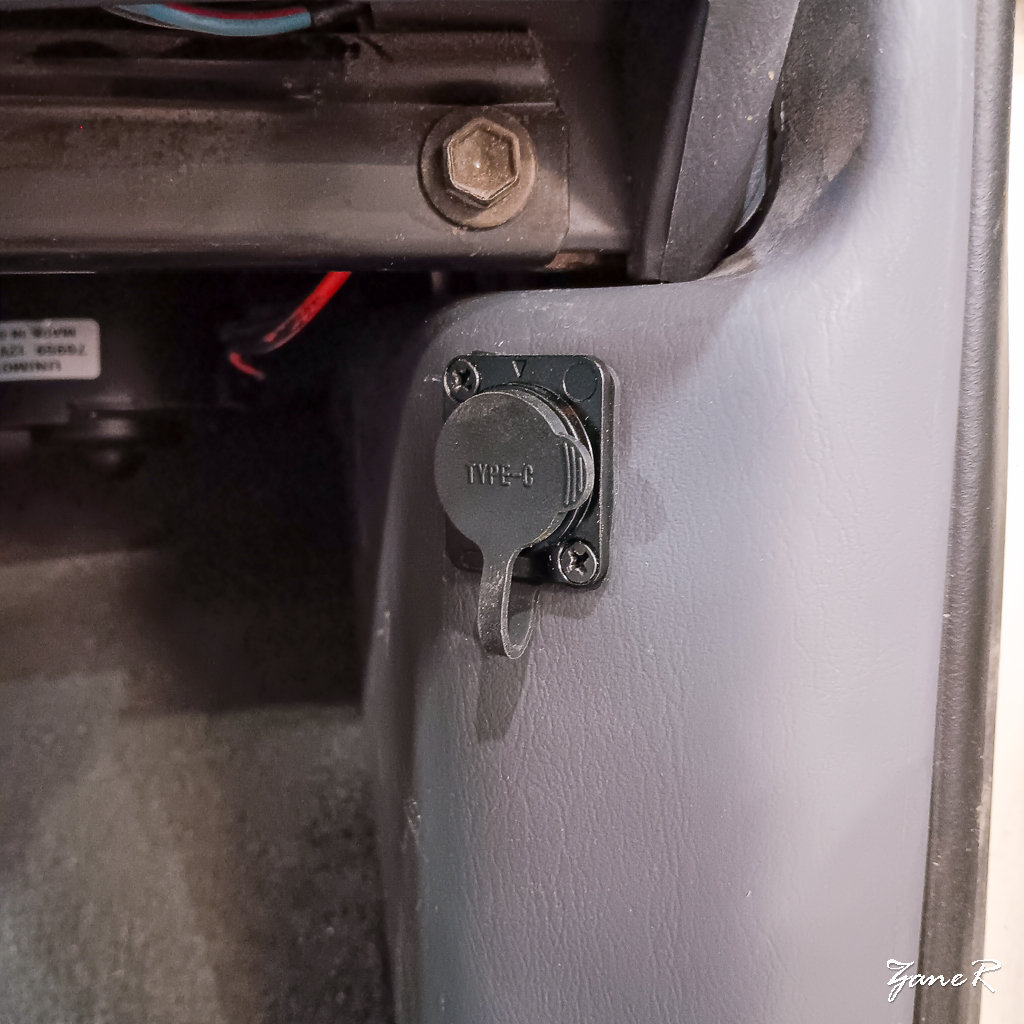

    Installed a bulkhead for the Haltech interface, got tired of the glovebox cable being in the way. Also changed it over to USB C since all my laptops primarily use that now

    Ooo good idea changing over the plug type. Didn't think of that.
    I added a type B bulkhead where the ashtray used to be.

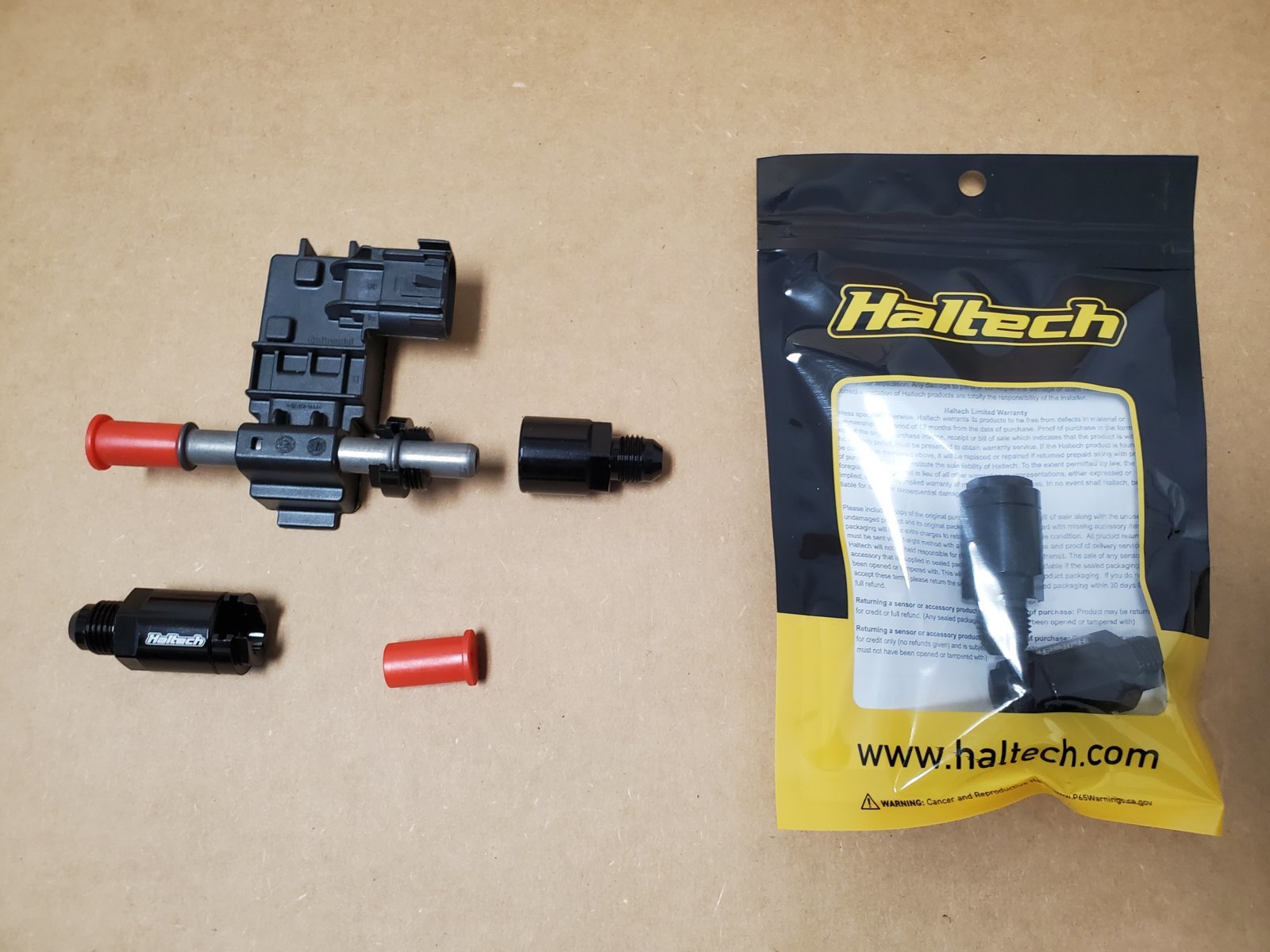

    Flex sensor and related items showed up. Turns out I ordered two pairs of adapters (gm 3/8 to -6 an), if someone needs a pair lmk.

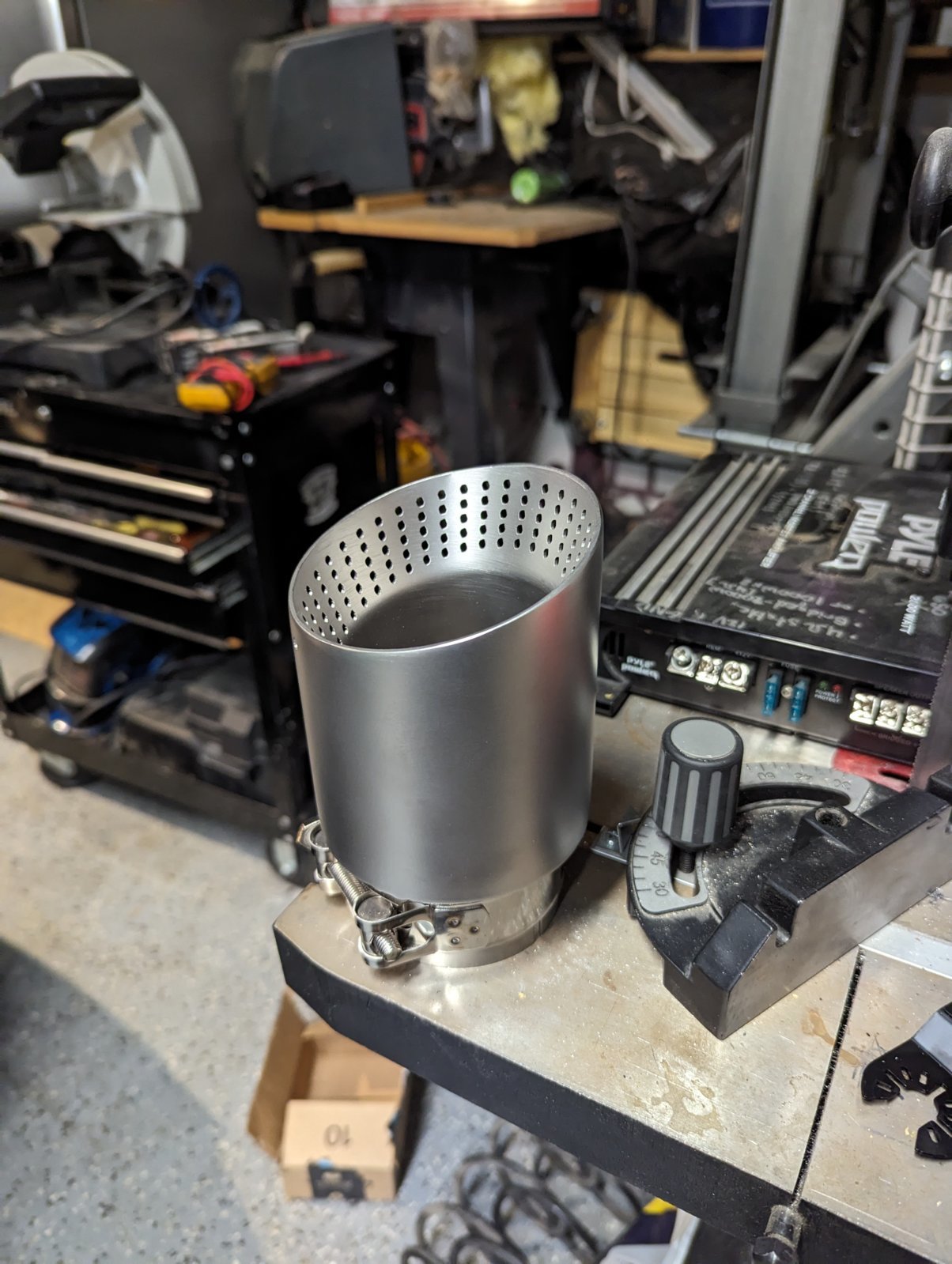

    I also spend some time checking exhaust hardware and tightened more than expected. Right now I'm mulling over ways to remove my 1st cat because it's barely a 2" pipe thats welded in the wrong way according to the directional arrow. Everything else down the line is 2. 5
