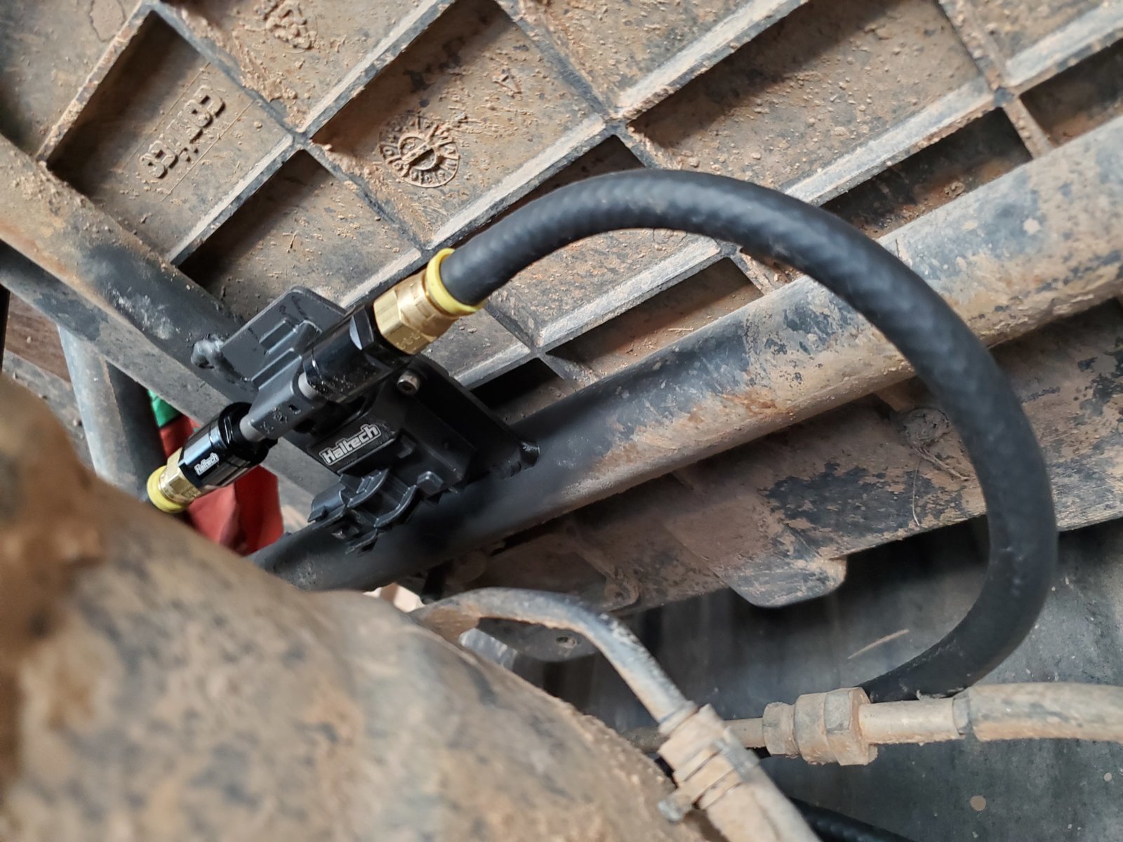

    That's the beauty of a adapter harness.
    I got the sensor mounted up. Made a quick plate from some scrap and sneezed some mig up in there.
    To help anyone in the future..
    The factory return line line is 6mm. I used 6.3mm with a hose clamp and it's fine.
    I also used (2) -6 to 1/4 barb adapters. I should have got the 3/8 Gm to 1/4 barb adapters, oh well.
    The mounting bolts are 4mm diameter. I used ones 12mm long with nyloc nuts.

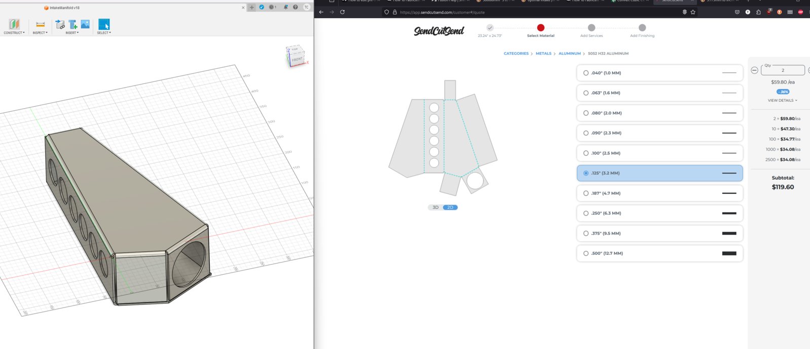

    Considering it for fun...obviously have some actual measurements to take still. Would be interesting to feel how effective a manifold would be with shorter runners and larger plenum volume
    Anyone have any design recommendations though?

    The adapters I used were brass units from Parker. So no link. Nothing too crazy.
    I thought I saw 3/8gm to 1/4 adapters but I was wrong.https://www.racetronix.biz/p/adapter-qdf-3-8-5-16-barb-black/qda-38fhb56cl
    About your intake, I think it's worth a try but idk if the 5vz revs high enough to really take advantage. It would definitely loose torque with a short runner intake. Cams would need to be upgraded to shift the power band to the right.

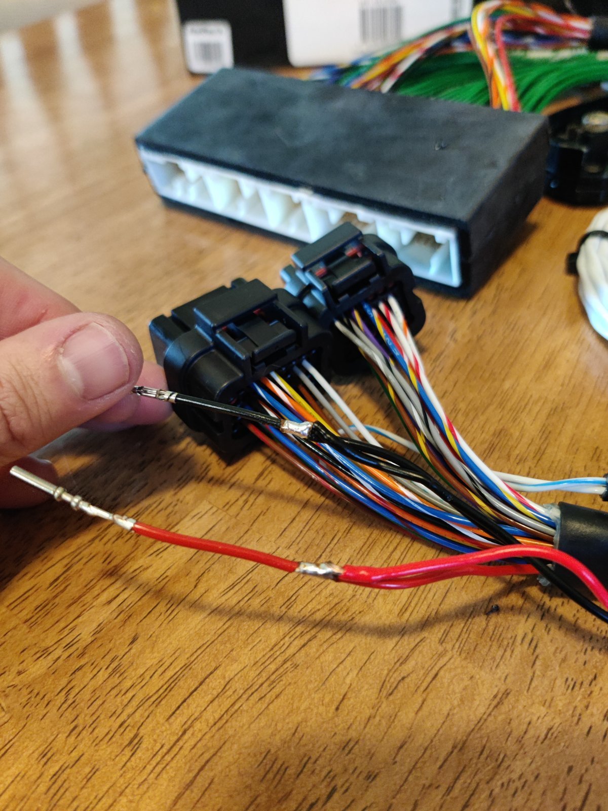

    Progress is being made
    I'm pretty happy with my soldering. It's definitely better than my welds

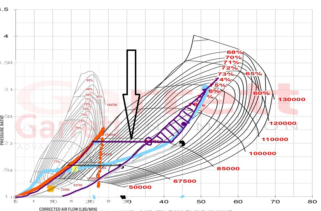

    Yah I suppose staging would be the right word, but I'm gonna attempt to do it via the downstream of the compressor side with a solenoid on a boost-activated butterfly valve, triggered via a load table so I can run out the compressor map of a single turbo and bleed it over into the other one as needed (is that normal? idk). I had a picturesque mockup of such a thing a while ago but I kind of abandoned the idea after I couldn't find a suitable check valve, until I realized this method could work. It was actually intended for my Saab, not the Taco. And it would work using almost no additional equipment since I already have the valve and a spare solenoid - I just need some adapters to fit the valve before the merge pipe, and I need to greatly expand the size of the exhaust side balance tube by grinding it down under the wastegate and rewelding the bottom. (oops guess I explained it after all)
    Attached is from the Saab project which was going to be fully bi-turbo until I couldn't find the equipment needed, so it assumes a secondary larger turbo that fully takes over. The principle would be the same with two parallel turbos where that horizontal line is, just imagine a ghostly overlay of the leftmost map resized right with the lbs/min x2:

    Well it is a much larger circumference than an exhaust valve though which would take a lot of the load off.. But I'm kind of proposing a simplification by not using pre (exhaust) and only doing post (basically a turbo throttle plate). Sure, you lose a bit through the exhaust wheel vanes but in theory the cold side turbine cannot flow with the post valve closed, which would stagnate the exhaust side flow, forcing most of the exhaust gas through the other turbo - path of least resistance and still an improvement vs not having the system in place...in theory
    Results would be most noticeable at partial throttle/low-med load
