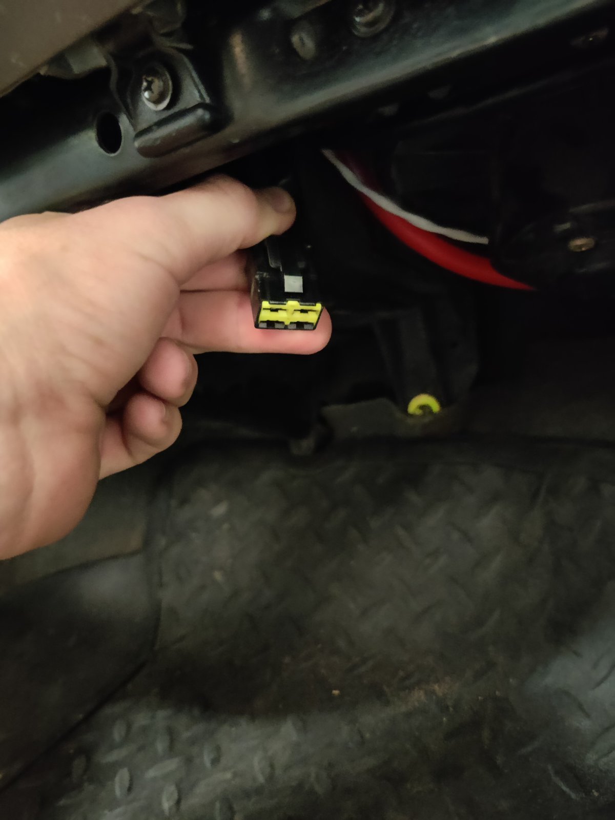

    Found the blower motor issue

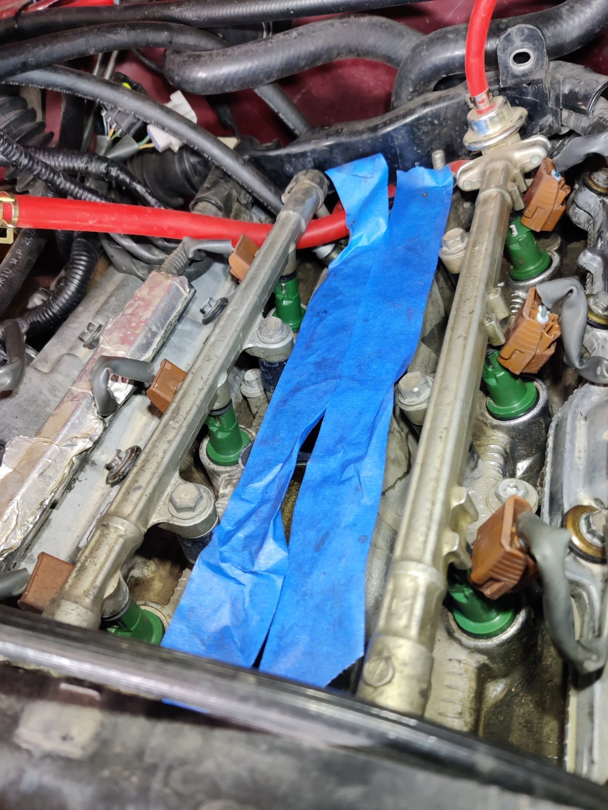

    I busted out the shop vac and sucked up everything I could before popping the injectors out so hopefully very little fell in IMG_20240802_151613.jpg
