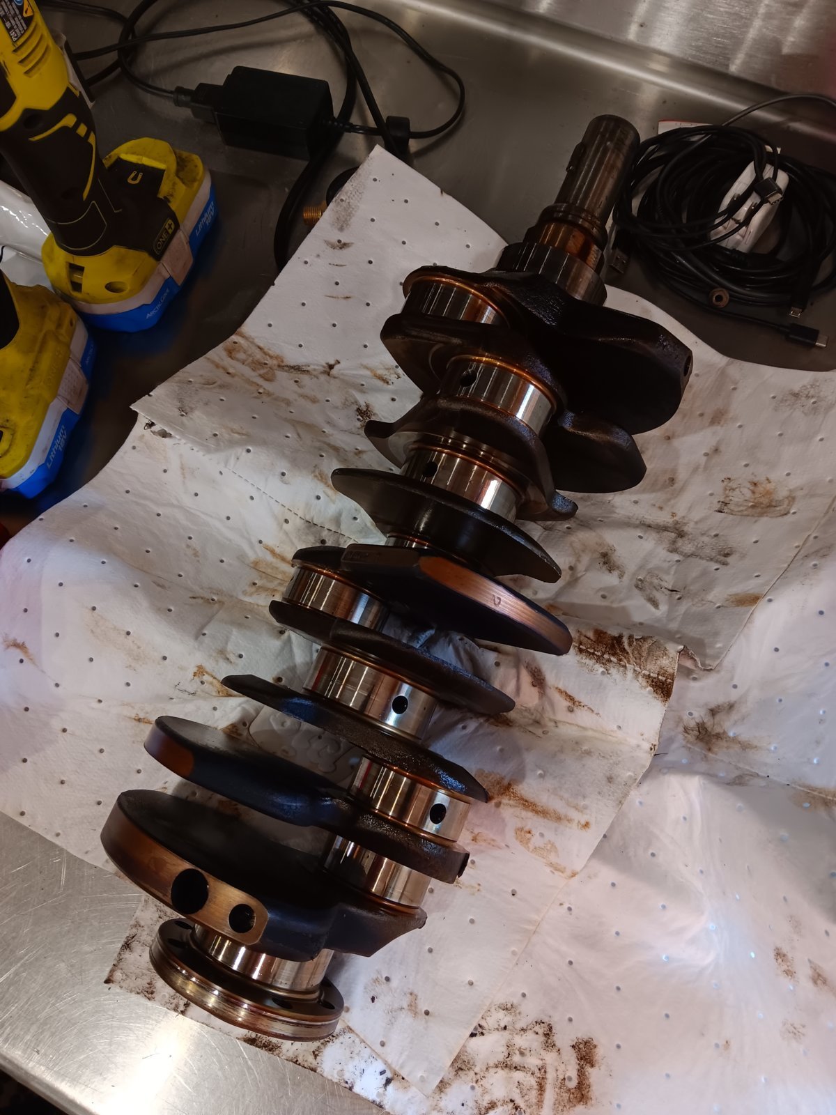

    It's less Tacoma and more mod
    Forged VZ crank acquired

    3VZ crank?

    Yup out of a 94 Camry 3VZ-FE

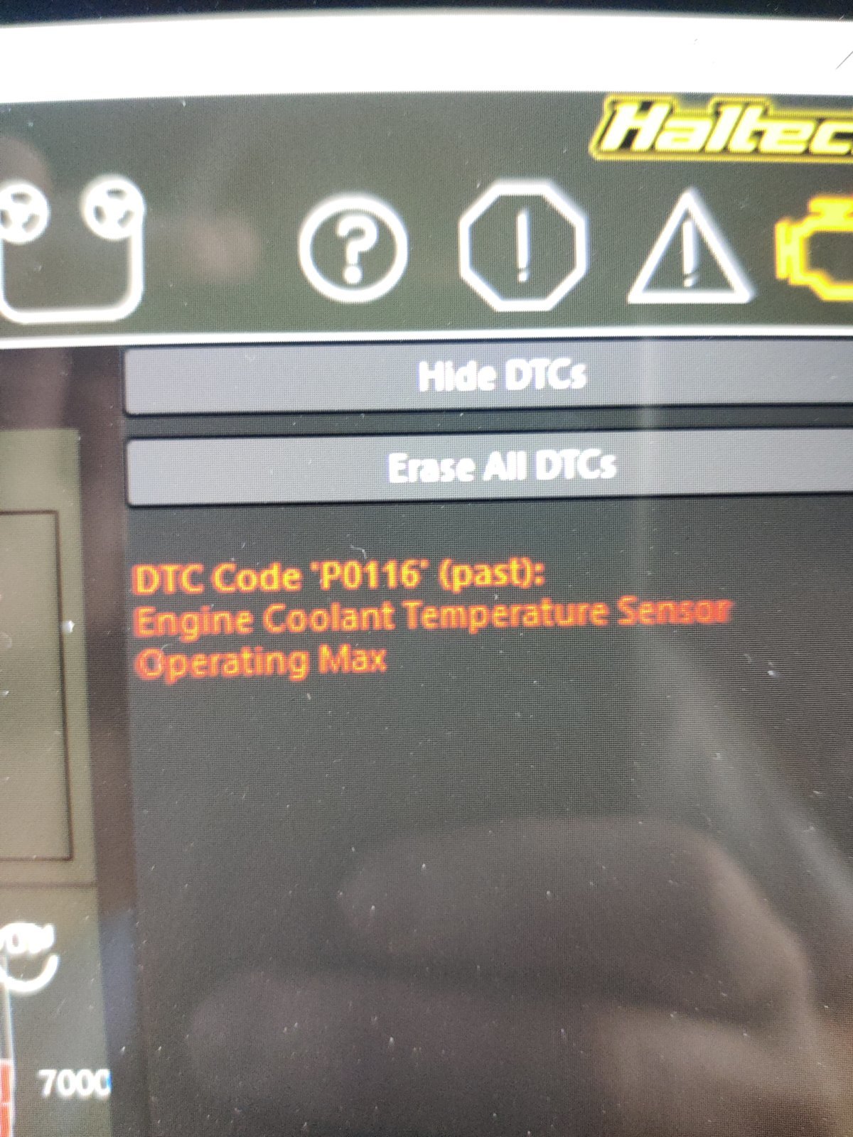

    I get that quite a bit if I idle in gear too long (A/C on more prone). Thought it was a hardware glitch or a temporary short for a while until I actually watched the CTS reading rise a couple times. Not sure what exactly controls the rad fan clutch, but it needs some encouragement. My cluster temp gauge also has risen higher than center in conjunction. This never happened on the factory ECU but not sure what needs to change

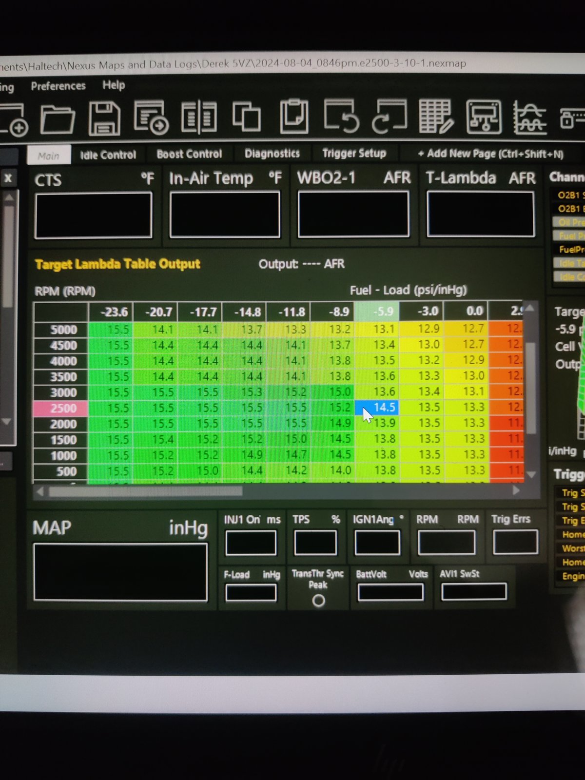

    My cluster temp gueage usually starts to go above the halfway point right around 210/215, It was reading 220 when that code popped up. black ridge on I-15 between Cedar and St George is brutal and being able to make that drive without issues is important.
    I'm pretty sure I experienced some knock or pinging for the first time in that very drive yesterday.
    Ambient air temps were 100+ intake air was around 112 and the coolant was scorching at about 220 and right at about 5 psi is sounded like a couple paint cans were shaking under the hood. If I let off it would go away but as soon as I started building boost past 5psi it would come back.
    Id like to cap my boost pressure off at 4psi for right now but I haven't been able to find where in NSP to make that change.
    Seeing the coolant temperatures rise like that felt like a total kick in the nuts

    We can dial it back, but I'd like to see some logs first, I have a feeling it needs more fuel in the map, gotta drive carefully while that all adjusts, it's not quite ready for a full romp. I have a remote tuner I could hook you up with for a more complete dial in

    I don't know how to initiate the logger
    As soon as I heard the knock I touched the icon on the top right hoping it would start but it just opened up some menu that was too hard to try and read in the situation.
    I did notice it was right on a point where the color on the map was transitioning from bright green into the more yellow shades
    Right here

    While you were adding to your comment I was uploading the Pic of where i think it needs more fuel.
    I remote tune is probably wise
