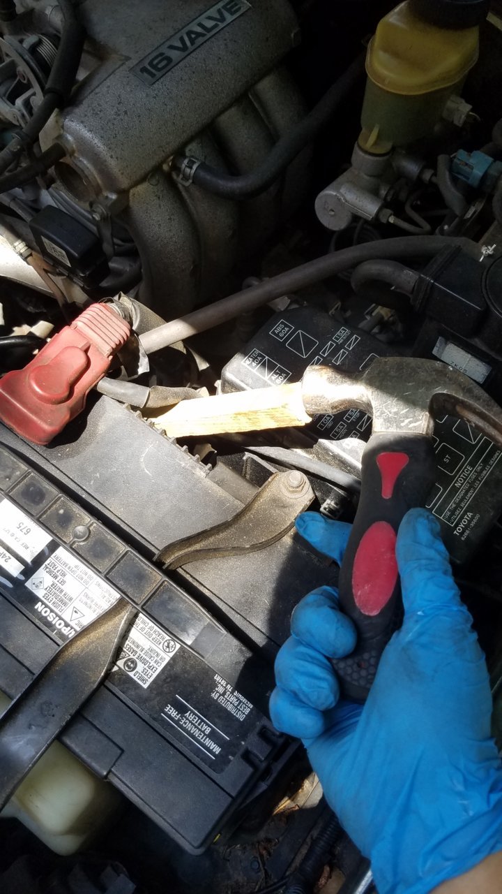

    Tip for getting Alternator belt on!
    After loosening the tensioner, the bottom two bolts where the alternator pivots, and the locking bolt. If your still having trouble stretching the alternator belt on then that means the pivot point of thr alternator is just seized up, and needs to be coaxed to bend to give way for the belt. First get some pb blaster or any kind of lub on the alternator pivot joint. Get you a peice of wood, and put that on the edge of the alternator and hammer that wood end to force the alternator to pivot more on the joint you loosed the two bolts on the bottom. Be sure to extend the tensioner far enough to accommodate the movement induced via the hammering. Doing this easily gets you the slack to put the belt back on easy peezy.
