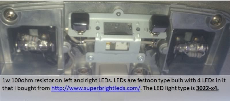

    Hey just wondering if you can swap the original interior "dome" light to a LED one without any re wiring or adding a ballast or such.

    i had to solder a small, 100ohm resister in parallel with the bulb when changing my dome and map lights to led bulbs.

    I did this exact mod to my 2003 a little over a month ago. You have to add in two 1watt 100ohm resistors to the map light and one 1watt 100ohm resistor to each map light like so...
    Here are the bulbs I bought....
    Dome Light
    Map Light
    Here are the results
