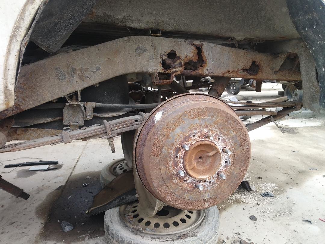

    i hammered a couple of those holes myself just to see what was behind all that

    Here are a few frame images from November 2018 that failed inspection at the dealer in my southeastern Ohio hometown (rust belt central). The young kid who bought the red truck was one of the last Gen1 trucks likely accepted for the enhanced warranty frame program. It looked pretty good but for the frame. The dealer took him off the road immediately on seeing the condition of his Tacoma and put him in a 2018 loaner Tacoma for *months* while a Gen1 frame was ordered. (Most of the frames are Gen 2 these days.)
    The biggest area of concern, in my limited experience, is the area around the rear axle. Look especially for cracks, as shown in detail in one of the images. (Note: These images are full-size, so if you want a LOT of detail, click on each to expand them.)

    Yep right there at the shock mount is where mine went. Only on one side though. Luckily my cousin parked on an unlevel surface the same way for years and my damage was pretty isolated to one spot above the wheel. I safe t capped it and I am happy with the restoration for now.
