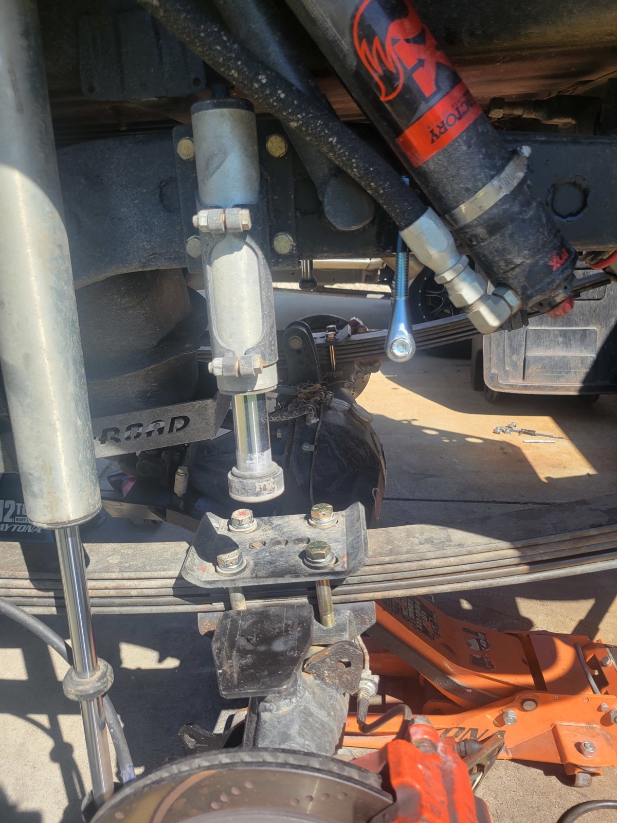

    I'm running 5 leafs now. I started off with 4 but it didn't seem to be enough. And it was bottoming out too much whoops.
    After I tested, I put the 5th leaf back in, raised my bumps a little, lowered my lower shock mounts, and added some pressure to the hydro bumps.
    Axle wrap isn't really a thing for me lol.

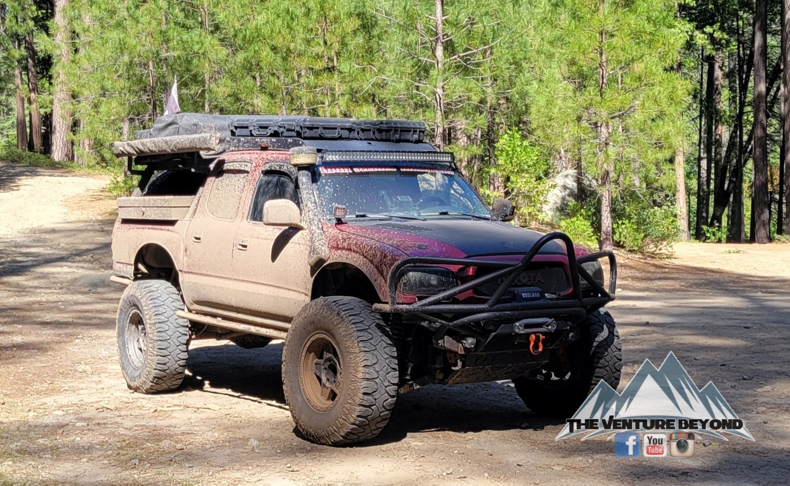

    Mine sits like this fully loaded (minus gas cans).
    That's with all tools, spares, camp gear, cooler, 6 gallons of water, recovery gear and a 37 inch spare. There's a rear winch mounted too.
