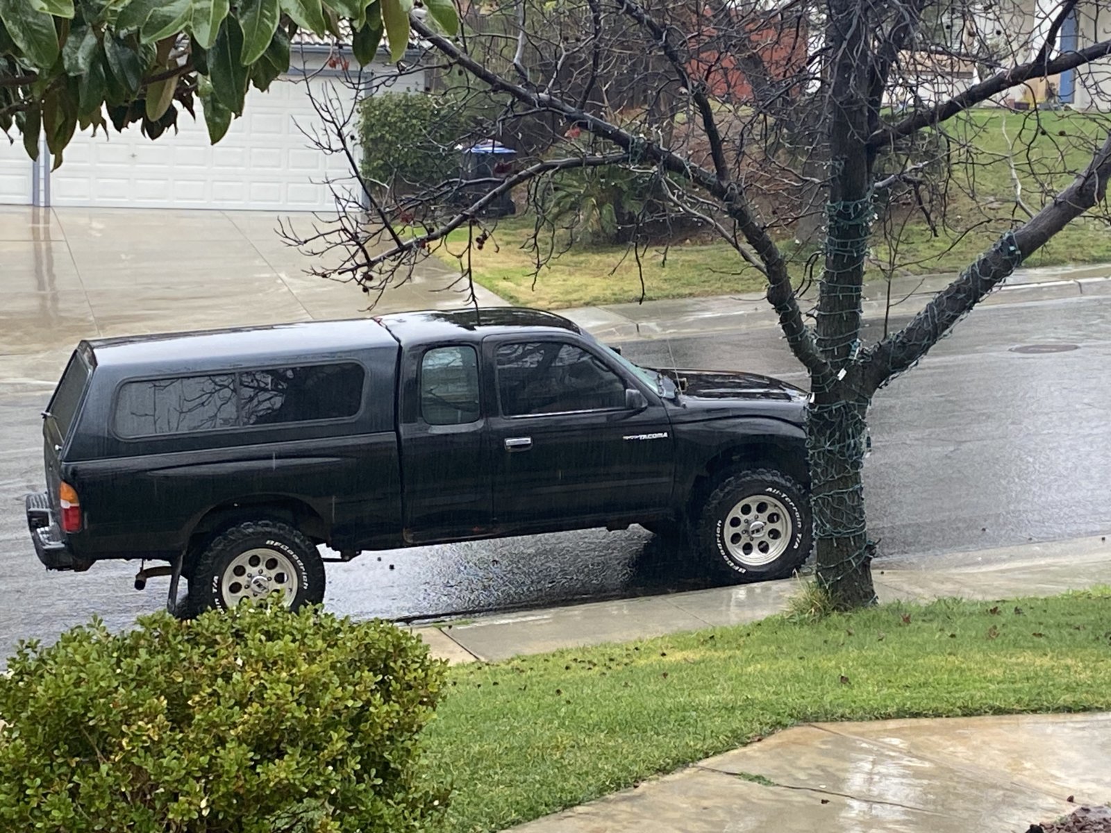

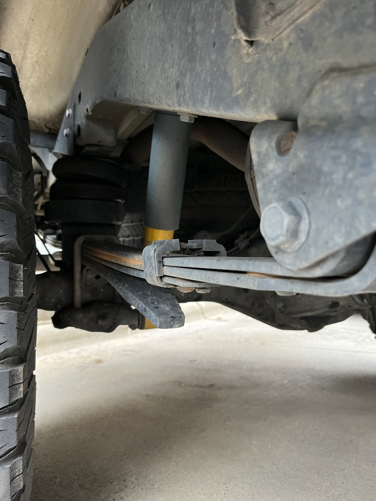

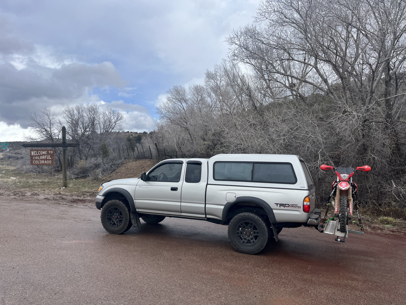

    What if I'm running air bags? I've had a set of firestone ride rite air bags installed for about a year with the original leaf pack. I also have a SnugTop on the truck. I always run 5 psi in the air bags when the truck is unloaded (with camper shell on) and air them up as needed. Oh and I added some 1" spacers to the front coils to level things out because the air bags added about an inch of lift when unloaded.
    Took a peek at the leaf springs today and it looks like they are starting to give a little bit with the truck unloaded. So I'm considering replacing them.
    Should I go with a standard replacement set or a heavy duty set?
    After reading about the heavy duty springs and seeing pics of 1st gens with them installed, I worry it will create additional lift in the rear with the air bags, which I don't want. And I like the fact that I can easily level the truck with the setup I have.
    Here's a pic of my rig fully loaded down, which is usually just on weekend trips:IMG_7770.HEIC.jpg

  15. Feb 4, 2024 at 7:30 PM
    #35
    turbodb
    turbodb AdventureTaco
    Feb 9, 2016
    #177696
    8,529
    Dan
    PNW
    2000 Tacoma Xcab 4x4 SR5 V6 TRD
    AdventureTaco
    If you used airbags for managing additional weight, the leafs don't matter all that much, and from your photos, the curvature you have on yours looks pretty normal to me.
    With airbags, leafs are primarily for lift. If you like the lift you have with the current leafs (+bags), you're good, don't get the HD springs.

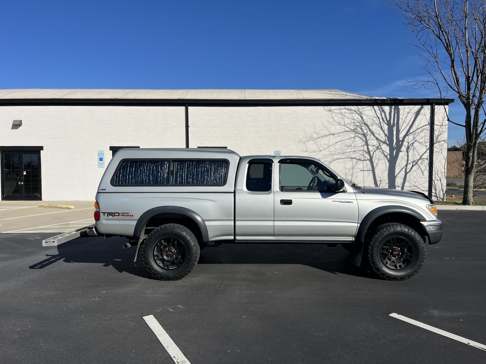

  18. Feb 5, 2024 at 12:38 PM
    #38
    mrdetails
    mrdetails Member
    Feb 4, 2024
    #443167
    5
    Appreciate the input so far on this @turbodb @MT-98 @FinsFan909 !
    Initially I ran the air bags with 0 psi in them when I had nothing but the camper shell on and before I had installed the 1" spacers on the front springs. But quickly noticed it was like riding on bump stops - it was horrible around town. I was mostly just trying to avoid the rake that the 5 psi in the bags introduced.
    Now with 1" spacers installed on the front springs + 5 psi in the air bags the trucks sits level:
    So I guess I will stick to the standard leaf pack if/when I do decide to replace them. Although I imagine even then a fresh pack vs a 20 year old OEM pack may add a slight lift, right?
