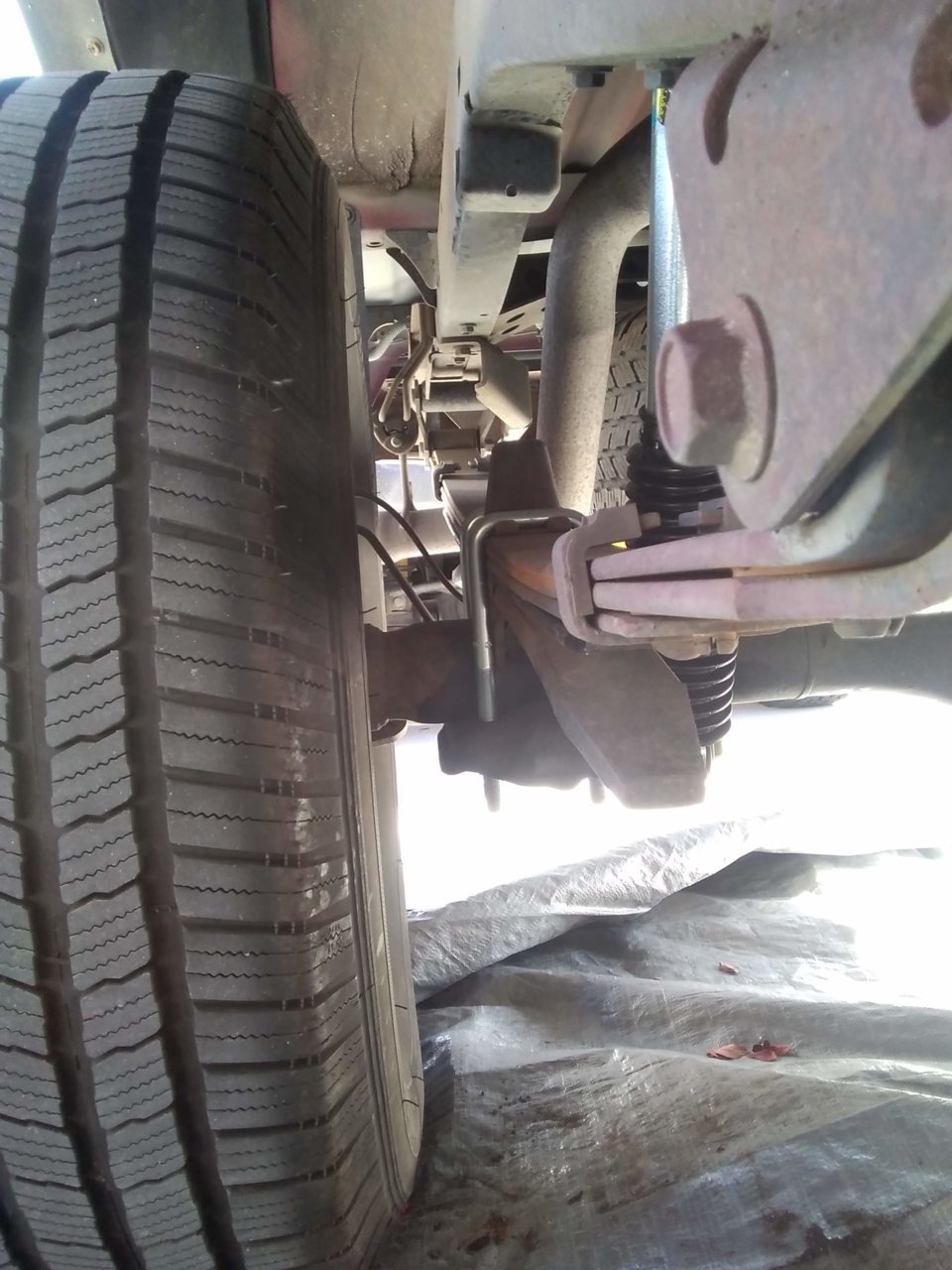

  8. May 24, 2019 at 5:14 PM
    Tacomeat2019
    Tacomeat2019 [OP] Well-Known Member
    May 21, 2019
    #293949
    78
    2001 4x4 / 2013 4x4 dcsb trd or
    Not the best but here is a pic

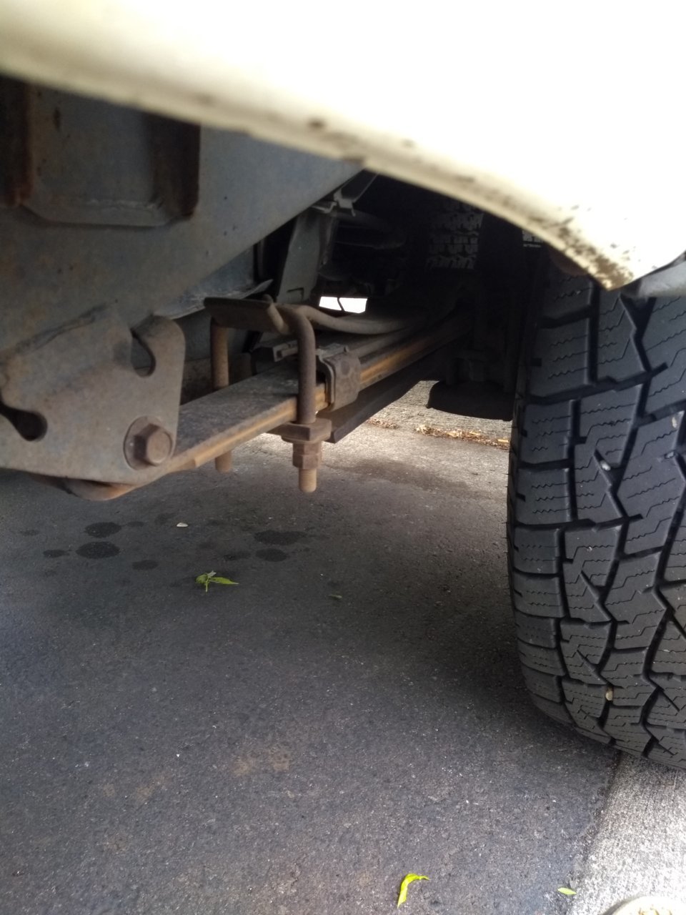

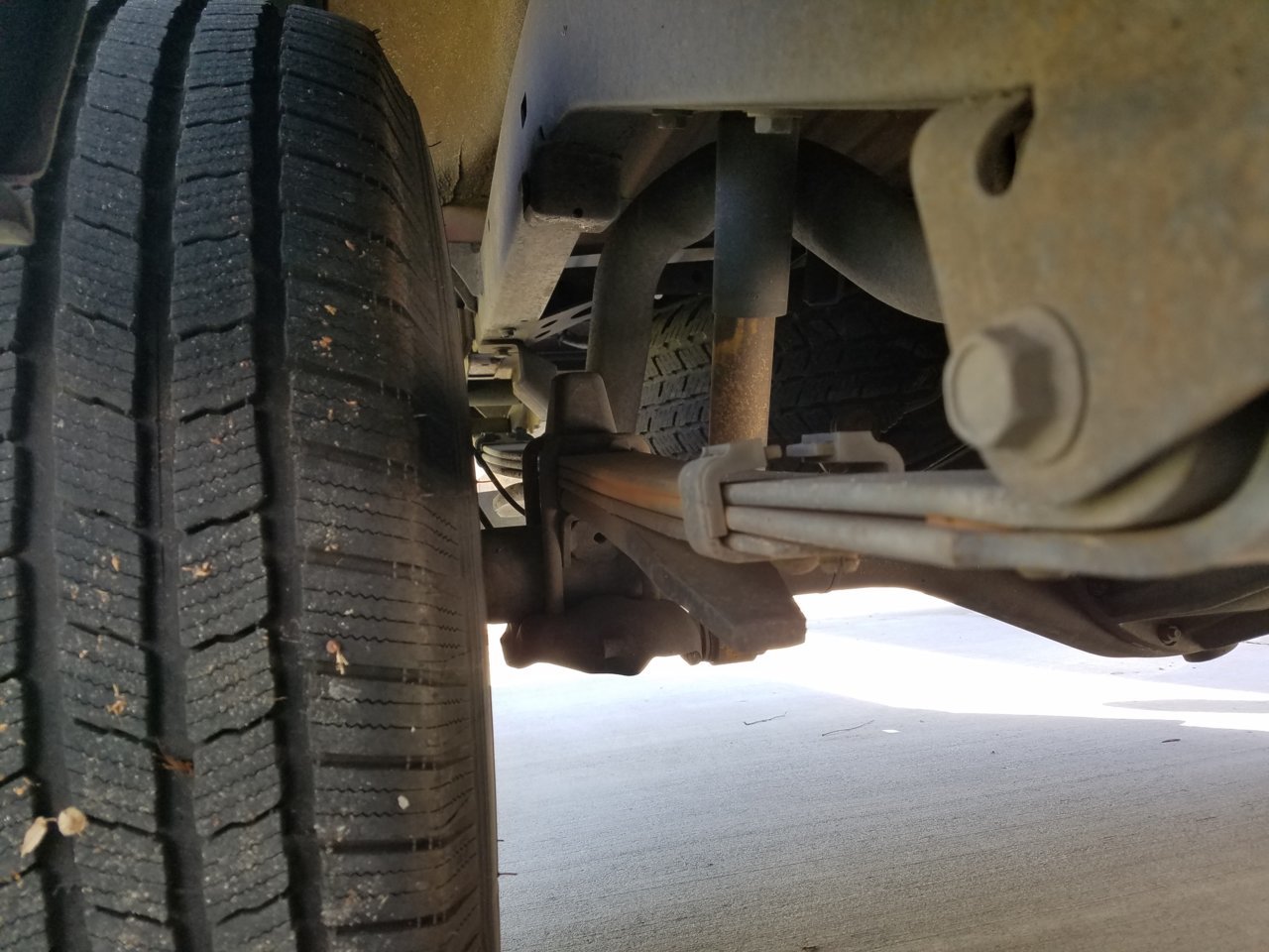

  9. May 24, 2019 at 6:22 PM
    04TRDV6
    04TRDV6 Well-Known Member
    Sep 30, 2018
    #267867
    308
    Lynn
    Houston, TX
    2004 TRD V6 XtraCab
    Pics before and after adding a 1.5" aal. Resulted in about 2.25" lift. Really happy with the result (but the lift was a little more than I wanted). I do not typically load the bed up with anything other than the odd trip to the lumber store or some furniture helping people move stuff. I don't carry any constant load like tools, gear, etc..

    Your leafs seem much better in the second picture, however AAL will only bandaid the problem if your original leafs were starting to sag. Hard to tell but they didn't look like they were in terrible shape before your AAL. PS the leaf on the bottom with the negative arch is called an overload leaf spring. It is meant to have that negative angle because when the rest of the upper stack is under full load, that leaf will actually flatted out to help support the load. How does the ride feel so far?

    The ride is stiffer than before the "refresh" but not bone jarring. I also put 5100s on the front in the middle setting with the stock coils (one of my front shocks was blown and clunking which sent me down the rabbit hole in the first place that included lbj's, sway bar links, suspension, etc...). So stiffer all the way around but it's a good 4x4 truck feel. I'll take the $70 aal band aid over the $400-$500 new spring set and replace that band aid every few years if I have to. If you're constantly loaded up with rack, RTT, camping or work gear, etc... aal might not be the way to go but for my use it's worked out pretty well.
