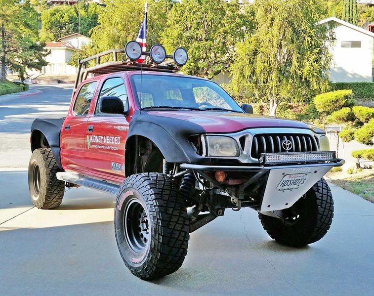

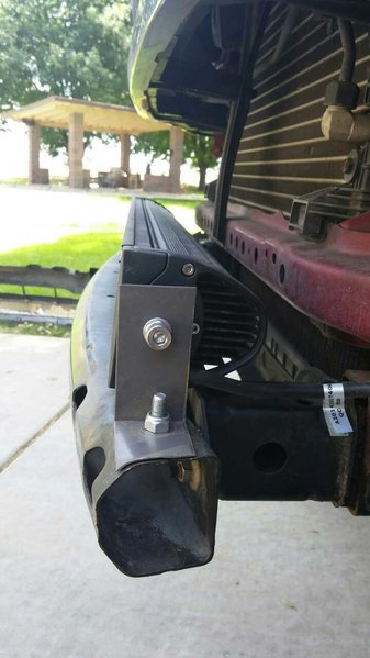

    First I cut the plastic that goes across that gap on the bumper
    Toom the bumper out and ran a square tube across the top and bolted into the bumper mounts on the bumper then welde 2 5" square tub on that to mount the light
    I forgot to take pics but hope that helps

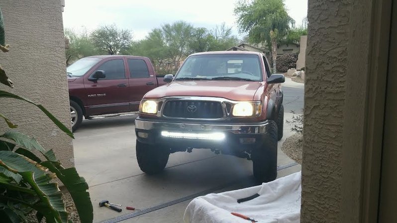

    I put a 30" bar behind my stock bumper, I liked the idea of going behind for a few reasons, one of them being it makes it much harder to steal, you would have to take the bumper off to be able to get back there to un bolt it. I didn't cut my valence at all, it does cover the 2 bottom outer L.E.D.s but, its still plenty bright, and I don't miss the little bit that are covered because I have 10" more of lights....
