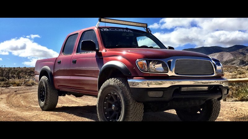

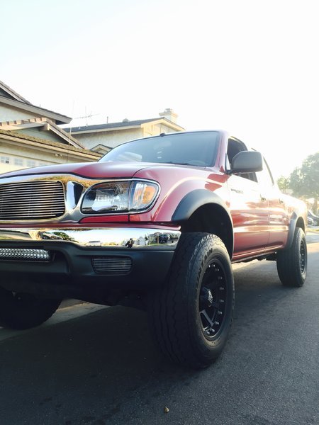

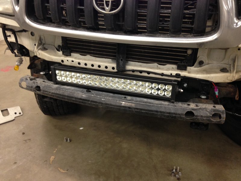

    I bought some light bar mounts from eazycompany of Toyota symbol with horns and fit a 42' light bar up top mounted using threaded rivets drilled 2 holes into A post (where the weather stripping is on inside door) used the weld on each side as a way to measure since they are on both sides in the exact same place. Do not drill on weld. Use a threaded rivet gun to place in holes drilled then I mounted the brackets. Now my mount said 40-42in well it ended up being 38' so I had to bend the mounts wider to fit 42' light bar thus brining the light bar slightly higher then I wanted but it was my first time so lesson learned it's an easy enough fix. I then took it off put clear silicon from auto zone filled the inside rivet like a cream donut put the mount back in place put a lock washer on the outside of mount then bolted that bad boy in. Same procedure all around when done with that I put another coat of clear silicon around the bolts and put my weather stripping back on. Oh and you might have to tighten bolts to be sure door closes properly do this a little at a time and check. That's pretty much how I did my roof LB and ran the wiring behind weather stripping into fender which led to the battery. Bought additional wiring to make If from roof to battery.
    Bottom I had to remove my front bumper bought some metal from home depo. Bought the metal shaped as a L with holes in it and welded that to the dumper I had to measure it to where the light bar would shine out drictly so it was welded to the back of the front bump guard? (I forgot at the moment you will see it) close to the middle and ran a powder bolt and washer through the holes of the bracket holding light bar and metal you just welded. I also spray painted all metal with rust resist. Now I cut off the plastic pieces in the front bumper as seen in above post^ and put that bad boy back on and was ready to go.
    Note: I measured wrong and and had to cut 1/2 in off the plastic on my from bumper for the 22' LB to show through. So measure like 3x Haha this is how I did everything myself and this all was my first time so I'm sure there are better ways this was just the way I did it and I included my mistakes so don't make them yourself!
