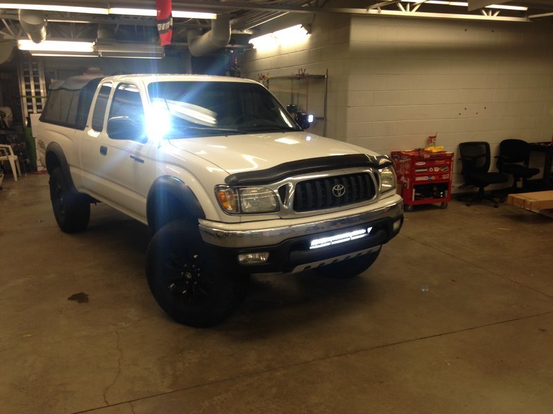

    Nice I might look into that. Just finished installing a 20" incher in my bumper valence. Looks pretty clean I think.

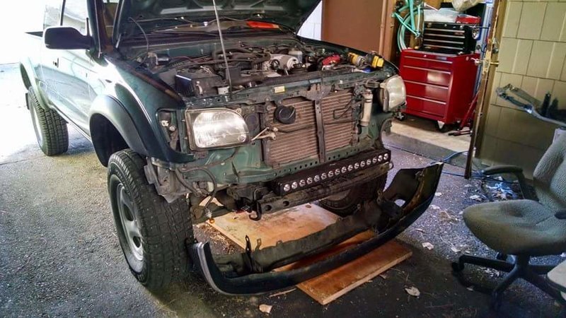

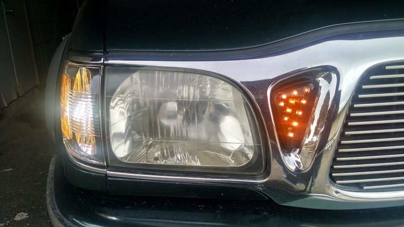

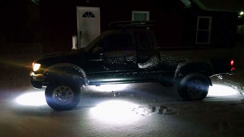

    I thought I'd contribute to this thread. I've attached several photos of my truck as I added lights.
    The bar in the grill mounts to the metal cross bar. I did have to trim the valiance to get it in but it turned out very clean and even. It's a 29" bar with 10watt crees off of Amazon. I can find the link if your interested.
    The amber triangular lights on the grill are actually turn signal lights off a gsxr crotch rocket. I did go through about 3 pairs of these cause the LEDs kept shorting out from water getting in there so I used clear silicone and made them water proof. These were wired to the running lights.
    The switch panel was really fun to make too. It's a lid off a Tupperware container cut to fit the din size, drilled out the switch and indicator light holes and then wrapped it in vinyl wrap. Turned out awesome. I wired it up to an aftermarket fuze box with dedicated relays for each circuit. The relays were triggered by the switches in the cab by switching/providing ground to the relays.
    The rack has two 40watt spots on the front and 4 18 watt lights one the front, back and sides. Underneath is 4 18 watt LEDs that are wired into the alarm system so they would turn on for 30 seconds when you unlocked the truck or when you press the aux putting the the key fob. The truck originally came with manual locks, but I installed lock actuators and presto! Keyless entry.
    The last couple photos were taken with a drone, the one photo at 200'. Pretty rad.
    Hope you like it.

    Thanks bro. The 10watt crees were great, but the bar wasn't a great design. It didn't have a breather port so they fogged up and one of the LEDs eventually quit. Im still looking for an alternative single row.
    The gsxr lights had the same issue but I think they looked pretty bad ass so I just kept buying them and trying different ways to seal them up. I haven't seen another first gen with lights in those slots and those gsxr light fit almost perfectly.

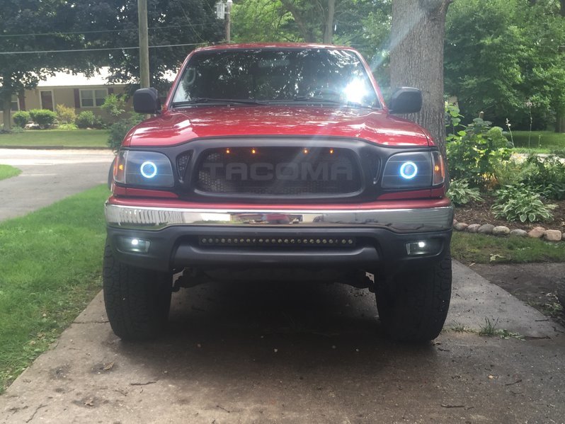

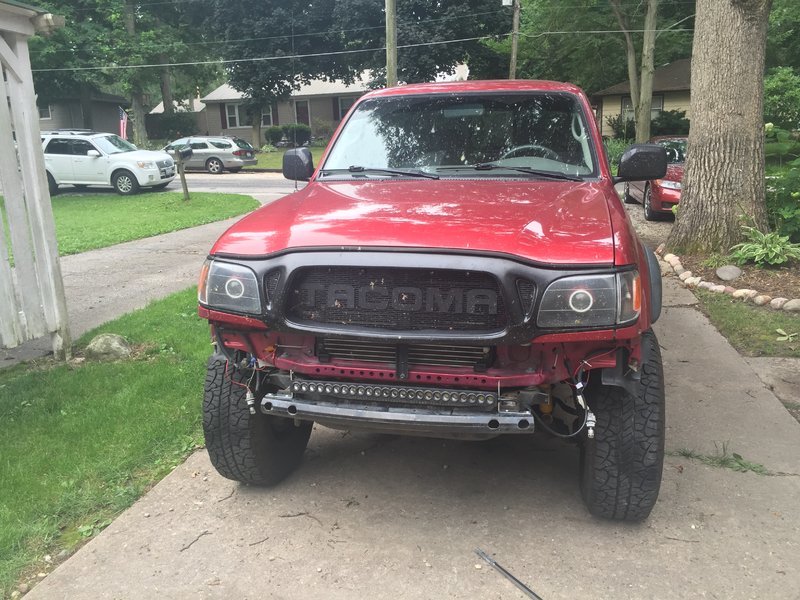

    I threw a 32" (31.5" actual) LED light bar in the bumper. The distance from outside to outside of the frame is 31.5" so putting a 31.5" bar there was a simple job. IMG_2658.jpg
    I cut 2 pieces of 90 degree aluminum (~ 4 inches) and screwed it to the frame and mounted the bar from Amazon ($36).
    Works great! IMG_2659.jpgI wanted something that filled up the space and brightens up the darkness!

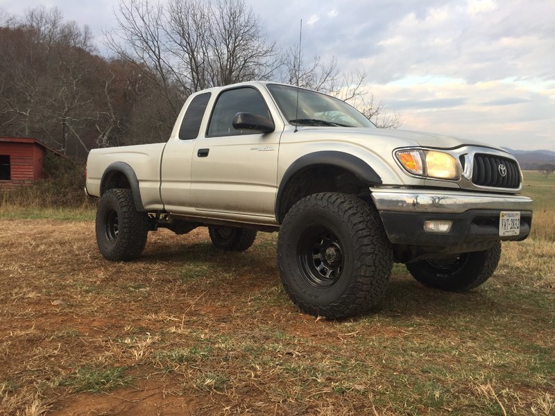

    Bump. I'm in the market for some lighting and I was wondering if I could get a quick lesson on how much I would have to drill cut and whatever else to mount a light bar up top (~42"). Thanks.
    IMG_0006.jpg This is what I'm working with 2001. Completely stock besides suspension and tires.
