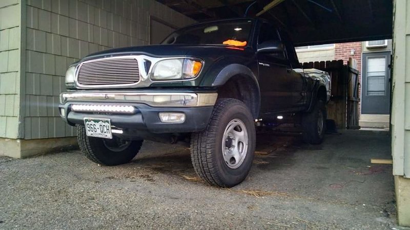

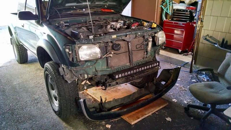

    I just dropped the mounting point of the plates down. It did stick down a little, but it looked ok. This was a 28" single row with 10 watt chips. It's either a 16 chip or 18 chip. Very bright, like the reflection off signs blinds you. It's a mictuning bar I got off Amazon but I can't find it now.

    Cutting was necessary. The inside top lip of the slot in the bumper was what had to be trimmed. You couldn't really even tell it was trimmed. I think I had to trim out two small rectangular slots on the bottom inner lip for the light bar mounts. I'll see if I can find a better picture.

    And it mounts to the bumper support cross bar so the front bumper did need to come off. I drilled holes on the top for the mount bolts and drilled a big hole underneath each hole on top so I could get a socket through it so I could tighten the mount bolts. Pain in the ass to get to, but that was the point. Didn't want it to get ripped off.
    Rocks weren't the issue. Condensation was the issue. They fogged up and eventually one of the chips burnt out. Lame...

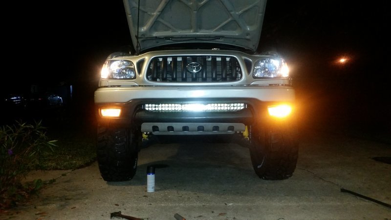

    Ponce Inlet, Fl
    2004 Tacoma 3.4L Double Cab TRD
    3" ome lift 883. Fnfx pros.
