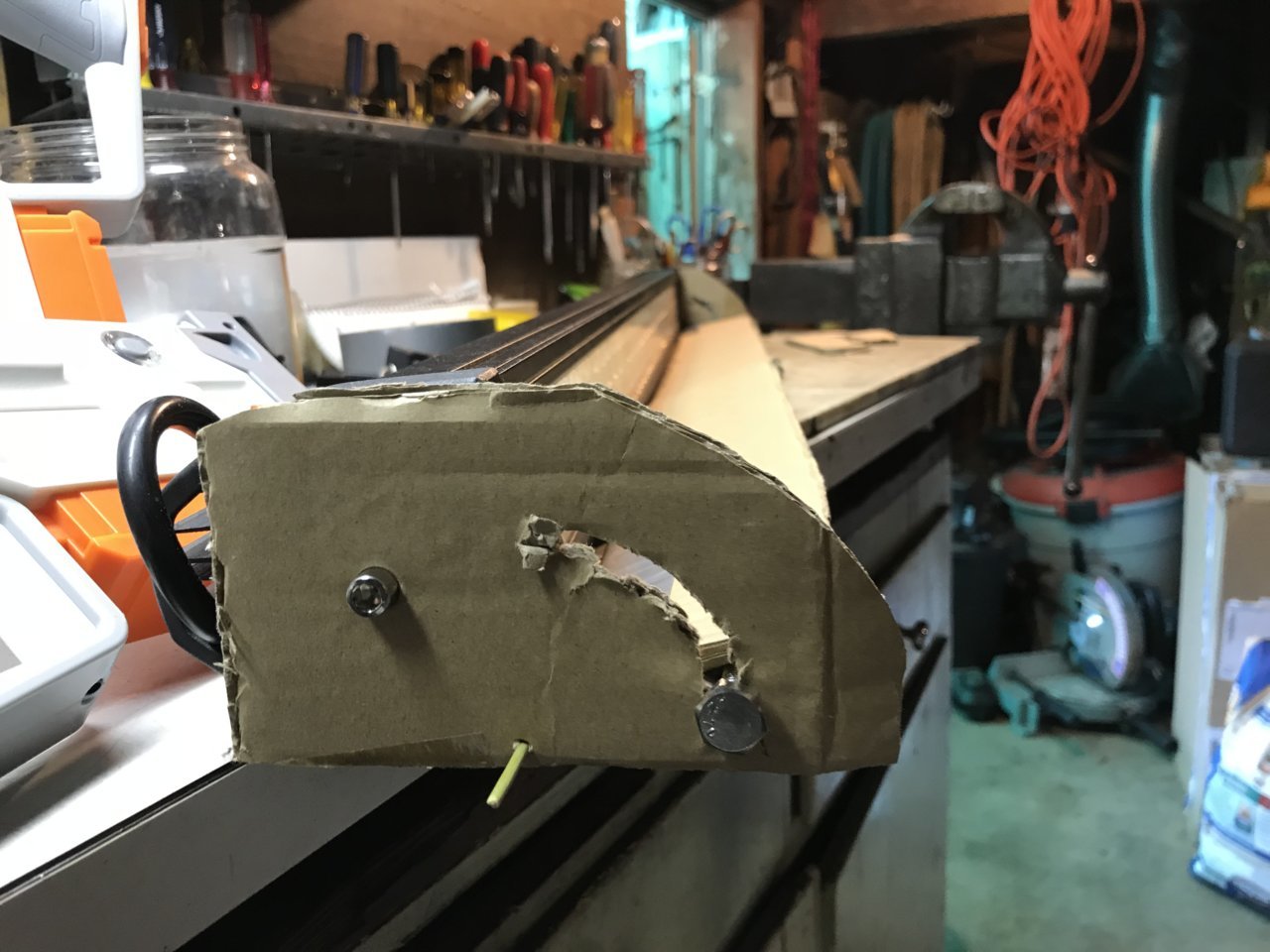

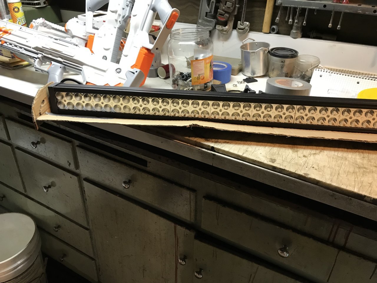

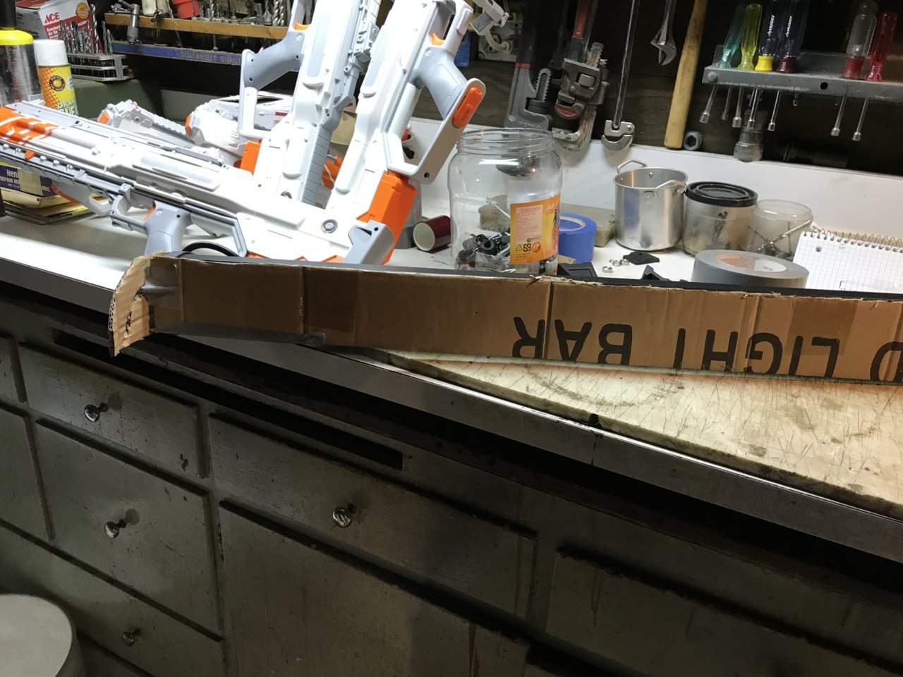

    This is what i came up with in about 10 mins(dont mind the messy basement)

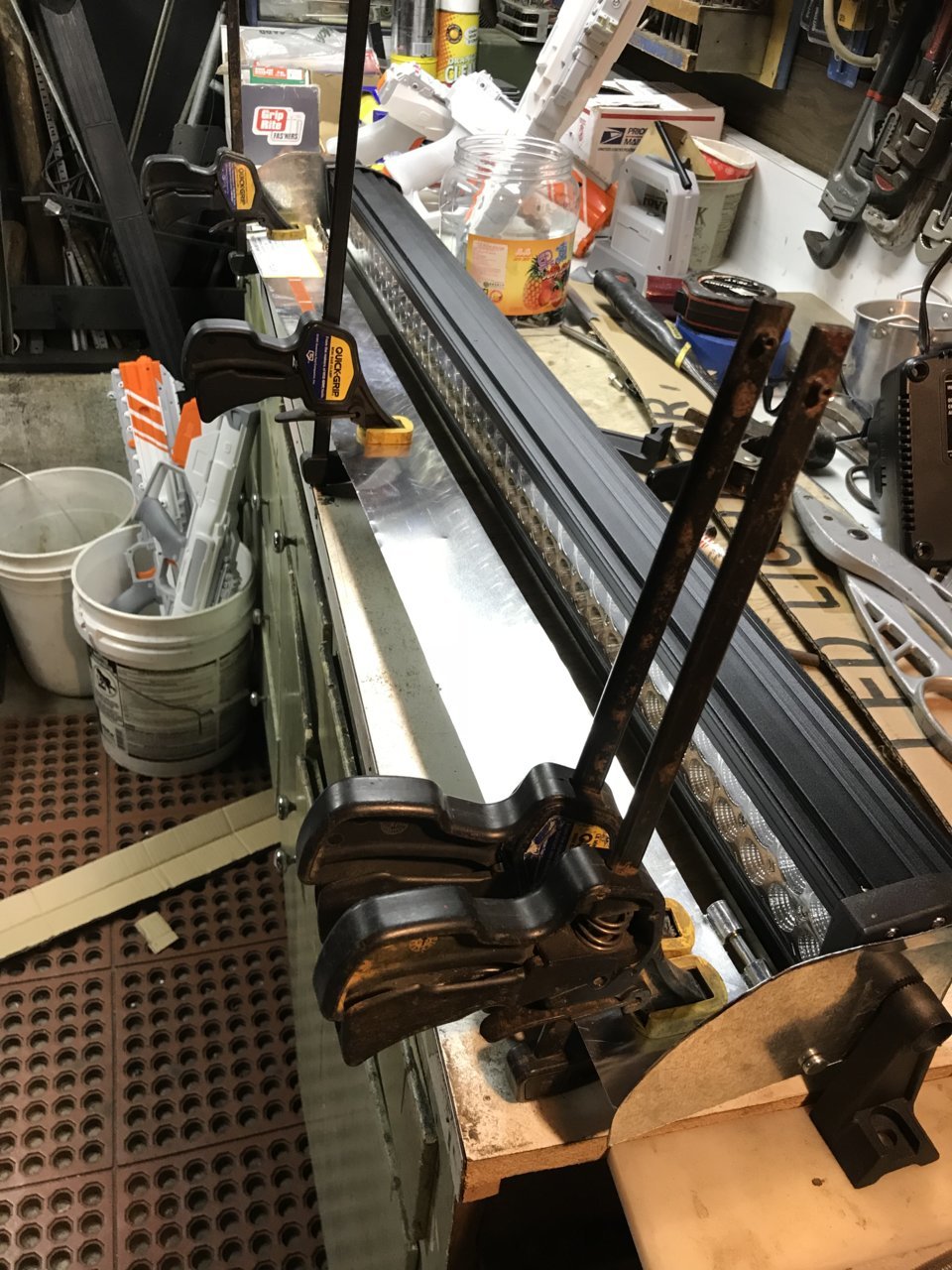

    Starting to make a mock up out of sheey metal to get a better idea before I start cutting steel.

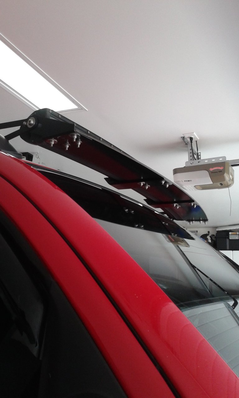

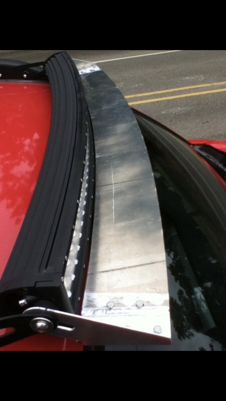

    Bulky? A bit. Works? Absolutely. That is actually mine. I had to add brackets in the middle and a second bolt (small) on each due to vibration & lift. The visor would vibrate (almost flap) while driving and caught the wind once and flipped up. I also reshaped the brackets and moved it back an inch. I have since removed it and will be selling the visor when I get back home week after next.

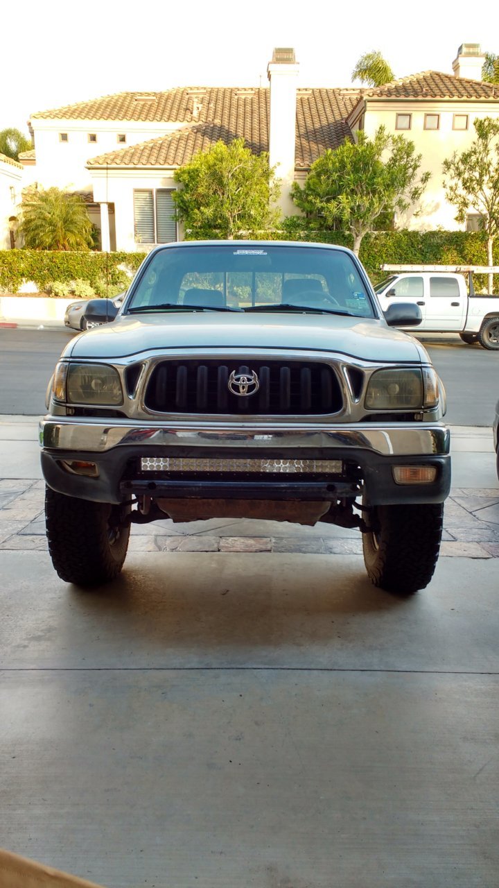

    Found this to be a good mount location, looks good to me :cool:
