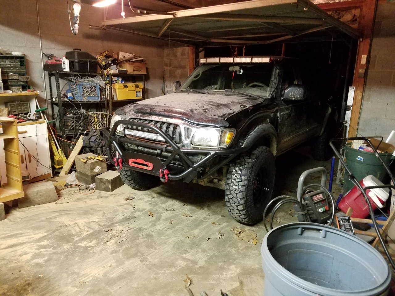

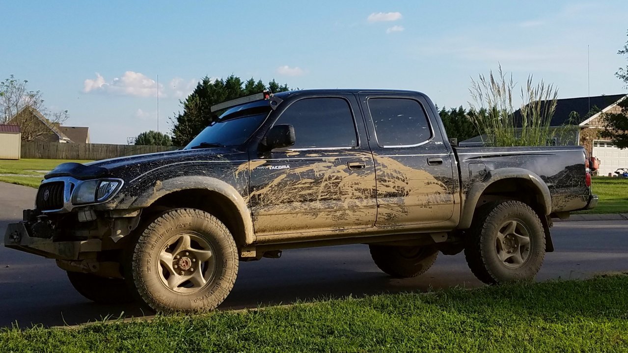

    Wondering if anyone else is having the same issue as me. Whenever I turn it on, the light comes back into the cab and blinds me. Seems that it's comes in, bounces off the dash then the windshield and back into my eyes.These 2 pics show where my light bar is mounted now but I've also had it mounted lower and further back with no luck. I've also pointed it up but the I end up with a light in the trees and not on the road/trail in front of me. Has anyone else had this issue and found a solution?

    solution would be to:
    1. Get it off the roof / windshield entirely
    2. mount it behind the grille
    3. use a bottom cover - basically its a piece of whatever which is mounted to I believe the brackets or the lightbar itself - it extends a little out from the bar and essentially prevents that level of light blinding into the cab. couple of people on here making these. you'll have to search. I looked but cant find the link.
    sidenote; looks like it needs to come up closer to the roof line. too far down the windshield.

    You probably have it angled down to far. I have no problem with mine
