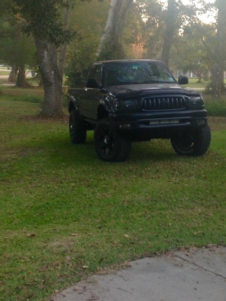

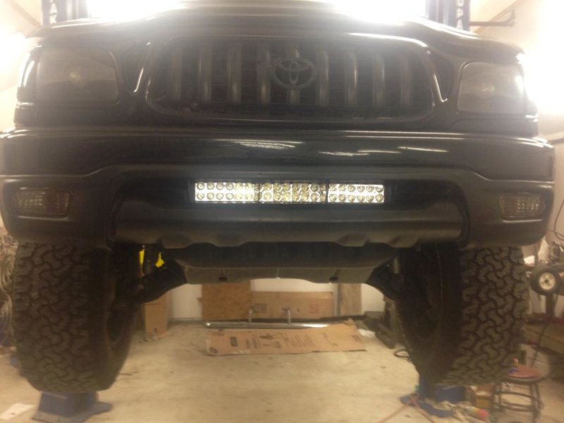

    This thing is super bright and looks really good it only took me about an hour to install. I have a welding machine which helps and I also have a car lift which is even more helpful. I didnt have to remove the bumper or anything I just used some angle iron and welded it onto the crush bar behind the lower grille.

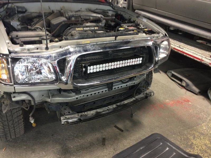

    Here is mine mounted behind the grille.
    12 inch light bar. Mounted with the BAMF mount. Wouldn't fit with a factory grille so had to make a flush satoshi. Used a GrillCraft insert. My chrome was peeling on my old grille so bought a new one from Rockauto for about $30. Also had to grind off some of the "cooling fins" on the back of the light bar itself, also ground off some of that middle support bar behind the grille on the truck, and had to cut off part of the BAMF mount..

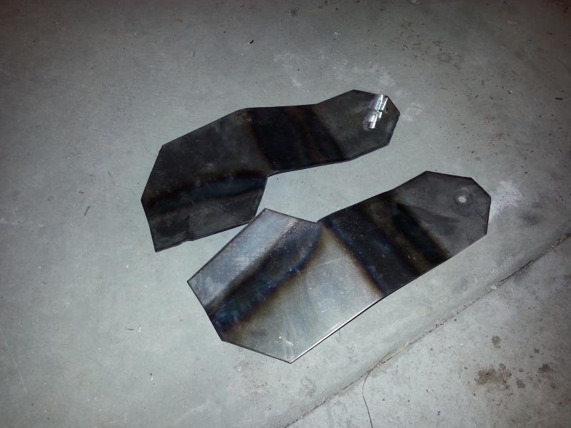

    Way ahead of you bro. The only way you can get mine out is from the bolt to the bracket that I used to mount it on and you know what I did???? I welded that bolt to the carbon steel bracket lol.

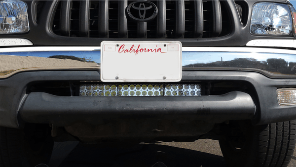

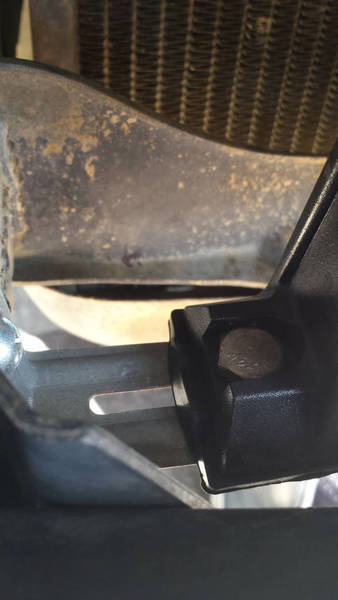

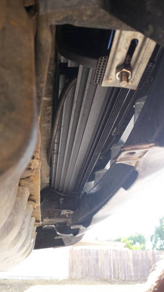

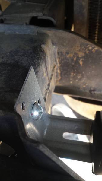

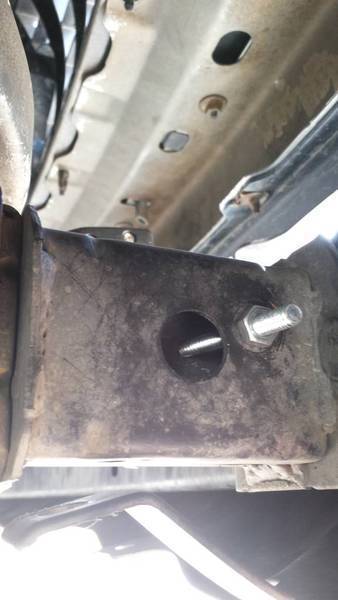

    I mounted mine behind the lower valence with a DIY method that has held up for almost 4 months already. It's just the light mounted up to some L brackets that are used for hanging curtains in a house or room, then we used two 1/4" bolts and drilled through the frame on each side and mounted the light to the L-brackets using the bolts that came with it.
