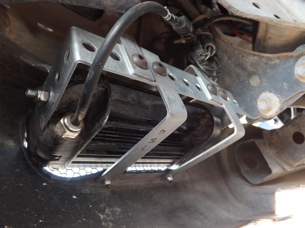

  14. Sep 6, 2015 at 4:56 PM
    #114
    NightProwler
    NightProwler Well-Known Member
    Nov 12, 2013
    #116470
    3,494
    Harlan
    Maricopa, Az
    '01 Prerunner, '16 trd4x4, '03 cbr954rr, '03 rc51
    Like I did with these here in the turn signal area:
  15. Sep 6, 2015 at 5:37 PM
    #115
    YotaOverAll
    YotaOverAll Backyard Performance
    Jul 9, 2012
    #82254
    14,700
    Jessie
    Panama City, FL
    02 Prerunner SR5
    3" Toytec spacers, Bilstein 5100s in the back with add a leaf and overloads removed.
    I wanna do that but with pods.
