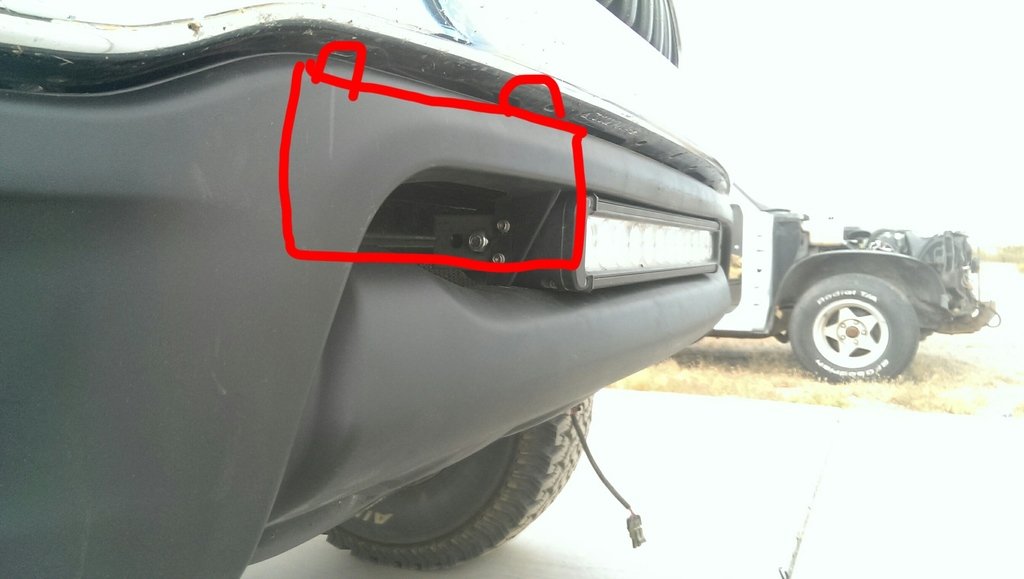

    That sucks. Idk man. Only way would be to relocate the plate. Maybe off to the side? Make a bracket of some sort with a couple little tabs and have those tabs stick out between the valence and bumper, fold them down, and mount the plate there. Idk.
    Edit: sorry for the crude photo but, something like this:
    IMAG1632_zpsxwhv6n4c_edit_1441861110291__d8f5e53a031bdcde7a32f30036746794fb35f4ed.jpg

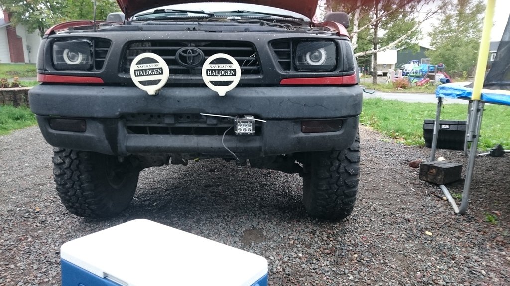

    Anybody with pods on the 95-97 front end? Thinking about putting them here.
    Jon G likes this.

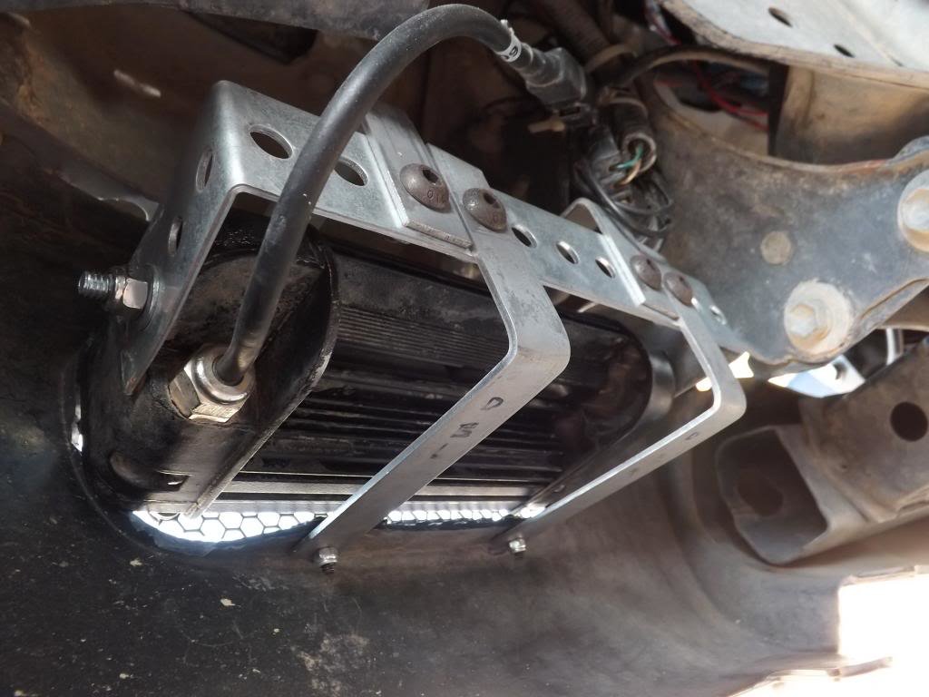

    How did u mount the led bars in the signal posts?what size are they?

    They were pretty hard to do. I've been meaning to do a write-up on them but haven't had time. I actually got in a front end wreck and had the lower plastic valence replaced, and just haven't reinstalled them in again since. When I do I'll be doing a write-up for sure. I basically cut out the turn signal box inside, left two tabs in the plastic top and bottom, and used multiple pieces of flat stock pieces to mount them in. As well as mesh inserts in front of them to fill it in. One day I'll get around to it. Not sure when. I kinda lost access to tools so I need to get some before I do this again. For now here's the only pic I have of the backside for reference. Took a lot of creativity. I have more pics of cutting out the box if you want them. But other than that, a full tutorial is really needed to do this properly.. they're a total bitch. especially the mesh inserts I used to fill it in. I had to get longer tiny Allen bolts for the front caps on the led bar, along with tiny washers for spacers, and assemble the bars to the mesh after the mesh was installed first.
    And they are 8" Cree clones of the vision x evo prime.

    What type of flat stock is that? I want to copy your plan. It is awesome. Thanks.

    Ha, shit I don't remember. It was whatever ace hardware had. Something galvanized I think.
    Just remember that the opening there only supports a single row bar like mine. Mine barely fit as is. If your want it to sit flush behind the opening, you might consider extending that bracket all the way back. Another Member copied it and said that when he extended his all the way back there was a spot to bolt the bracket to some other support that sits in front of the radiator, for extra support.
