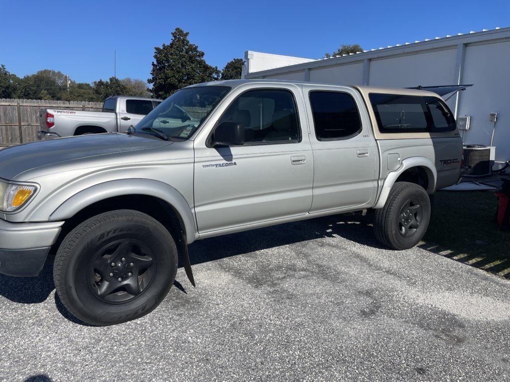

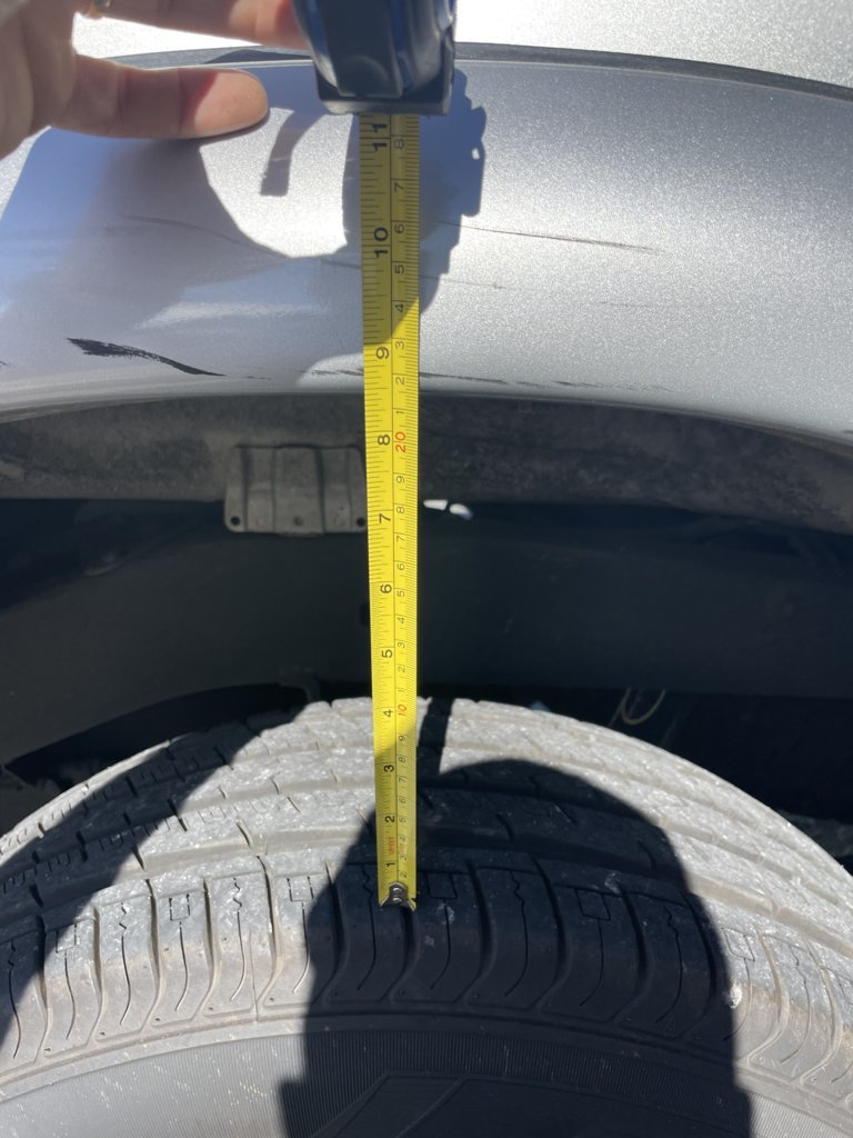

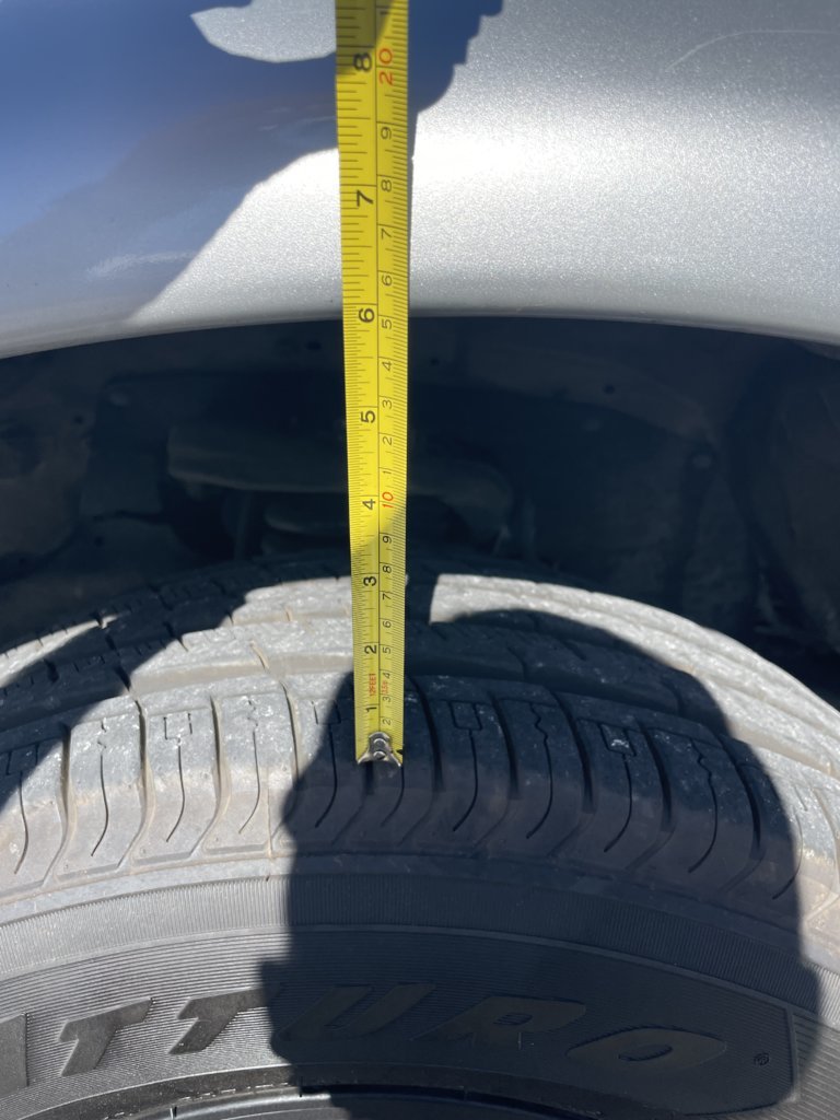

    I have an 04 double cab 4wd. I recently replaced all of the suspension with oems (or at least the stock size), including front coils. I replaced the rear leafs with general springs hds which have added elevation to the back. As I currently sit, the rear is about 2.5” higher than the front. No issues with driving but I would like it to be closer to level.
    I’m wondering if the standard leveling kits that can be found online to elevate it anywhere from 1-2” would work for appearance’s and function’s sake. I’m talking about the spacers like these: https://www.amazon.com/dp/B0BMZZB67F
    I know lots of people say the bilstein 5100s or thereabouts are the best solution. But since my suspension is new and works fine for me, I’d rather not. But I also don’t want to ruin any of my suspension components. I road drive 95% of the time. Very light off roading in sand or mud only to get to certain areas. Nothing serious.

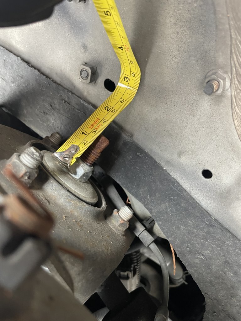

    I’m attaching photos in the comments to show the difference in the rear and front as well as the height I have on the studs of my springs.

    Differences in front and back, whole truck, stud length

    Normally one measures height from the center of the hub to the fender.
    If your suspension is indeed new, drive it around for a good 2,000 - 4,000 miles and allow the rear leaf pack to settle.
    I've installed several for other members and it normally takes a few months of driving until they settle another inch or so.

    thanks so much! I guess I need to make sure I have 2” extra on top of my current coil over strut before buying a 2” spacer to put on it, right? This was very helpful.

    negative. Spacer is placed above the top hat/mount
