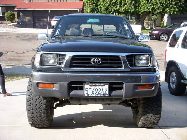

    04 4X4 Tacoma SR5
    3 in Ultimate ToyTec, set @ 2.5 in. AAL PINCH Weld Mod ( beat the pinch weld over inside the fender) Painted the pinch weld on bottom of cab Black Hi Lift Knock off
    Toytec Ultimate lift with 33s, 35s will be tough. I have some frame rub when I lock the steering to the left

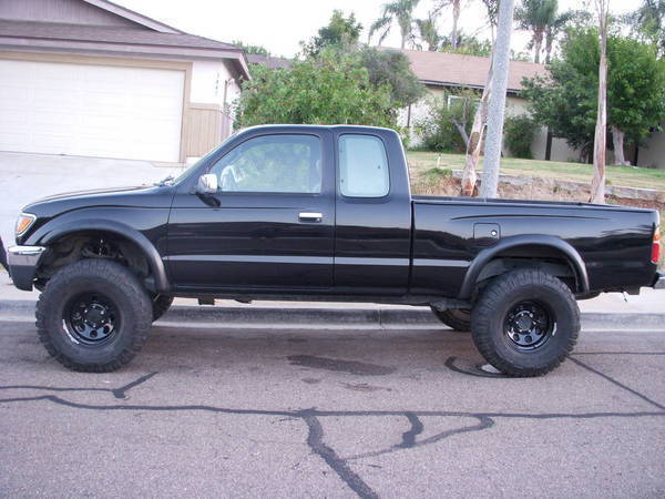

    2011 DCSB
    This is my 96 with OME coils, struts, rear shocks, and toytec AAL, resting on Goodyear 33x12.5x15s

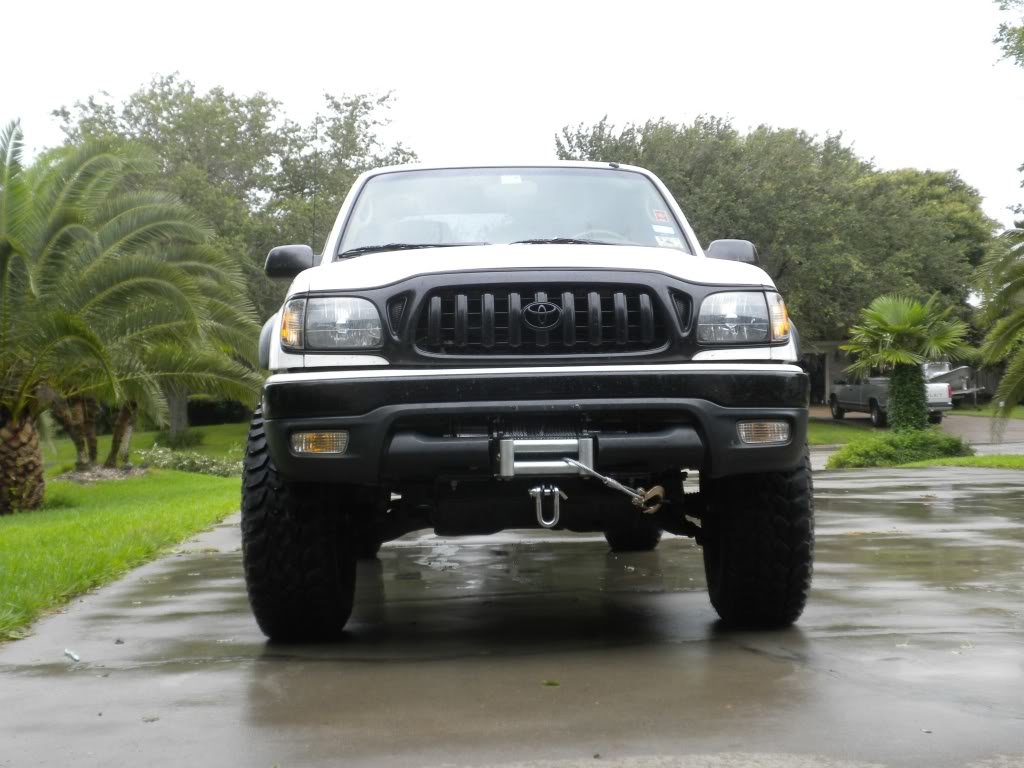

    04 midnight blue tacoma
    Ken's Roof Rack, 43"Led Light Bar, 16"Steel Rims, Dunlop Mud Tires 265/75, 2"Lift at front 1 1/2 at rear.

    Hey bro got more pics on how you fit the winch in stock bumper I like that

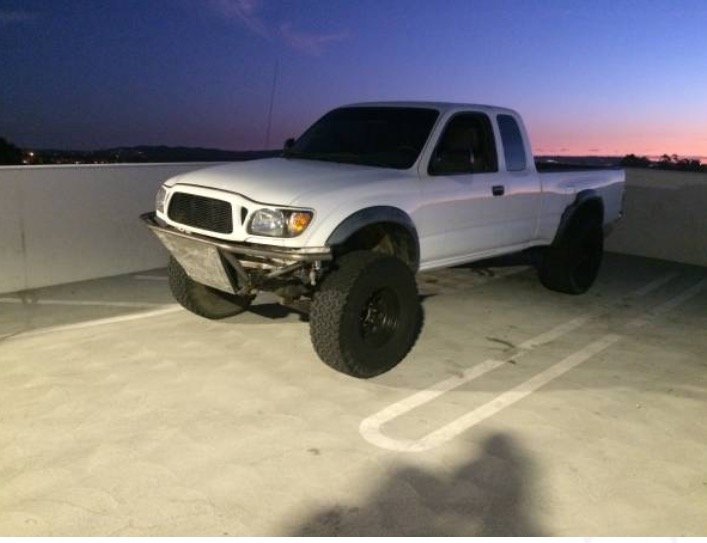

    03 White 3.4L V6
    Old thread but heres my 03 taco on 33's with 3in lift
