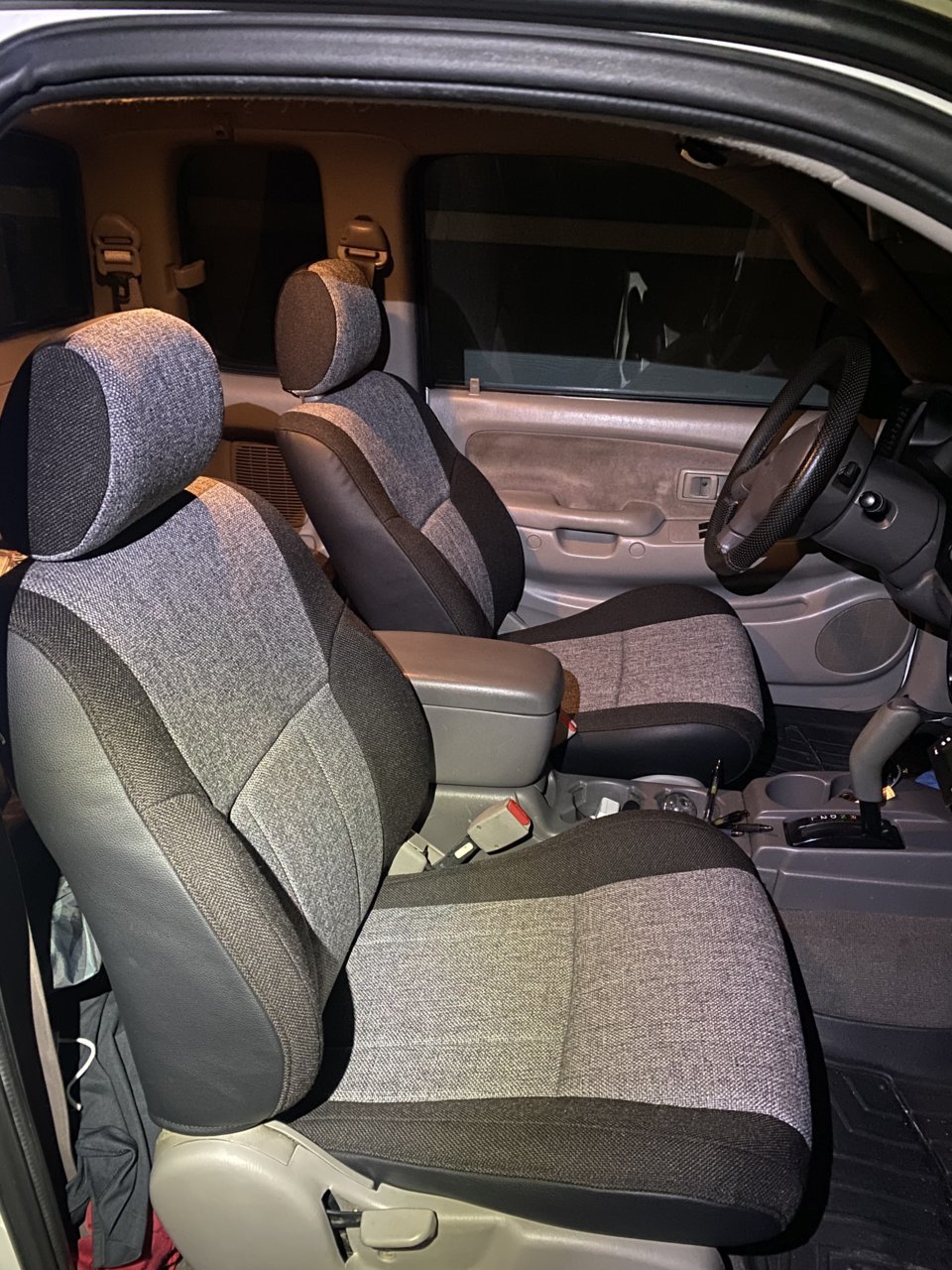

    Update. 4Runner cushion fits the limited seats. Reupholster turned out nice F4D5FCC7-0F59-4C70-9D73-BE9BFF0A367C.jpg

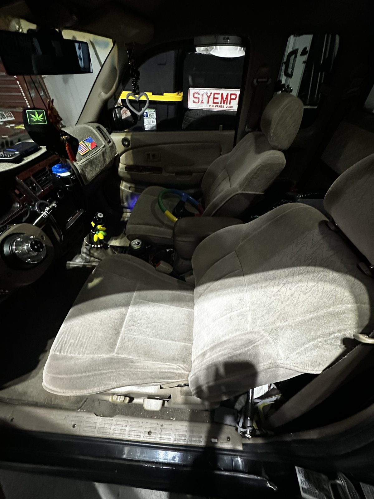

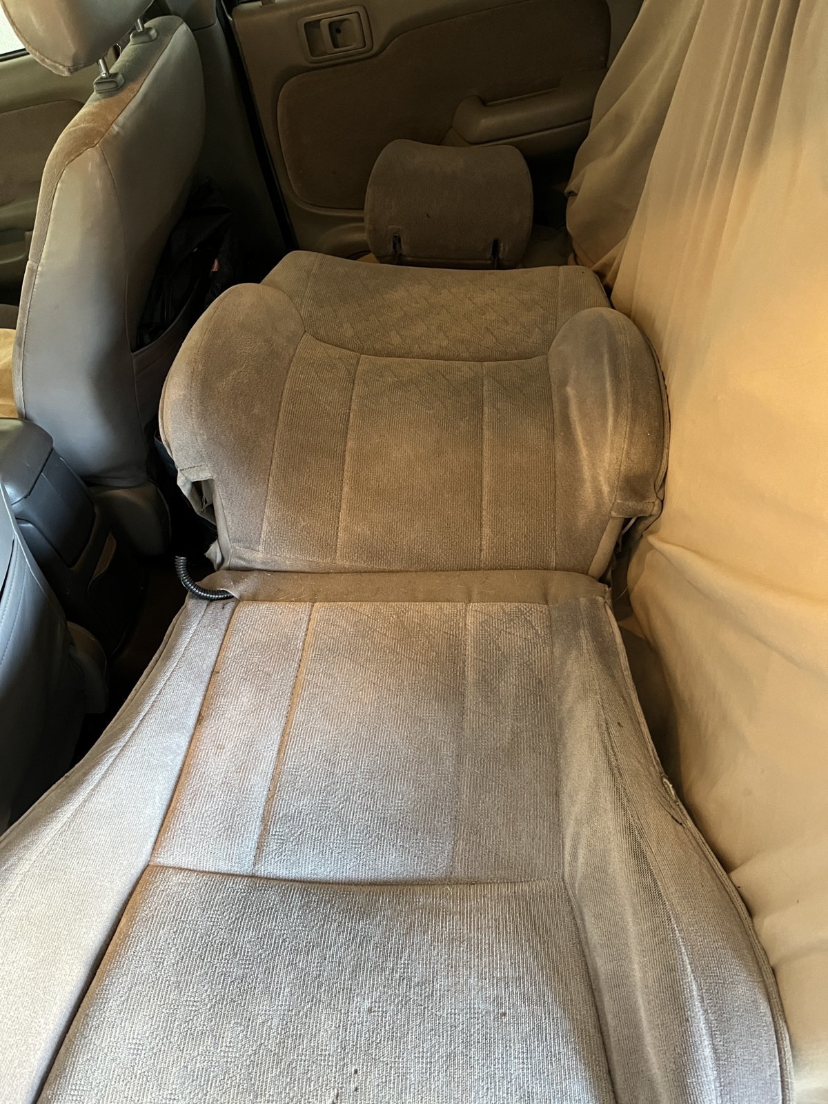

    Piggy backing off this thread. In my 15 year quest to find 1st gen Tacoma limited/sport seats I was gifted upper and lower limited/sport cushions for the driver's side seat. The guy who gave them to me has a 1st gen limited double cab that was rear ended so hard it torqued the seat brackets. So he got a limited seat and removed the brackets/rails to use for his brown interior... leaving the gray interior cushions. Which I just grabbed.
    Does anyone know if I can simply take my current regular seat apart and plug n play bolt these cushions into it?

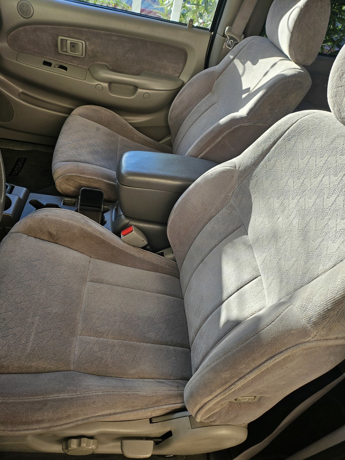

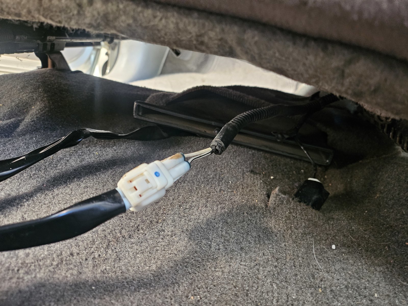

    Finally got
    So finally got a chance to install my seats and I can confirm they are in fact plug and play, according to my 01 double cab pre runner. The plug itself is hidden underneath the driver seat air vent. I simple swapped out the seats and plugged in the seat belt and lumbar plugs and that was it. Lumbar works perfectly and feels great. 20240221_164001.jpg 20240221_163945.jpg

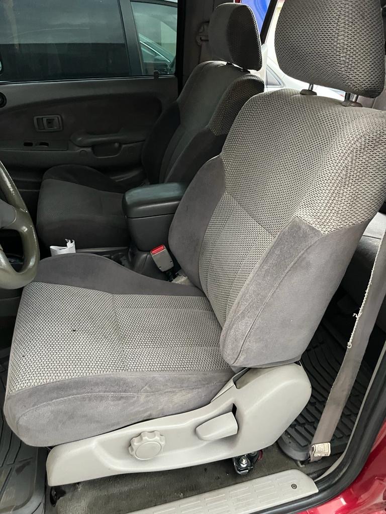

    Got my from a 02 4 runner limited sport paid $150 the guy didn’t know what he was holding too … d2371cc9-8652-4597-beb5-778da7371735.jpg 46f5bcbf-f423-4fee-9231-a2e66571949a.jpg
