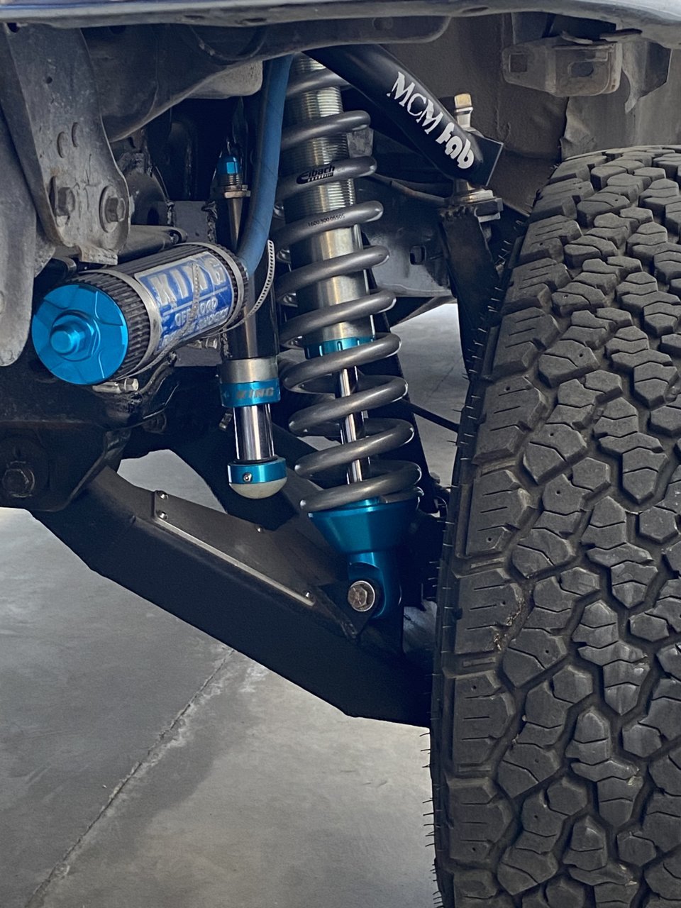

    Are you running a standard universal 8" coiler from king? looking at getting an MCM kit and would like to stick with king VS ADS. the compressed length of the ADS shock is 1" shorter than the king so curious if you modified your coil mount. thanks!

    Hey, well i stayed with king because i get them with a nice discount but yes they are a tad longer and that will affect your up travel drastically, so i thought about cutting the upper mount but that will be too much work and not into that big of a change right now, had quoted ads coilovers and seriously thinking about switching but i am wanting to go sas so still not sure
    Contact jd fab, heard they get the short kings

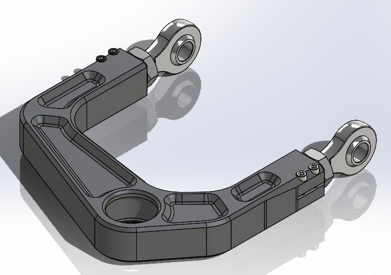

    Here's the UCA I designed for the kit that I might make. Haven't yet started designing the lower.

    that looks great!
    I did all weldment since I have a CNC Plasma.
    The only catch with the 2nd gen axles is that they have different splines.
    This led me to investigate a whole subframe swap/custom subframe, front steer spindles, 8 in diff, plus LBJ in compression!! but I never continued this path of investigation out of laziness and I needed to go closer to 3.5" to work with the cheaply available raptor shocks, I still think of this sometimes, specifically for front steer and LBJ... but not actively doing anything.
