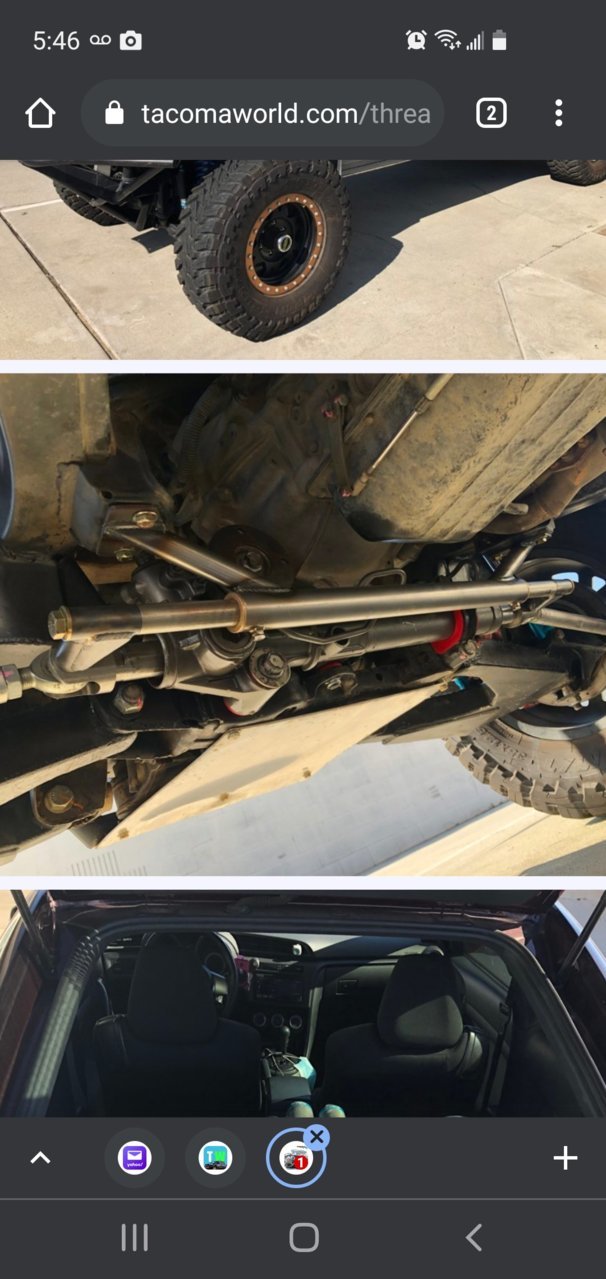

    What is this bolted to?
  13. Jan 19, 2022 at 12:28 PM
    #33
    Jon64l
    Jon64l Well-Known Member
    Jan 12, 2016
    #174799
    1,633
    Jon
    2000 4runner, 1996 Tacoma
    This tube..
    Tube slides in bronze bushings.
    2004Taco likes this.

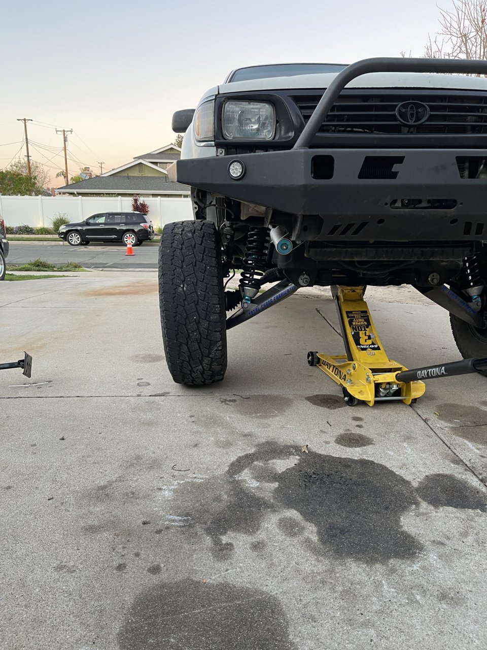

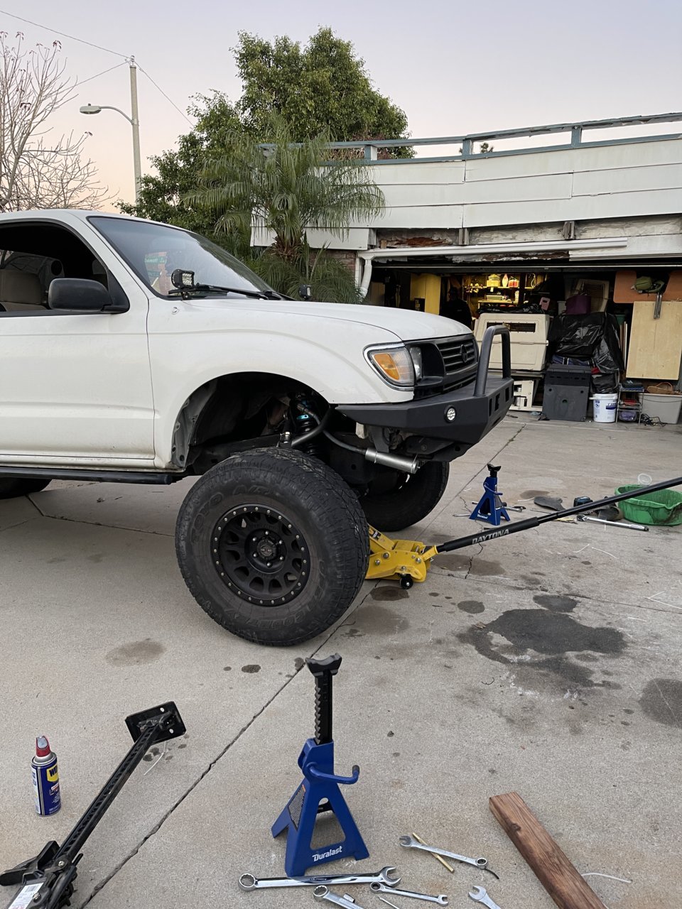

    Alignment is off steering wheel aint straight lol but it’s done. Alignment next

    Ratchet strap the steering wheel to the seat and keep it centered. if you have an angle finder you can measure your camber referenced off the side of the frame to the rotor with the wheel off and the coilover out and the arms at approximately ride height. Turn your alignment cams until you get the tires pushed as far forward as you can while keeping the angle finder at 0. On my trucks it’s usually rears all the way in and fronts all the way out or at least center. Then even out your tie rods. You can almost get your steering in spec this way with the toe at that point:

    I was just gonna get an alignment I don’t really have the time to do the alignment myself

    At least match your cam bolts side to side and then center your steering wheel and even out the threads on your tie rods. Lots of alignment shops will leave you without adjustment if it’s way off when you bring it in. You can fix it afterwards but they have your money.

    How do I change the cams?
