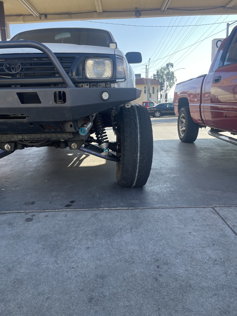

    Shop said they couldn’t pull the tire in more for toe they said if they pulled it in more the steering extension would come out

    On both sides or one? That's important.
  4. Jan 25, 2022 at 4:42 PM
    #44
    Allex95
    Allex95 Well-Known Member
    Apr 6, 2020
    #324011
    1,380
    allex
    96 Tacoma 4x4 2.7l 4 cylinder
    One. I found a shop that can do it tho
  5. Jan 25, 2022 at 4:59 PM
    #45
    Dalandser
    Dalandser [OP] ¡Me Gustan Las Tacos-mas!
    Feb 19, 2015
    #149090
    17,635
    Anthony
    Downey
    08 PreRunner Regular Cab / 98 4x4 Extra Cab
    Empty Wallet Mod
    If you pop out your tie rods from the ball joints and make sure your rack is centered (spin it from lock to lock and count the turns and divide by two to find how many to turn and have the wheel and rack be centered) and spin your tie rods until they go into the ball joints with equal threads showing on both sides abs the wheels relatively straight (0* toe) you’ll be good for any alignment shop to do it. Here’s more info:

    Idk how my steering wheel isn’t even I mean I had it straight when taking everything off

    It'll move when you pull on the tie rods - you always have to tie it to the seat when removing the steering from the spindles / lower ball joints.

    Will the alignment shop be able to square it or do I have too? I’m going in tomorrow for one

    Depends on how much they're willing to do or know how to do. Sounds like your steering is way off to one side.

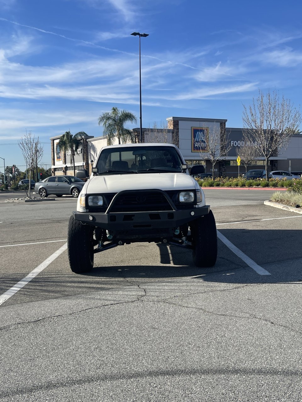

    Alignment done ! Both pictures with alignment finished

    Nice, glad the second shop could get you back in spec!
