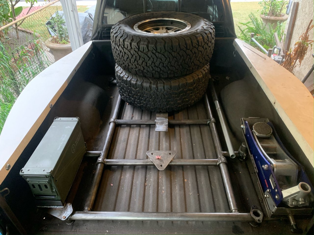

    By now with all the newer trucks out there to maintain products in high volume for, and with low volume of our trucks being built now-a-days and the attention paid to them proportionately less also, none. I've had AFC 6" fenders which fit nicely on the door and hood lines, but were nowhere close to fitting factory mounting holes under the headlights. I ended up making mounts for them anyway since the tiny fasteners really aren't much holding them on if they lined up either way.
    I have a 68" wide axle so the only thing wide enough was Fiberwerx 8" bedsides. The first picture shows how poor they fit behind the cab on the passenger side. The driver's side is perfect.
    Tail light fitment was ok, nothing to write home about though.
    Highly recommend making some of these mounts that mount to the bed where the factory mounts are.
    If you're looking to strengthen your bedsides, by drilling out the spot welds, I was able to fit a piece of 1x1 square tube with some nuts welded in to mount my bedsides.
    The best way to preserve your bedsides imo is to mount things from the frame though. Here's where I drilled out the 6 factory frame mounting points for the bed to accept 1/2" grade 8 bolts to build off.
