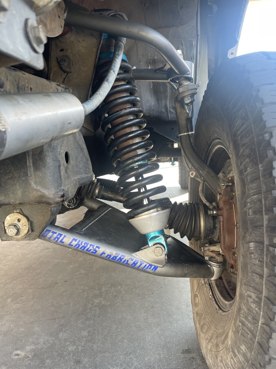

    I’m on 500lbs looking to go 600lb
    Here’s a video with 500 btw I have no bumps so. Getting some now but was in a rush for koh
    https://youtu.be/n2Mx66h0Zto

    Definitely blowing through the travel easily. Bumpstops are a necessity but valving for more compression will also help on that.
    EDIT:
    With the rubbing spring - did that appear before this trip? In order to fix that problem you'll at least need to remove the coil spring (if it's a bowing spring) or replace the shaft (if it's a bent shaft) so opening them up and measuring the shims with a micrometer will be good to help you improve the valving in them.
    https://www.youtube.com/watch?v=CRaOceJt12U
    You can follow this to measure the shims, don't just remove them like the guy in the video though:
    https://www.youtube.com/watch?v=ML2b7THsdRk

    I mean the shocks seem to have plently of compression when I tried pushing down on them without the coils.

    You're not a 4600 lb truck
    Most of what you're feeling is gas. Definitely see what they have in them.

    Look at the video links I edited into one of my posts. Fixing that coil rub issue will require you to at least remove the coils. If you do that, then it's not hard to rebuild the coilover. You can buy the seals here:
    https://www.shockseals.com/collections/king-2-5-seal-kits

    You really thing it needs more compression? Could changing the coil be a better option first before that?

    Absolutely - springs are primarily to give you lift and operate to keep the vehicle supported. If you have the proper ride height without binding or letting the spring go slack completely, you only have a small range of spring rates that work. But I'll default to what @AccuTune Offroad might have to say here.
