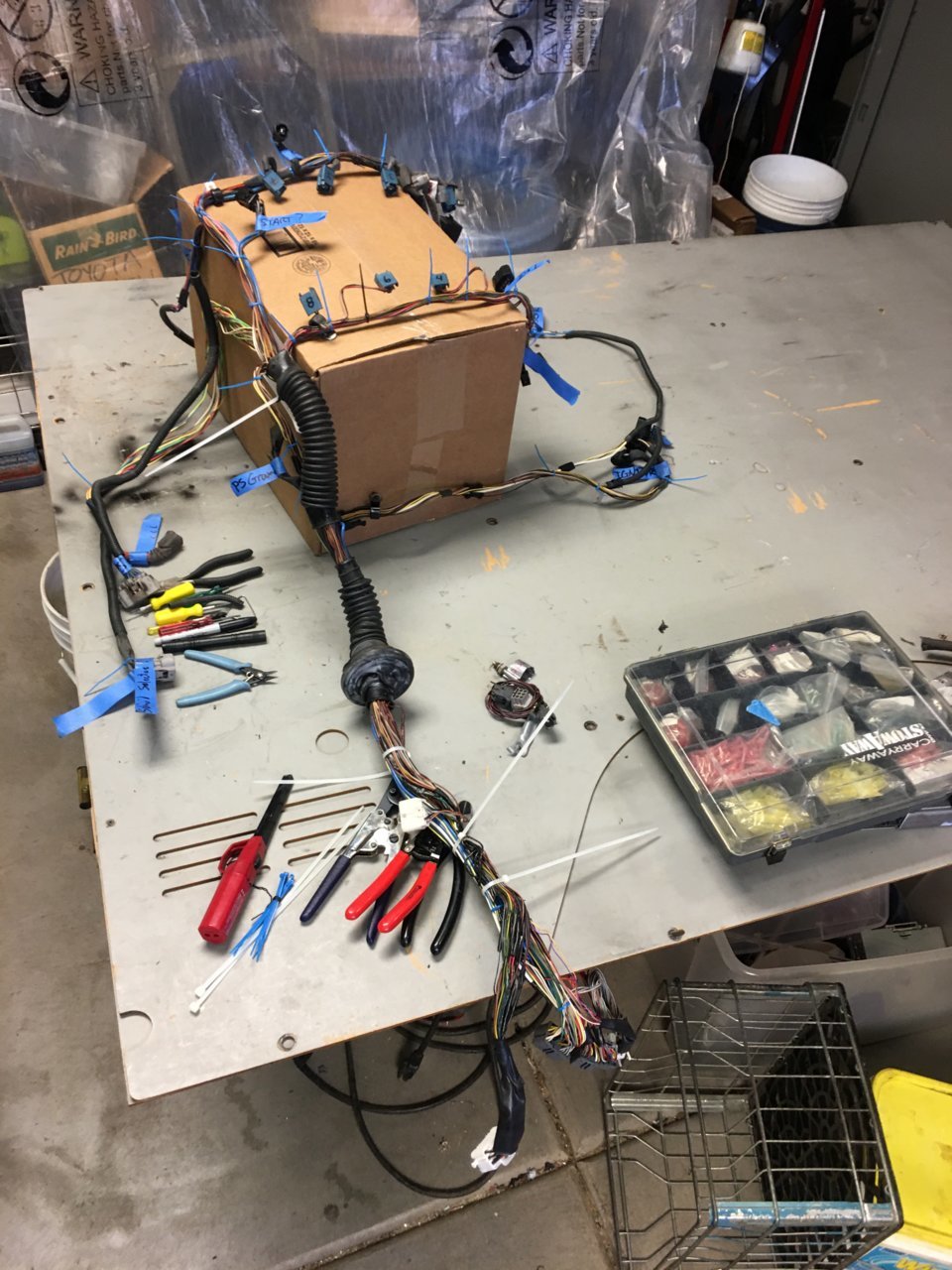

    The plan = 1UZ swap, TC long travel, Sequioa SUA
    Thanks @cbechtold ,
    I am knee deep in 1UZ wiring for the engine swap on my 93 Pickup. Then the suspension fun begins and this axle is leading my list of good options for the build. Light, cheap, disc brakes, bolt pattern and width will match the front TC kit.

    Sounds like a fun project! 1UZ is gonna rip in a truck that light!
