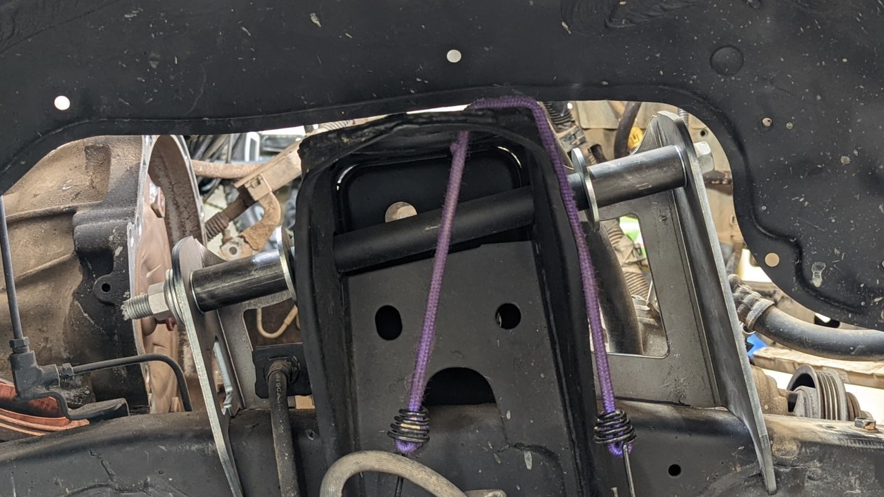

    Seems like that's what you need - if you're putting it through the front IDK what might be in the way, but it won't go in from the rear - I put my oem bolt in from the rear and it just made it with a 1/8 gusset.

    Same diameter bolt?

    Yessir. I order a pair since they're cheaper. Will report back with findings.

    I was thinking of fabbing some tabs in order to keep the bolt in place in case the nut came loose

    The gusset this guy welded in should be good - the sleeve is almost .120 wall.
    This is probably one of the beefiest built part of the truck. Unfortunately I failed to realize I had a 1.75 .120 wall tube where this bolt had to go so the whole coil bucket will get replaced with new uca mounts. haha

    Oof - I retract that statement, the sides of the coil bucket are beefy - they obviously needed more material handling the load on the top of that

    At least it failed above the UCA bolt. That would have sucked. lol

    Can confirm the 2nd gen UCA bolt works for the 1st gens. It's a little bit long, so I definitely recommend some thick washers on both ends to prevent bottoming out on the threads.
    Part numbers for the bolt and nut are 90105-A0095 and 90080-17208.
