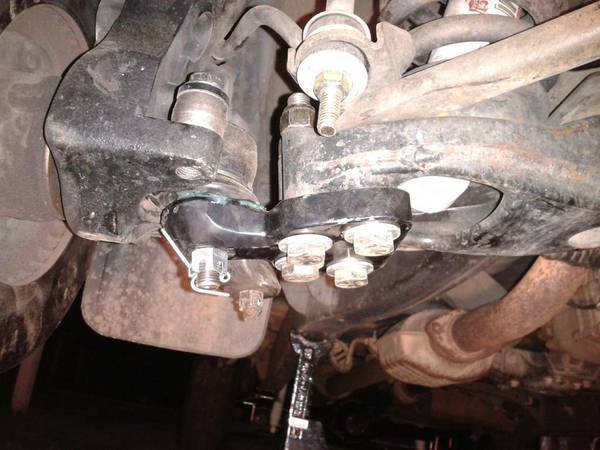

    ok guys so ive gotten a few pms regarding my lower ball joint brackets. i can build more if theres enough interest. heres some pics of the ones i made.
    they are made of cold rolled flat bar,much stronger than the cast factory ones. i have beat on my truck and have not even tweaked them. i bent the uca cross shaft and possibly the coil buckets and they are still going strong. for it to be worth my time it would need to be at least 3 sets. materials alone for each set is about 80 dollars plus my time to make them cost will be about 200 maybe less (im gonna look into getting them cut by a shop) these took me a super long time to make so i think its a pretty fair price. my set with cutting and drilling and grinding was about 6 hours.(more or less cuz i did them in my free time with a grinder lol) let me know what you goys think and if youd be up for a set. so far i have one for sure. buyer will pay shipping to them if not local to me.

    Dont have a template i used the factory one as the template

    These are for 5 lugs

    cost will be 200. half of which is material alone

    I can probably make this in the welding shop I work at. I've been creeping for awhile piling up some stuff I want to make for my 5lug. I unfortunately don't have a spare LBJ to pull dimensions but I'll be doing my spindle install soon and will most likely just pull dimensions then.

    Is there still interest in these? I found my old drawings to make this part. Going to make one set over Xmas break
