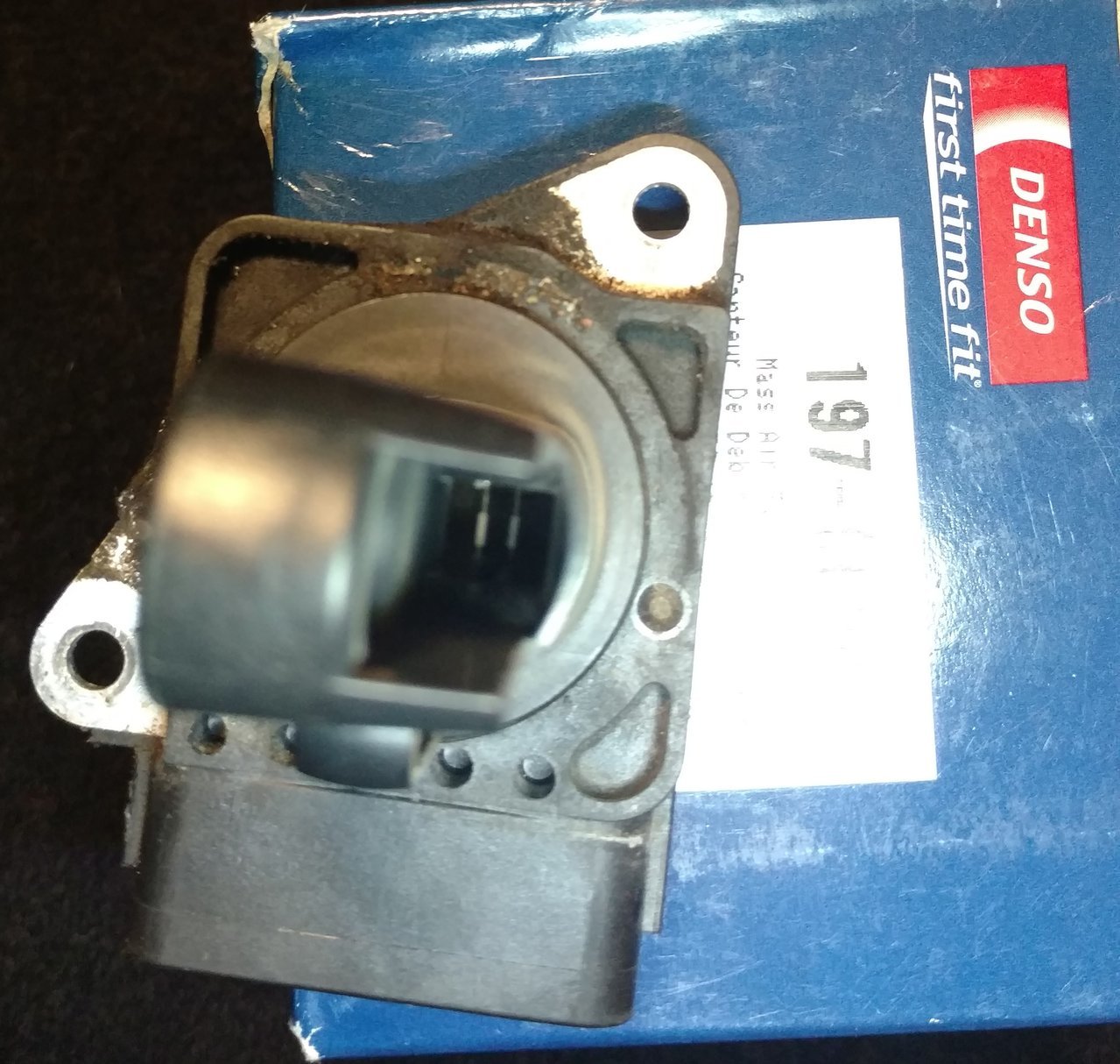

    For posterity, here are the two tiny wires that need to be cleaned in a MAF. This sensor, AFAIK, 300K miles on it... which is why I decided to put a new one in for PM. The new one will be cleaned every time the air filter is cleaned or replaced.

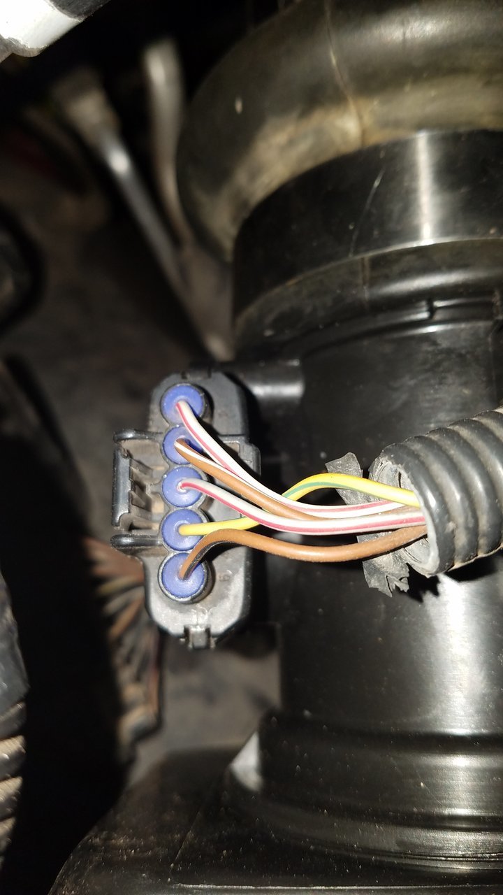

    Update: Truck is running great, but my mileage went WAY down! I have been searching through wiring diagrams and illustrations trying to figure out if I have the wires correct. No luck so far. Toyota changed colors on wires more than they needed to, ugh.
    My current wiring configuration.

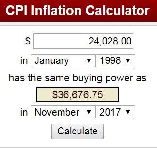

    One thing that everyone forgets a lot is inflation. Depending on how long ago these prices were made up, they could have just recently adjusted for it.
    It gets even more pronounced when you look at the truck as a whole... according to the internet, my Tacoma (V6 Extracab 4WD 'Limited', which I think means the TRD package) was $24,028 MSRP when new. $36k... why, that's about the price of a brand new TRD OR.
