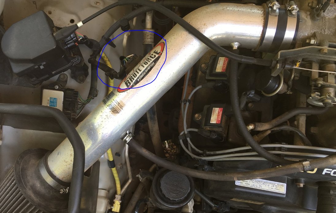

    Thanks :) ... I looked all around for that connector, didn't see it there... I think I'll go
    out and look at it in real life now...
    -Mike
