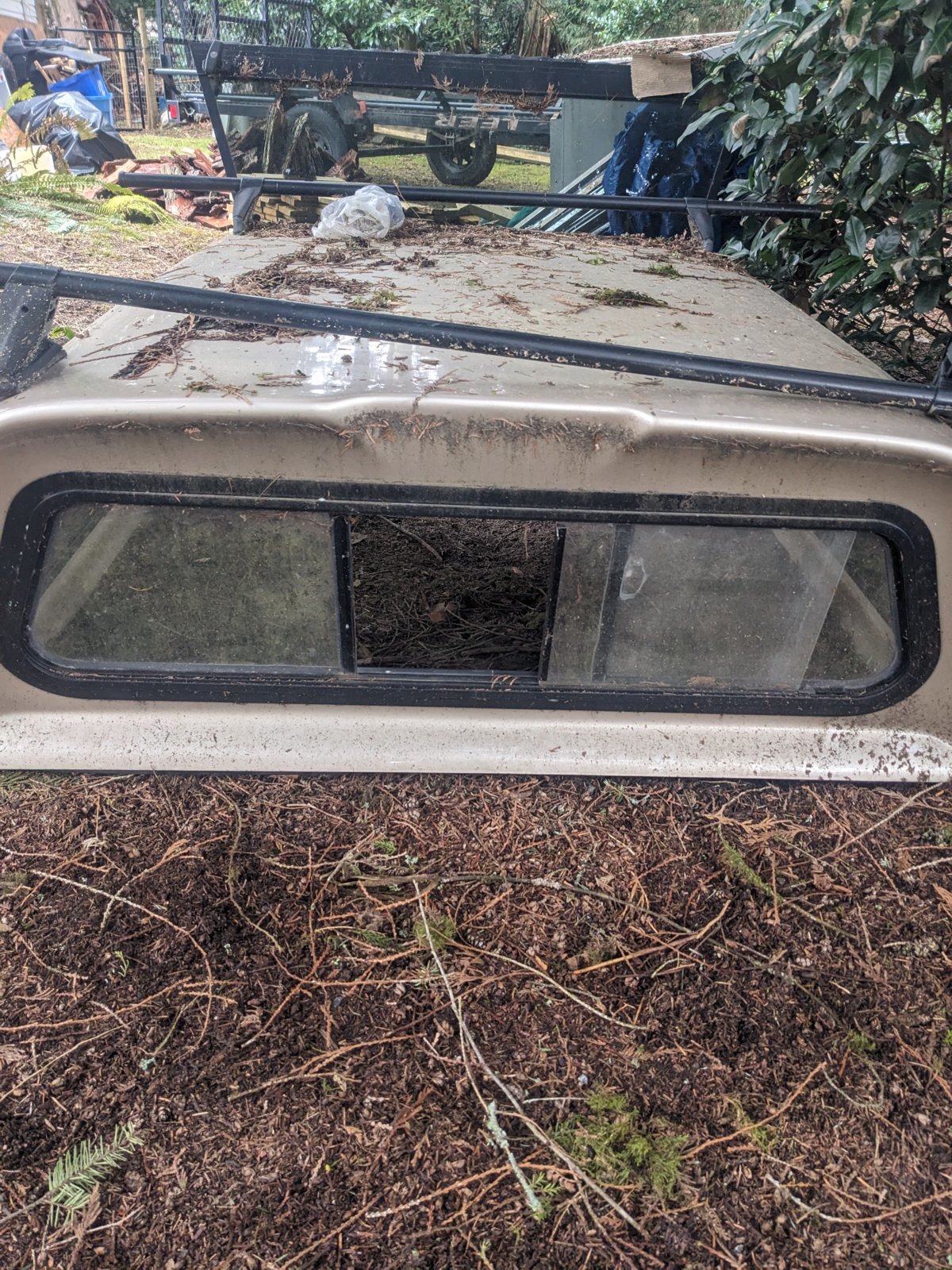

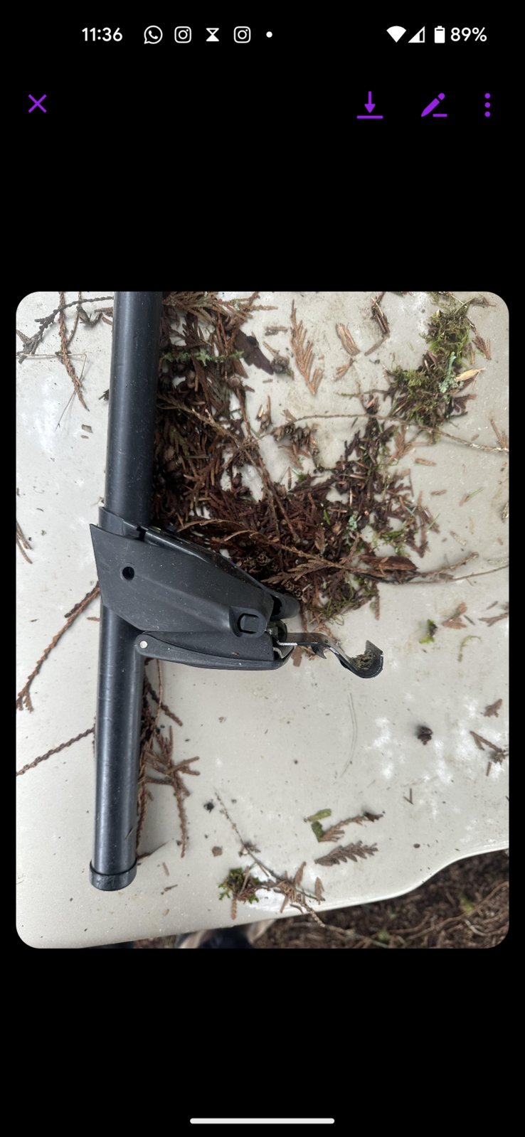

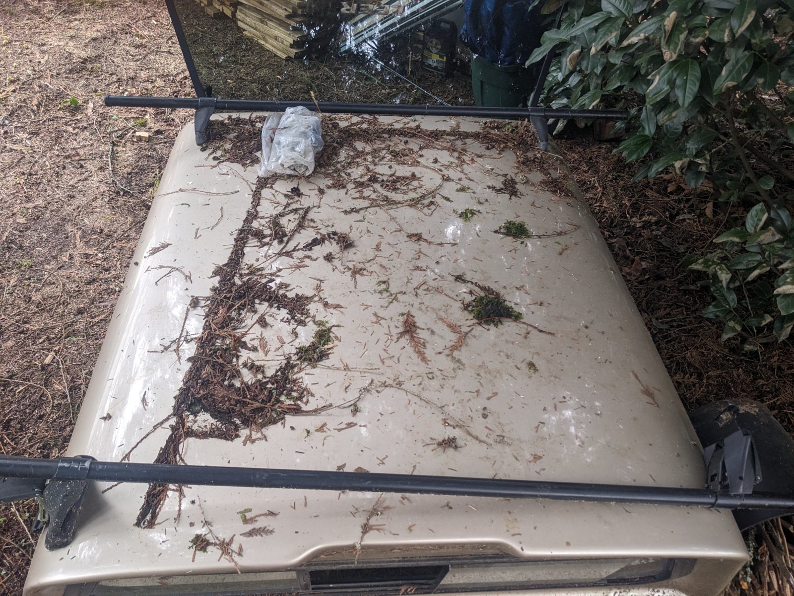

    Hello I'm looking for some advice on anyone who's mounted a rooftop tent to a canopy on their first Gen Tacoma.
    Currently have it mounted on a bed rack but buying a canopy next weekend.

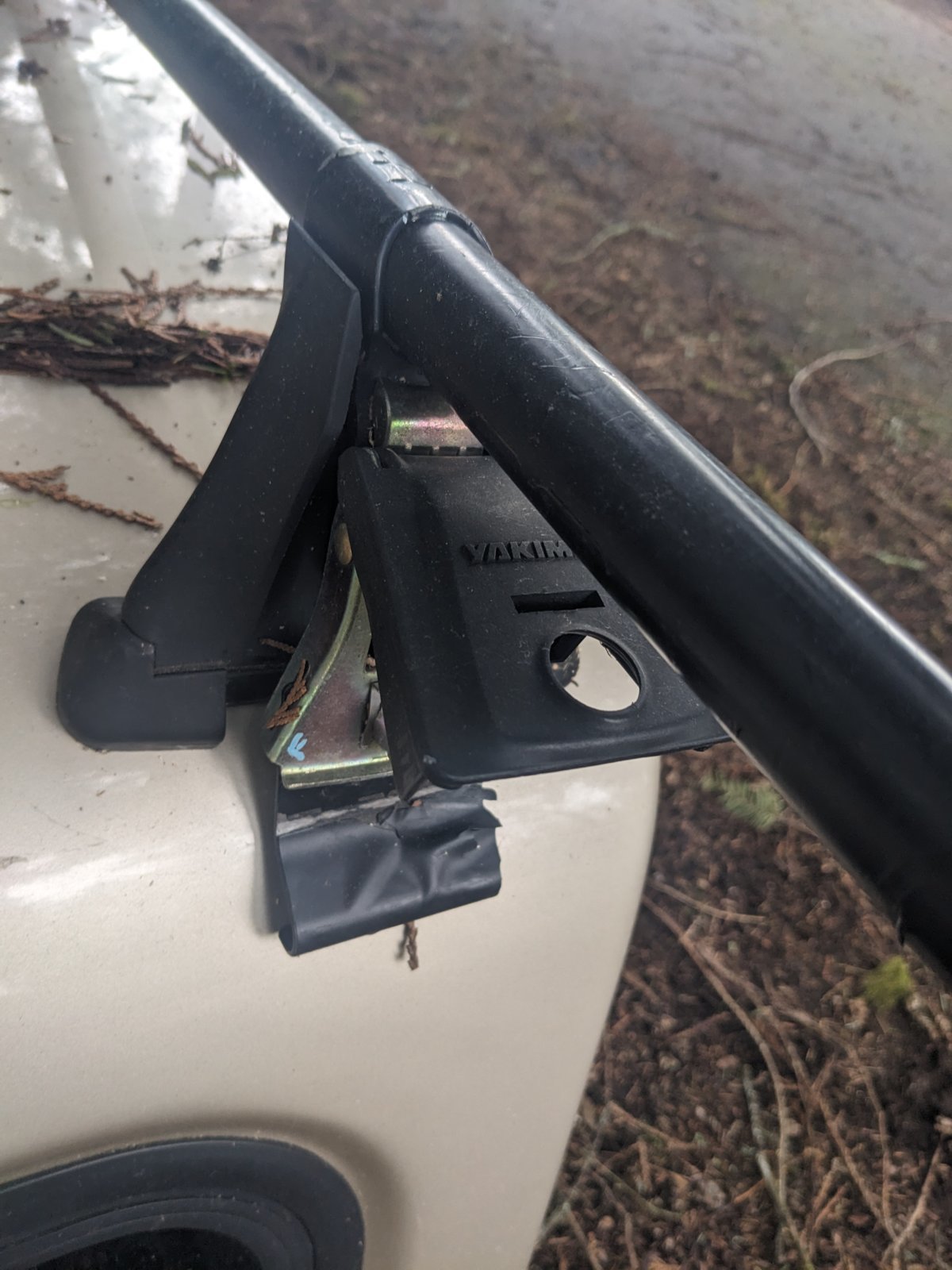

    The canopy has an older yakima rack with rounder crossbars and only 1 installed. I'll need to install the 2nd rack.
    Will the rack/mounting area on the canopy be strong enough for my 2 person tent? I don't know the model of the rack to check the load rating.
    Also will there be an issue trying to mount the tent on these rounder cross bars vs my current flat rectangular bed rack. Will it be secure enough?
    Any info is appreciated.

    Yakima Q towers are usually good for 200lbs of static weight, but I doubt the canopy roof is made for that much.

    You can get tracks and load bars from a few places. Front Runner has them at a decent price, I have a tray of theirs on mine. The tracks are the same whether you get bars or a tray, and they're straightforward to install, just measure (twice) and drill holes, bolt them in and mount up the feet and bars.
    Like @Speedytech7 said, the weight is the issue. I wouldn't put a tent on mine personally. It's a stock canopy from ARE. Furthest I've gone is to stand on mine to take photos with a tripod, but I didn't even like doing that. If I were going to be doing an RTT I'd want a reinforced or heavier duty canopy. Just my 2¢.
