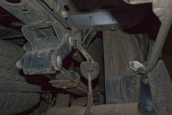

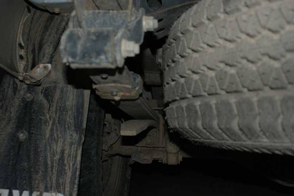

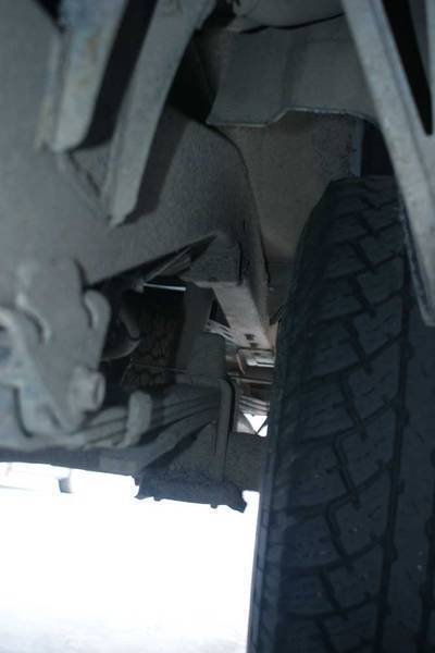

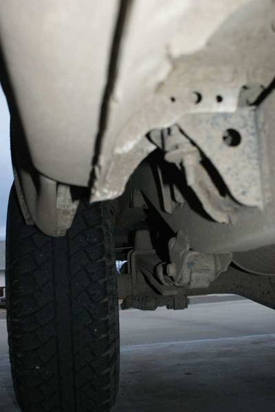

    Just got done crawling around under the truck - damn! That concrete floor is cold! NOTE: I do still have my sandbags in the bed...240lbs shouldn't have this effect though, IMO.
    Drivers side looking towards the back. The angle is a little deceiving, but the forward half of the leaf does arch down...
    Drivers side from the rear, just about horizontal...
    Same on the passenger side...
    And another...

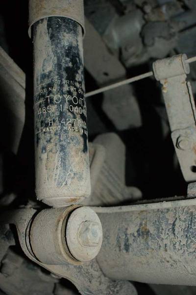

    I'm betting that's original...should I keep them for sentimental value?
    So, AAL or new leaf packs?

    Worse than mine, which has a 200-lb cap on it. I have heard that once they go negative arch, it is too late for AAL, but someone else with more authority/experience should share...

    you definitly would benefit more from a new leaf pack with that kind of sag and some new shocks for sure. do your truck a favor. an aal is more for the lift factor with leaf packs that arent sagging to bad. an aal on your truck would just make the ride rougher
