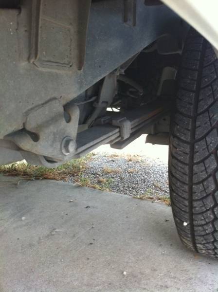

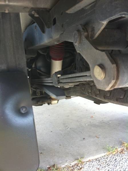

    Thats how mine looked. You might get away with an AAL but The new leaf pack is the way to go IMO.

    That picture is with my shell on too. I know a new leaf pack is best, but the college student budget is telling me AAL :D

    Ditto - AAL will only buy you some time, not really fix the issue(s). You'd be better off investing in a new pack.

    if you have to go w/ an AAL get a 3 lead add pack... wheelers and deaver have them
