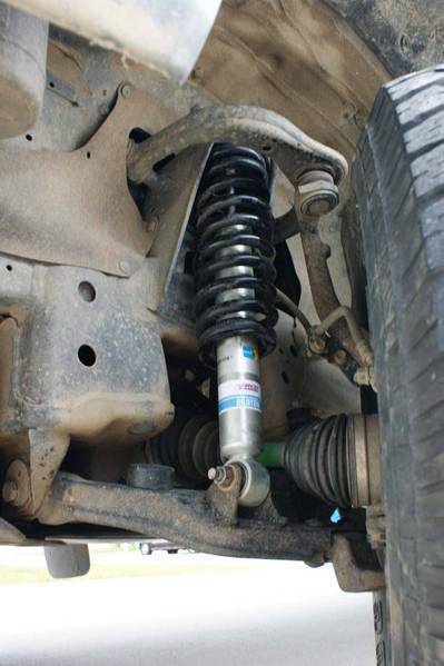

    So once again, a before and after and after comparison...
    And how the front end looks..yeah! My CV joints aren't riding at a 45 degree angle any more!

    Looks Good MT. How do you like the 881's you got? I might be buying the exact same set-up you just got. Just trying to figure out what coils to get.

    So far so good.
    I would say highway handling is the greatest improvement so far - curves were a little scary before, too much lean. And the steering is much more responsive (new sway bar & steering rack bushings).
    Offroad, well, improved but I haven't been out since getting the front adjusted so it was a bit rough. Can't wait to see the difference the whole set up will make now that its done right.
    Added bonuses, no more axle wrap (main reason for going with a 5pack leaf set) and I don't think I'm going to need ramps to do oil changes anymore. One less step to worry about there.

    That looks great! So its the 881's up front, 5100's set to 0" and for the rear the wheeler's 5 leaf pack with 5100's? This is the exact setup I am purchasing in about 2 weeks, except that I'm doing the OME shocks front and rear, thanks for sharing.

    In the last pic yes. Got a few hidden extras in there too, bushings etc. Figured as long as things were getting torn apart why not go all out!
    Haven't taken any measurements since getting the front adjusted...I should do that soon.

    Updated front end measurements are as follows:
    door sill 22.5"
    top of fenders/wheel wells 37.5" drivers side and 37.75" passenger.
    Backend hasn't settled at all yet, I was sort of expecting a slight drop right away.
    So I gained 2" up front and 2.25" in the rear. not bad!
