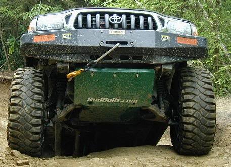

    Hi brother, I don't want to come off as talking about my opinion because, well, I'm an armor company that sells what you are asking about, which means I'm biased and real customers opinions are what truly matters.
    We recently got back on the forums, and I've been looking at some old threads and realized that was some misinformation about our 1st gen Tacoma skid plates. I hope you don't mind me just clarifying our skids for the group in this current thread?

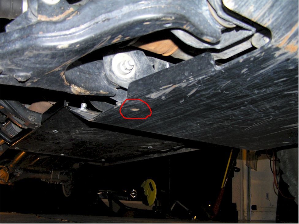

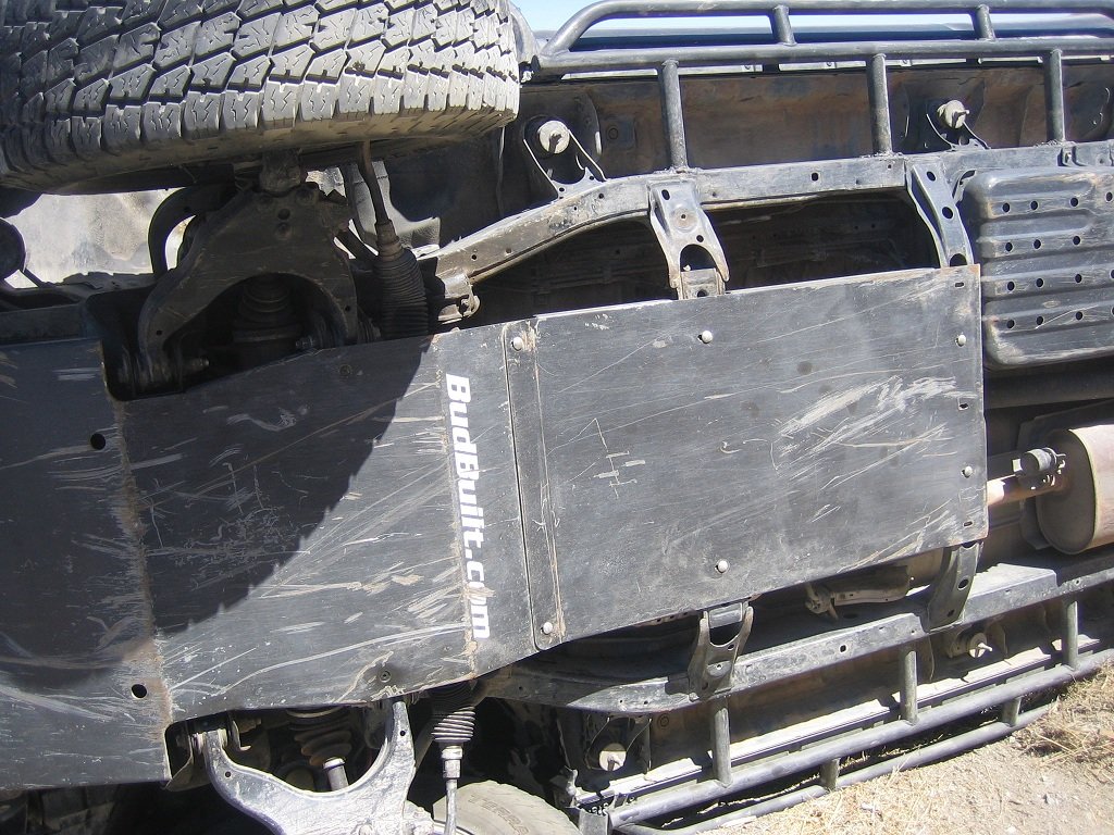

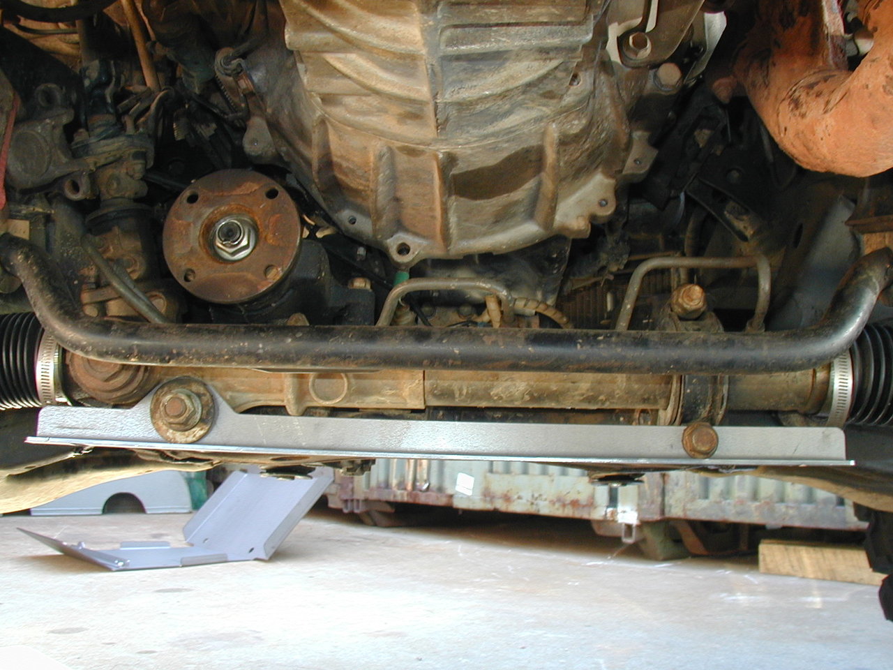

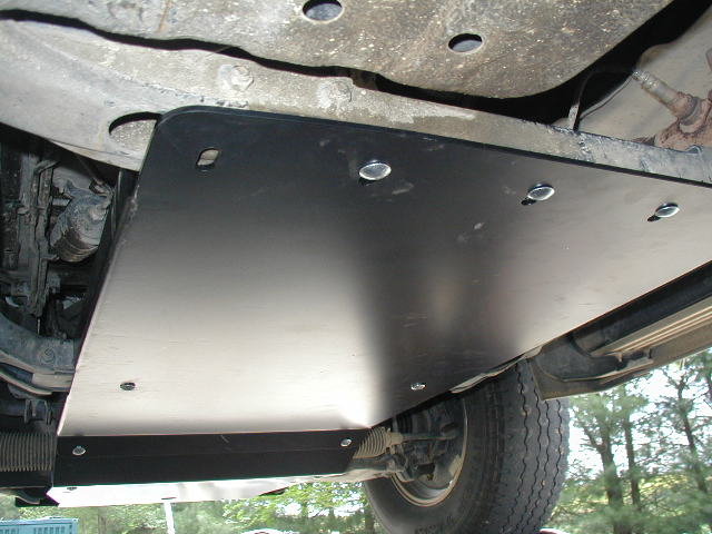

    The BudBuilt 95.5-04 Tacoma front skid plate mounts to the front crossmember, the engine crossmember, and the steering rack mounting bolts. It's looks like our skid doesn't attach to the engine crossmember in pictures because we run the plate right up against the frame, for maximum strength across a wide surface area. Because we use 3 axis multi angle laser cutting, that area has angled, beveled holes for using carriage bolts. That provides a smooth bottom, with maximum ground clearance, and multiple attachment points.
    We then usilize the incredibly strong steering rack bolt to furth lock the plate on the frame.
    That is what I think people got confused on earlier. Thinking we didn't have recessed bolt heads or engine crossmember attachment points.
    Further we laser cut an engine drain hole that will allow easy routine maintenance, but is as small as fictionally possible to not let rocks catch the plate and hang you up. We also don't cut out logo in any skid plate, the strength of our plate for your truck is more important than advertising for us. We construct out of 3/16" steel or stainless steel, 1/4" aluminum, or 1/8" lite steel (overland style)
    Installation guide:
    http://budbuilt.com/95-04-Tacoma-Front-IFS-skidplate-bellypan_b_5.html
    Please don't buy BudBuilt because of this, it was just to clarify the "recesses bolt head" and mounting system design that was described incorrectly on an other thread from a few years ago.
    If people recommend us, great, if they don't, we'll redesign. As long as your motor is protected, that's all that really matters.
    The passenger side engine crossmember attachment looks bent, it's actually just from a gloss spray paint touch up. Gave a weird optical illusion.
