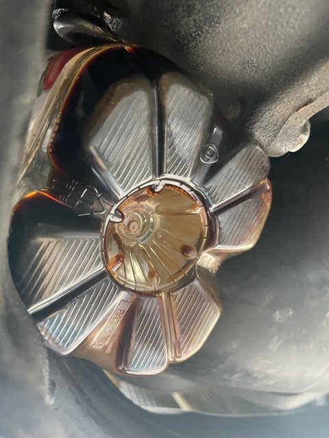

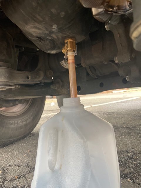

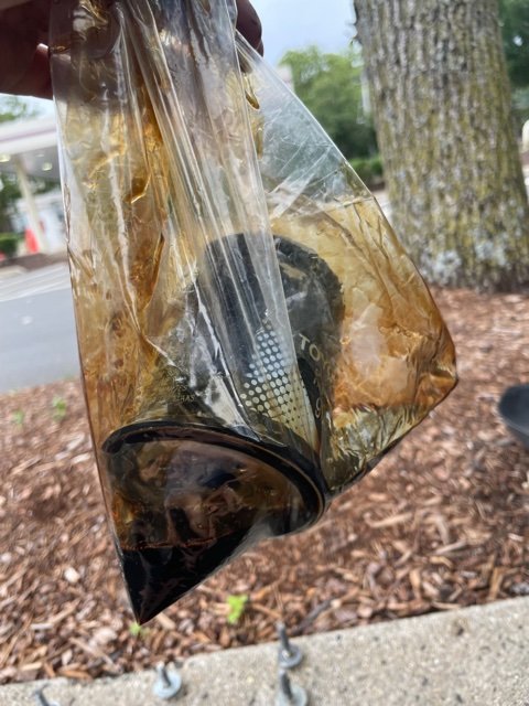

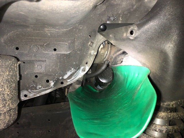

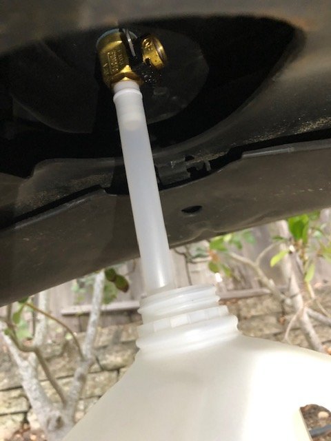

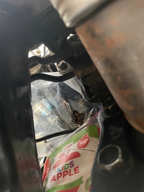

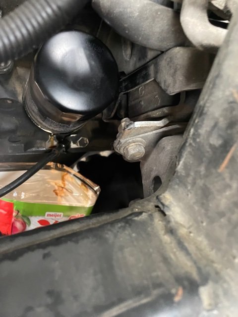

    Don't want to jinx it, but I have found a way that is drip free for changing oil on the V6. Two insights led me there: (i) you have to squarely catch everything that comes off the little lip that's right below the filter, which I think is the top of the oil pan and (ii) the engine pumps out way more oil than you expect even once the filter is off, mostly comes out of the hollow bolt that the filter threads on to.
    My approach (YMMV) and the bolded parts are the things I've figured out over the last few months that make it truly drip-less:
    1) Use a Fumoto valve for draining from the drain plug. I heard lots of opinions about this and ultimately a sage friend endorsed it and I went for it. Couple years now and no trouble. Would recommend the crazily overpriced plastic part that they sell to sock into the tube you use to drain out, it really makes connecting the aquarium hose or whatever to the nipple much easier.
    2) Careful to hold the hose onto the Fumoto valve when you are switching to an empty jug (capacity of mine at least is more than a gallon)--it has a tendency to slip off the nipple (even with the plastic thing) and then slide into the full gallon of oil, which makes for a fun fishing adventure to get it back (you have to drain the whole gallon etc.)
    3) Open the filler cap up top in the engine bay to let the pressure out but put the cap on to avoid dust etc. getting in.
    4) Crank the wheels to the left (insert the key but don't turn on the engine). Use those muscles to take the place of power steering.
    5) Remove the half dozen "christmas tree" plastic rivets that hold the front half of the wheel well skirt in place. These are available aftermarket on Amazon for like $10 for 50 of them and they last a couple times. You should see the back of the oil filter after you (gently) move the skirt over to the back of the wheel well (I drape it over the upper control arm).

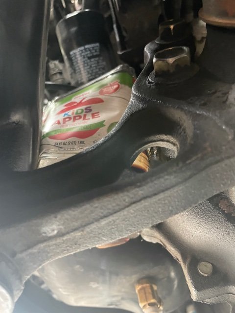

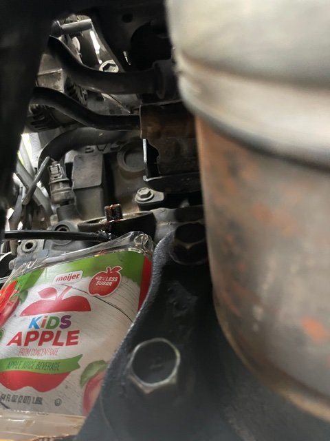

    6) Buy a ~half gallon juice container that is roughly rectangular. Cut the top off so that you just have the bottom and the rectangular part (cutting off the conical, sweeping part that goes up to the cap). You can also just cut off the bottom half inch or so, though in that case you're inverting it and trusting the cap won't leak. This is the one I buy (dump out the juice, stuff is straight sugar): Product Details (meijer.com).
    7) Crawl under and remove the skid plate. I have yet to find a way to do this spill-free with the skid plate on. Pain yes, but if you don't then you just have oil sitting in the skid plate and it attracts grime etc.
    8) Carefully place the juice container underneath the lip immediately below the oil filter. This is the key part, this is what makes all the magic possible. Look at it from below and above and from the wheel well and adjust as necessary. Basically you're trying to create a place for all the oil to stream off the little lip and right into the container. It's almost perfect dimensions so you have to compress the container a bit to get it up in there. The great part though is that it's tight enough that it will hold up on its own, even half full of oil.
    9) Unscrew the oil filter until oil is dribbling out, but not all the way. Wait a while, listen to it drip into the juice container. Note with glee how it does not fall on the ground or your head or your arm or your diff.
    10) Take a gallon zip lock freezer bag and scrunch it fully around the oil filter, so that the base of the filter is at the bottom of the bag and there's a ton of bag that's squished against the block. Slowly twist off the oil filter. Takes patience because you have to rotate the bag with it and you also have to make sure the bag is still on the filter. The bag also makes the grip on the filter a little less easy. Though if you're struggling too much you're probably putting on your oil filters too tight.
    11) Once the oil filter is off, slide it down into the zip lock. The key I've found here is gravity, you want the opening of the bag (the zip lock part) to be as high as possible and also be the part you're guiding out into the wheel well. If the bag gets inverted or dragged down, then the oil is going to fall out and you'll be upset.
    12) Wait a while for the oil to pour out of the oil filter housing area into the juice container. I've been waiting like at least a few minutes because it's annoying to wipe it and then quickly put on the new filter.
    13) Screw on the new filter through the wheel well. I do hand tight and then back it off a quarter or a third of a turn.
    14) Gingerly pull the juice container straight down and away from the truck. If you cut the top off then it'll stand on its own, if you cut the bottom off then it won't.

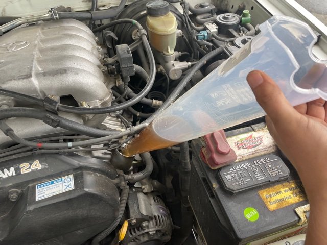

    15) Make sure drain plug / Fumoto valve is closed and fill oil from the top. I've been using these big clear funnels and I have to say it's better than the combination of two small funnels I'd used before. The clear funnel is genius because you know exactly how much is in it and how to gauge the flow rate.

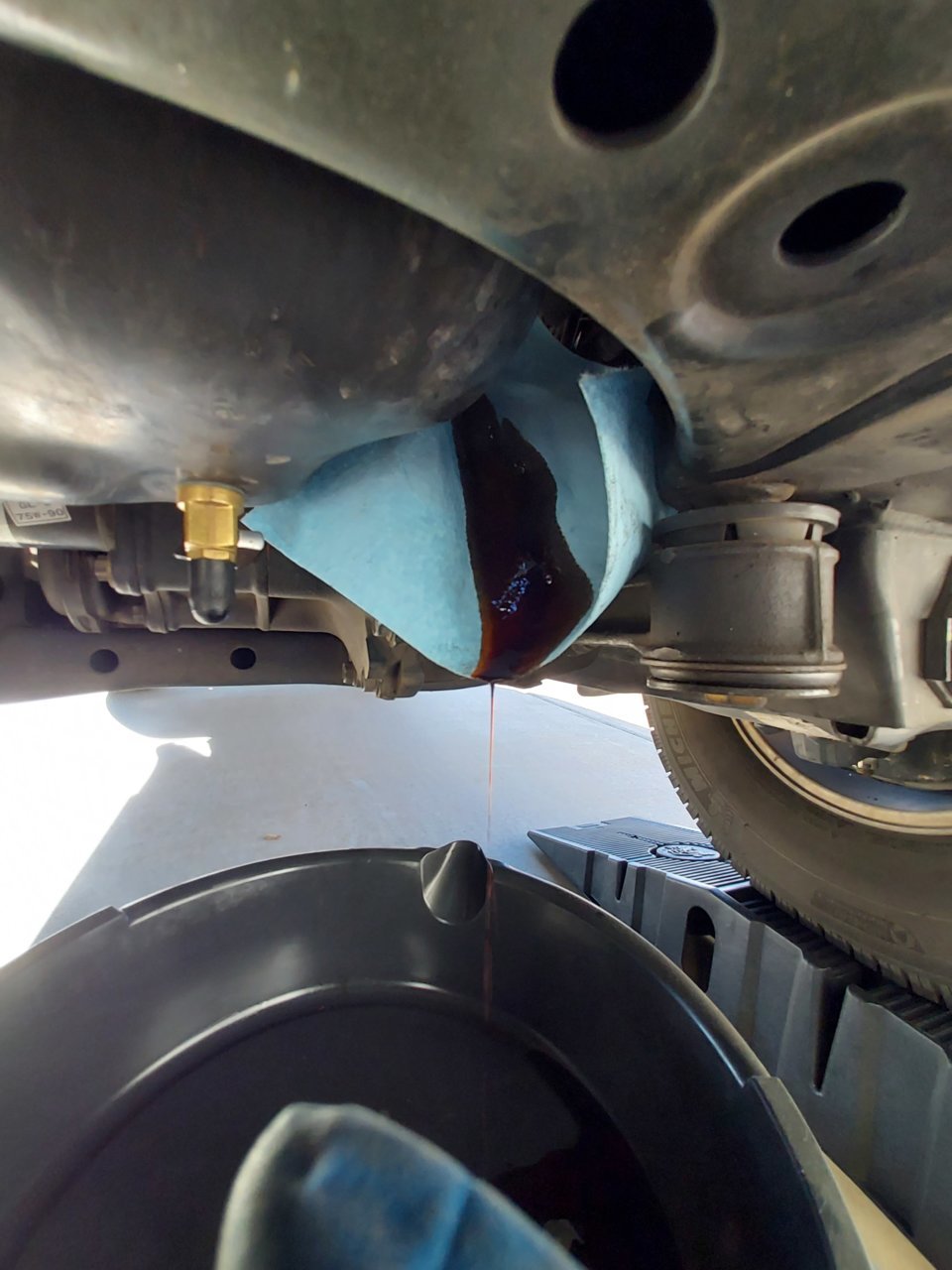

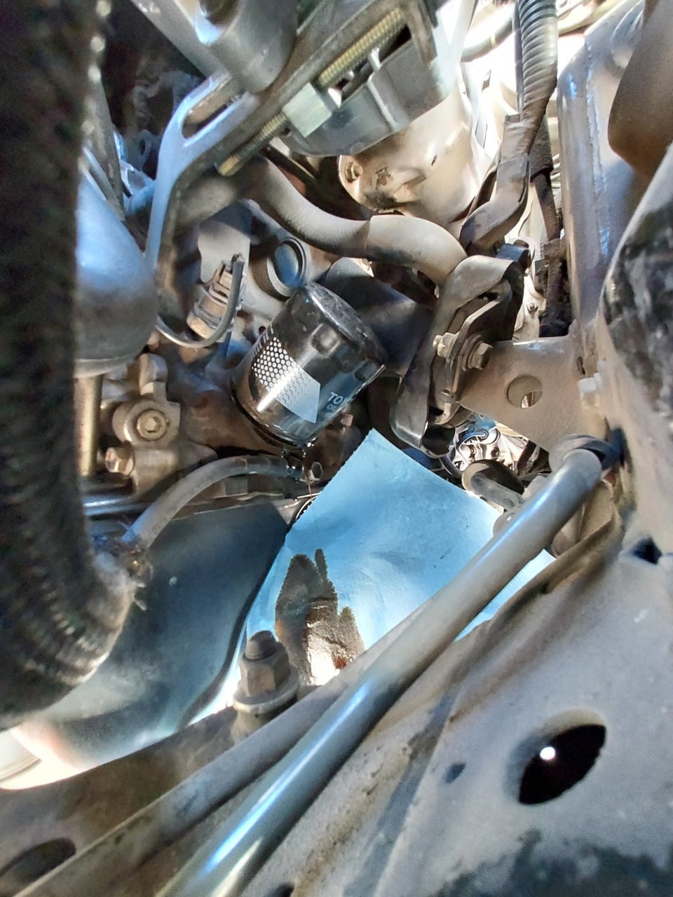

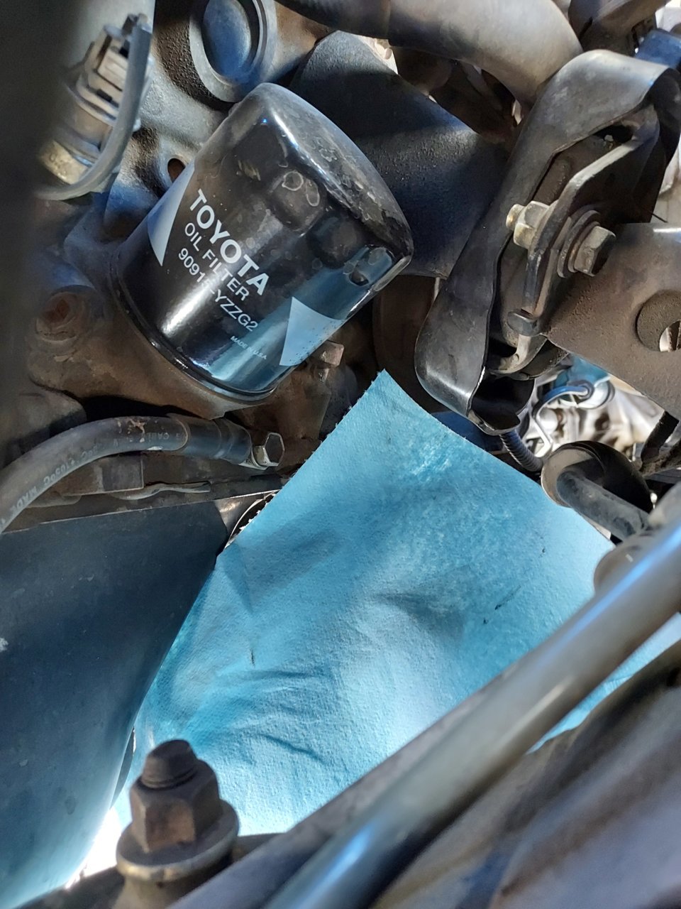

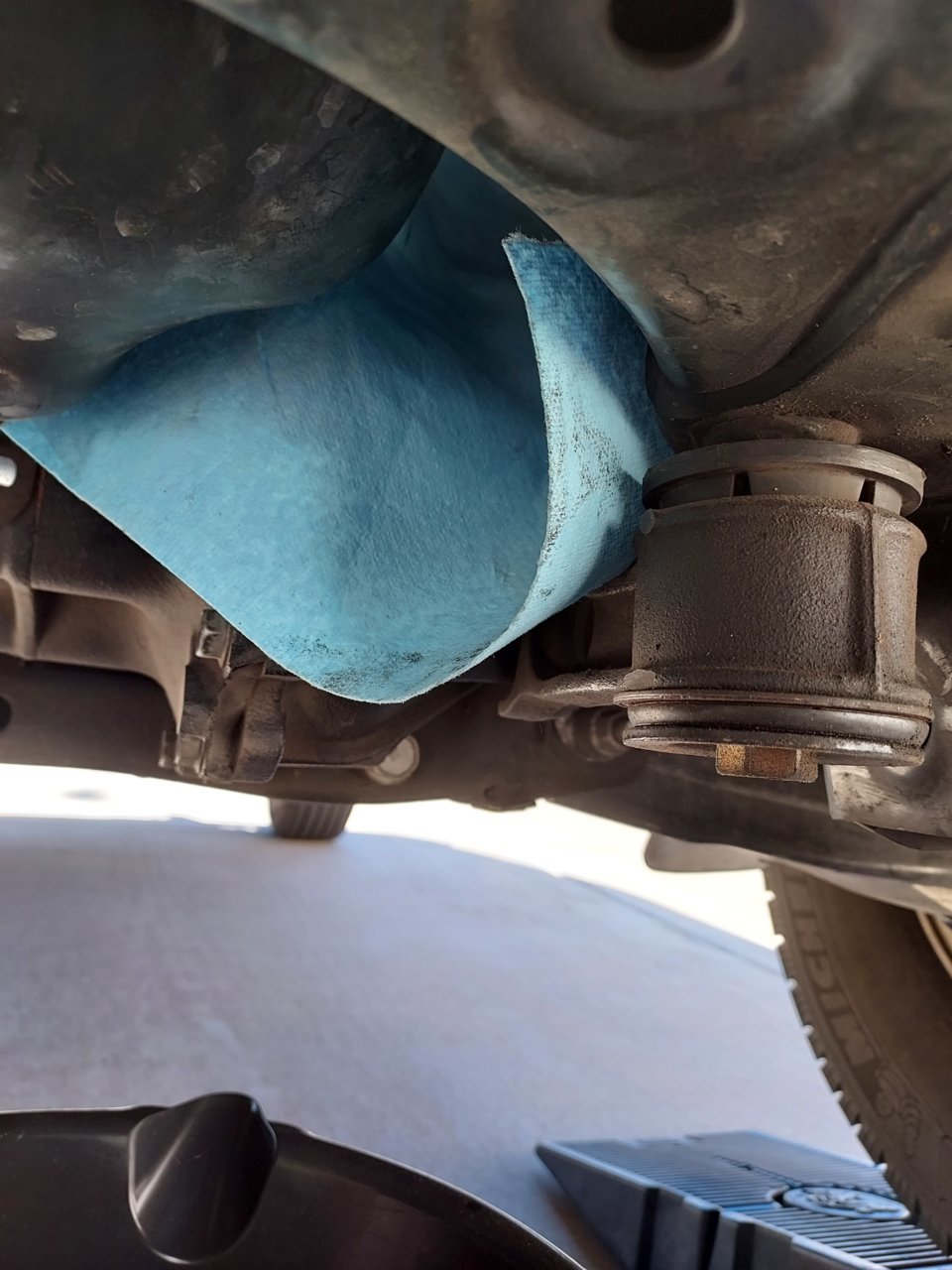

    I just want to record for posterity the paper towel method w/ pictures. Just position the "funnel" so it rests on the front pumpkin and situated below the filter. Crack the seal and let it drain then remove all the way and invert. Take off the towel and wipe the top of the pumpkin if anything seeped through the towel. No mess.
