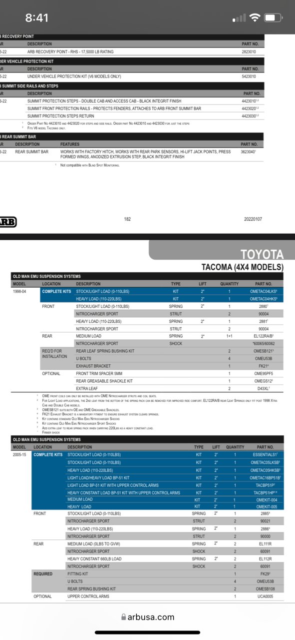

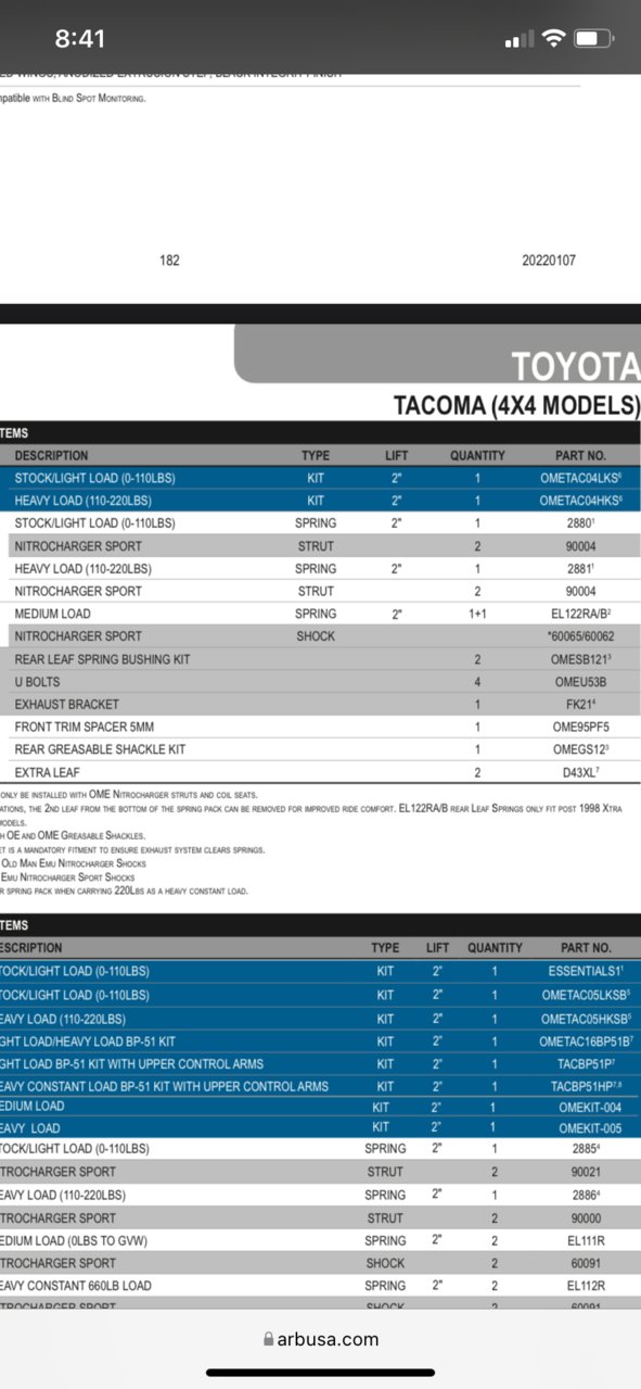

    Earlier I was basing this off Wheelers and a couple other sites. I just now checked the product reference guid on ARB and I’m still not clear on what’s what. I see they list two different part numbers for rear shocks but the one with an asterisk shows a note for “firmer shock”. Does that mean a pair of two identical firmer shocks…? It’s still looking like their rear shocks are the same length. It must not be an issue or they wouldn’t sell so well. Lol here’s a few pics.

    Passenger and driver’s side rear shocks are the same length. I had on my 1st gen.

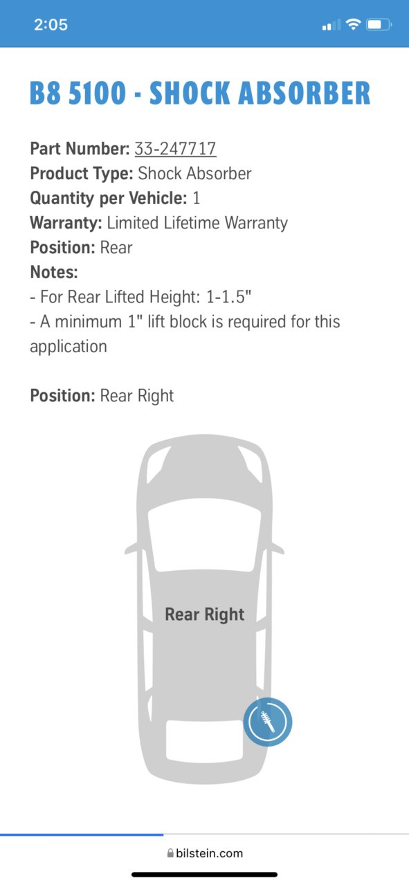

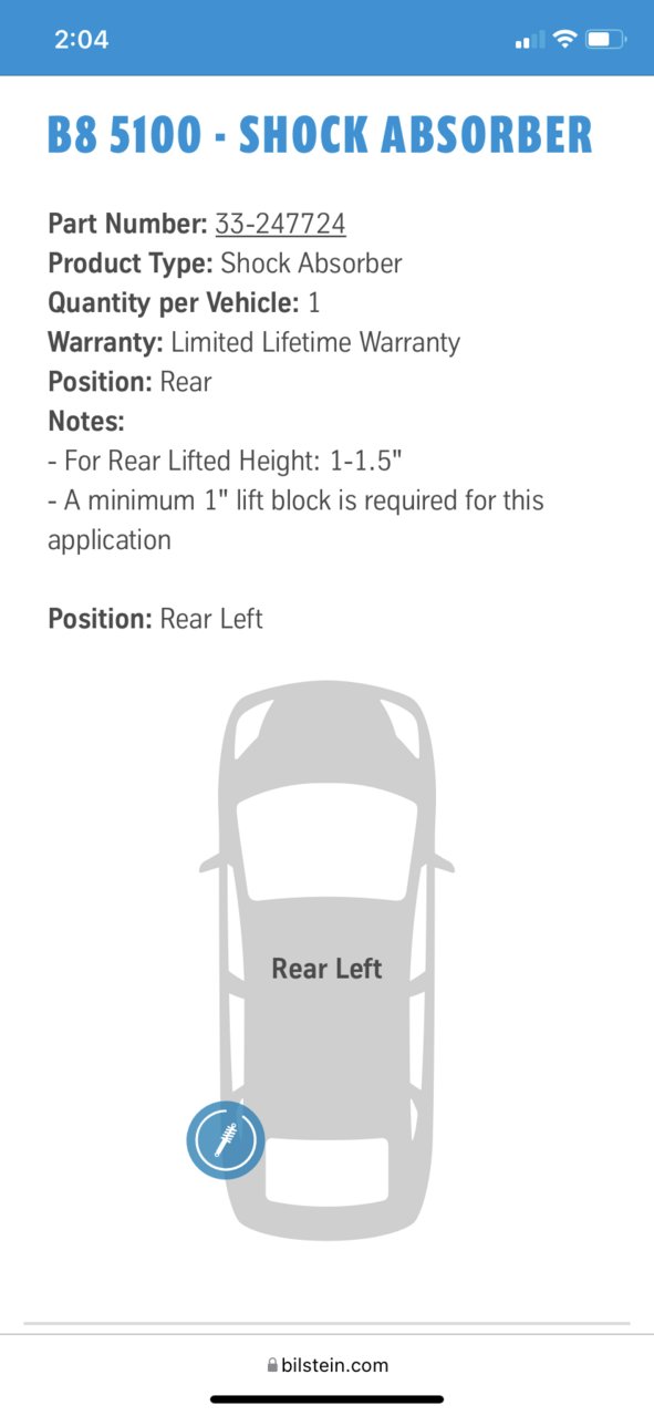

    If you check out bilsteins site, the front 5100s are the same of course but the rear 5100s are different lengths by about an inch. Seems to go largely unnoticed.

    When I ordered my 5100s back in 2018 the shop tried to order both rears identical. I caught the mistake on the PO and got them to order the correct shock for the left rear and the correct one for the right rear. Different parts, slightly.

    Yes, I had bilstein 5100s for the rear set up with OME leaf packs. The passenger rear shock was 3/4 or 1 inch longer because the passenger rear shock is mounted at a different angle. I replaced the bilsteins with OME shocks because the bilsteins started leaking.
