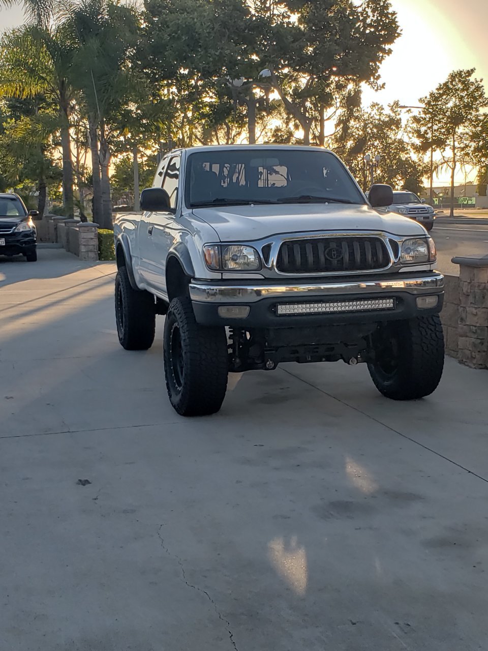

    I have a 01 tacoma on 6inch lift and 33s I wanna put 35s but wondering if that's too much stress on the trans.
