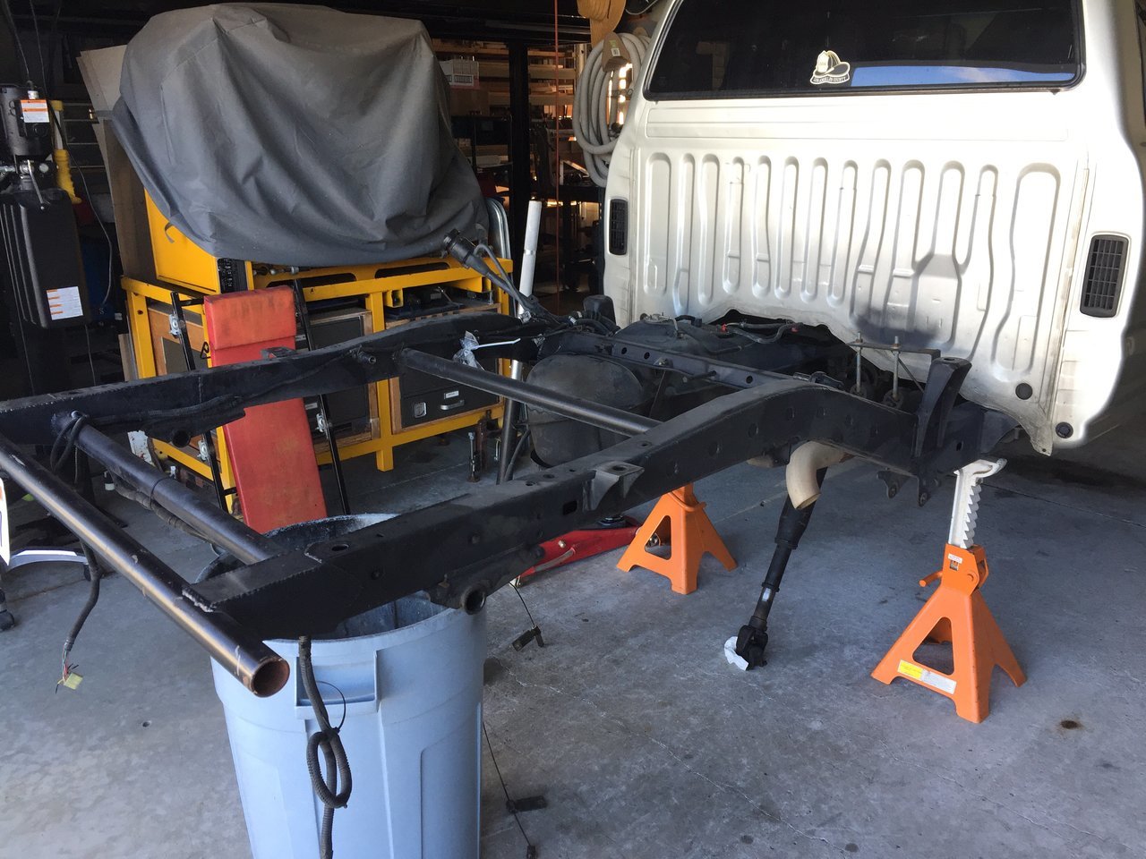

    01 Prerunner on 37's

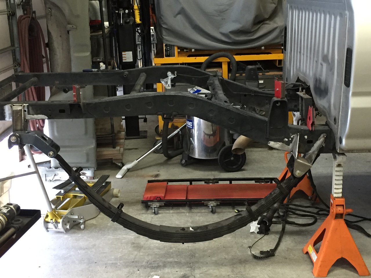

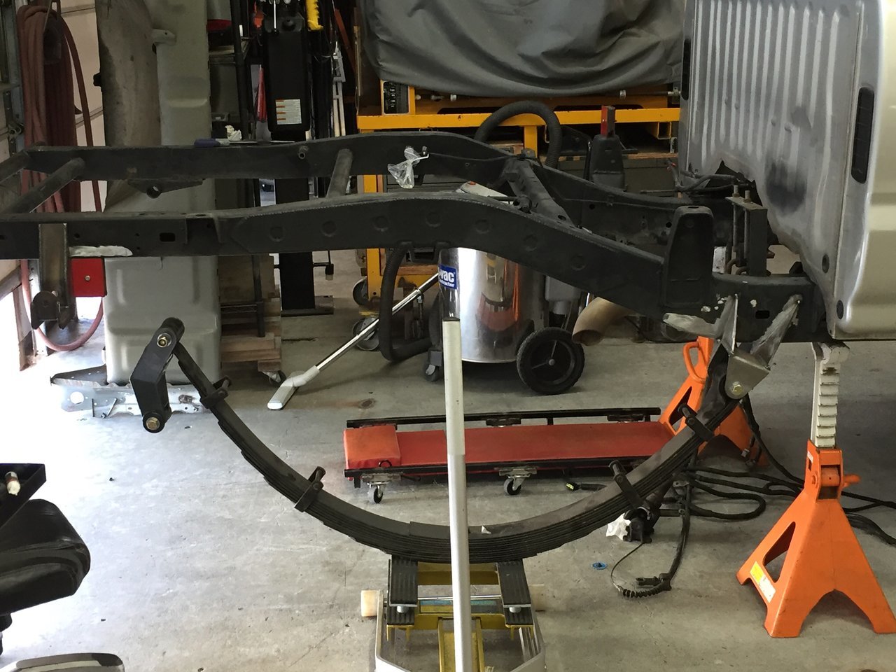

    Solo Motorsports XLT Kit, Giant 64
    Passenger side - done

  3. Jul 2, 2017 at 11:01 AM
    #183
    SanClemTaco
    SanClemTaco [OP] Well-Known Member
    Sep 6, 2012
    #86354
    566
    Sean
    San Clemente

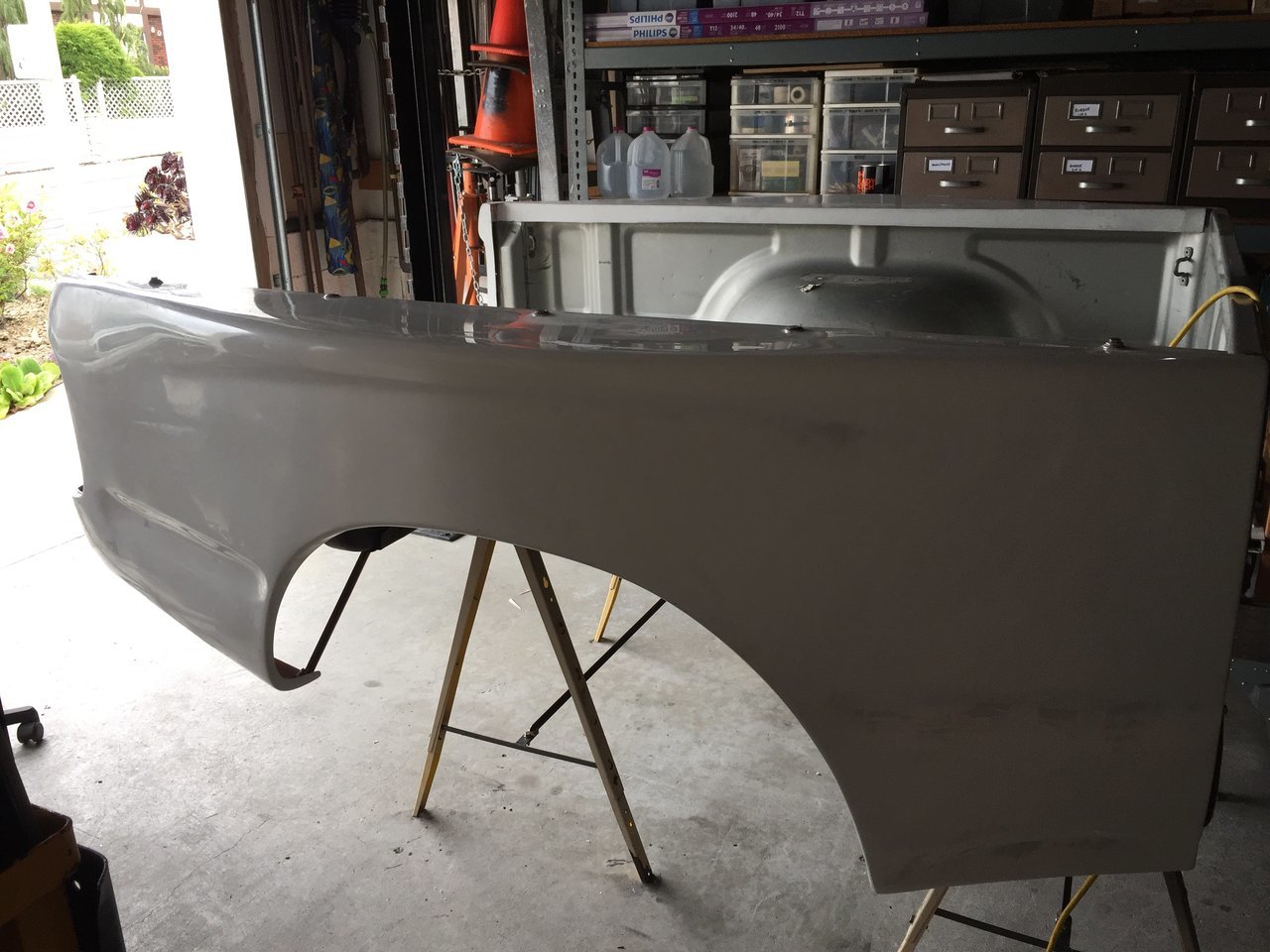

    Fiberwerx 8"

  5. Jul 2, 2017 at 4:22 PM
    #185
    SanClemTaco
    Sep 6, 2012
    #86354
    566
    Sean
    San Clemente

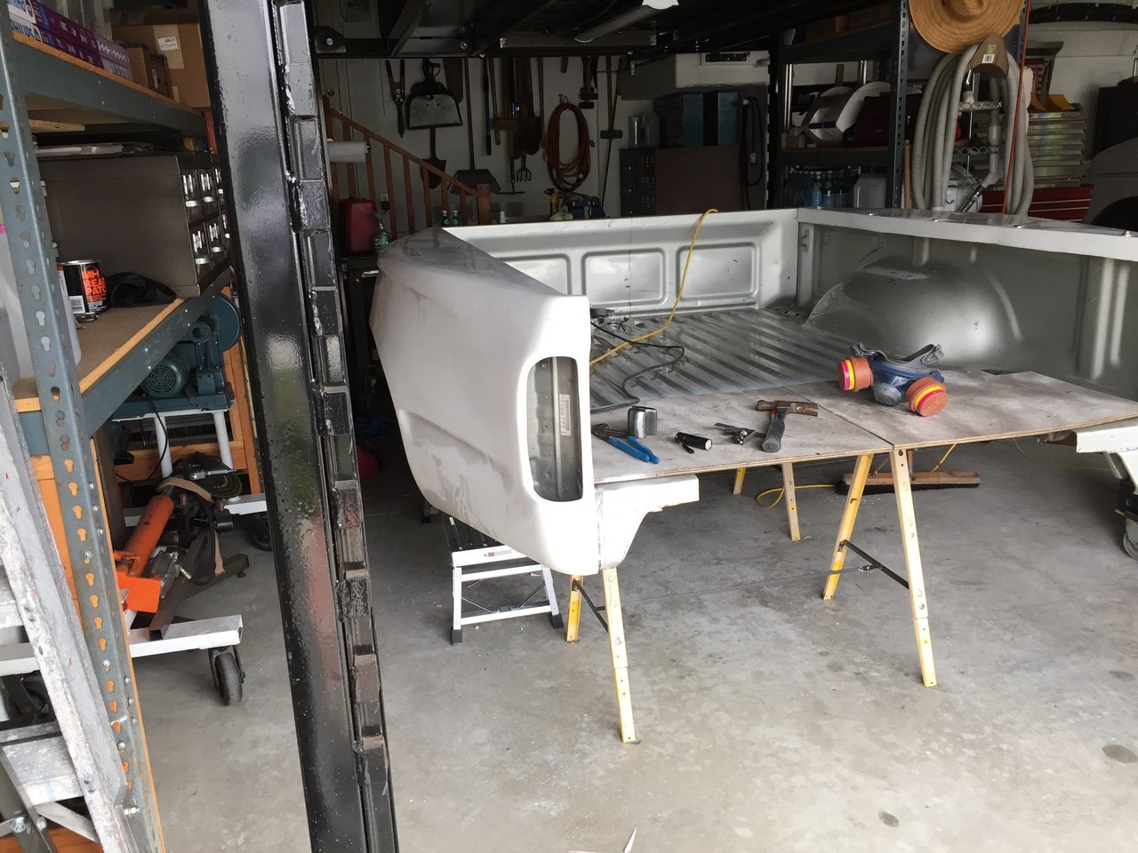

    Driver side installed. Bed should go back on the truck tomorrow and then work on getting the tailights fitted
    FlagNorFail_14 and FlapJack935 like this.
  6. Jul 2, 2017 at 4:22 PM
    #186
    SanClemTaco
    Sep 6, 2012
    #86354
    566
    Sean
    San Clemente
    Yes, it's still sitting on jack stands
    FlapJack935[QUOTED] likes this.

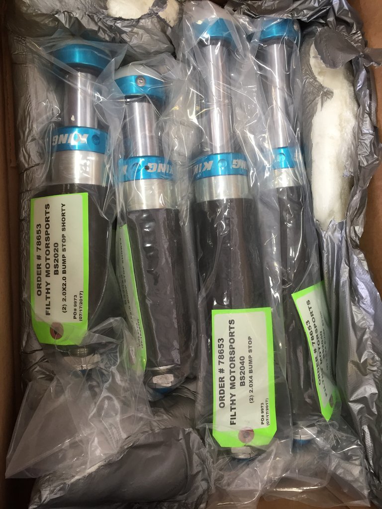

    More stuff

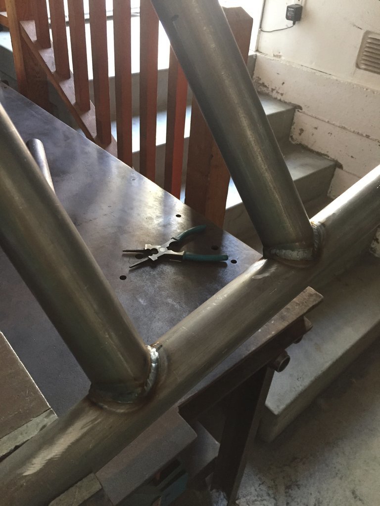

    Started work on some sub frame tubing that will be used to mount a front bumper, rear suspension is on hold due for a few more weeks

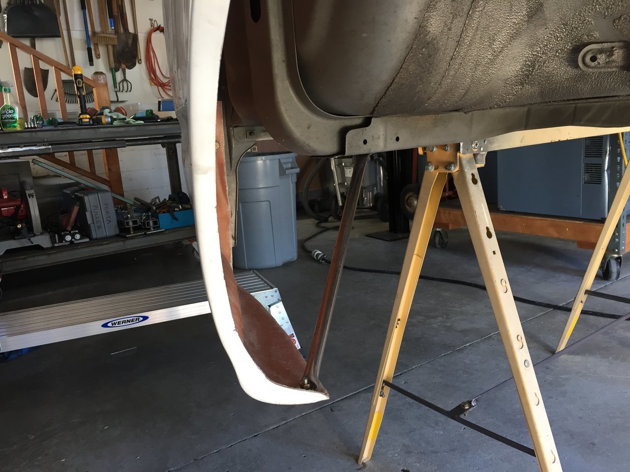

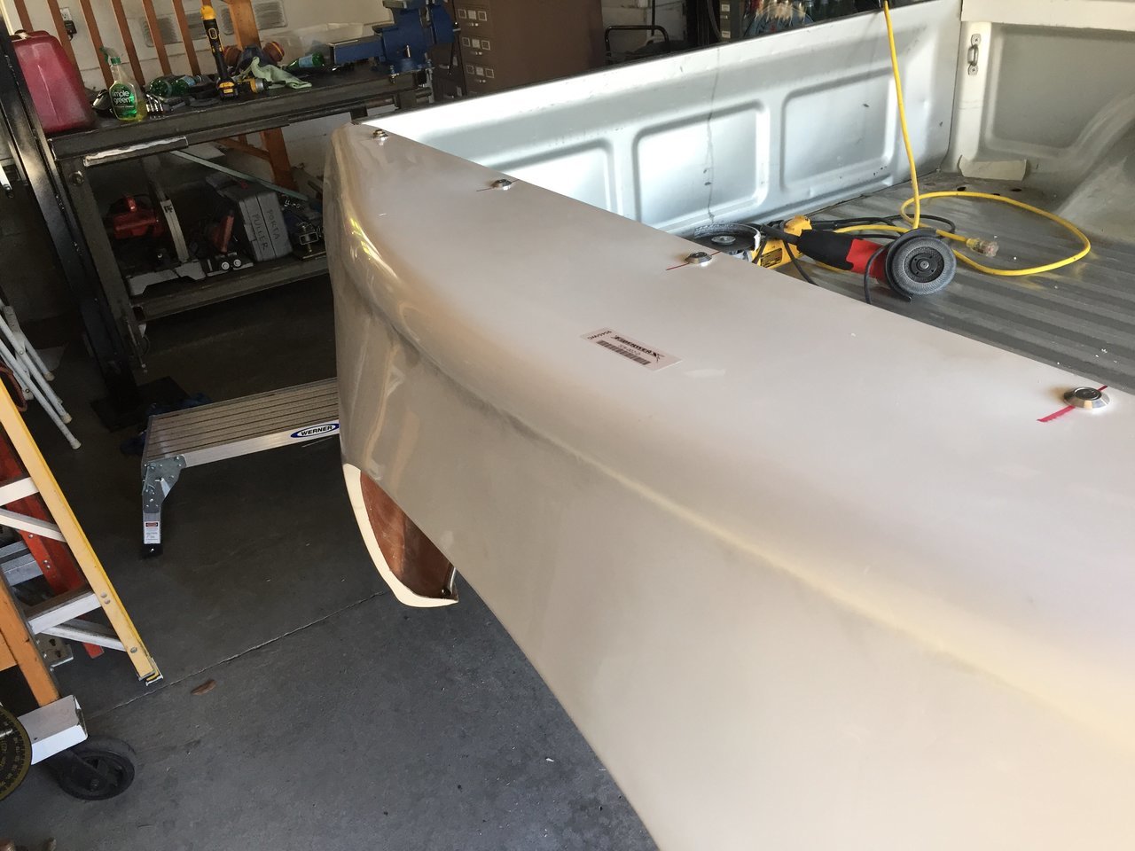

    Its how the kit is designed. switched the compression shackle for a tension shackle. this allows more spring arch with out lifting the rear crazy high.
    Correct it was designed for a ford where this is the stock style set up. i doubt its going to free up bed space, the shackles contact the bed floor so the bed isnt going back on. Instead ill be doing aluminum fill panels like on a frontier i saw on dezert rangers

    Looking at the other guy's truck that has this kit I noticed that he had some holes cut out that probably allowed the shackles to pass up through the bed - good to know!
