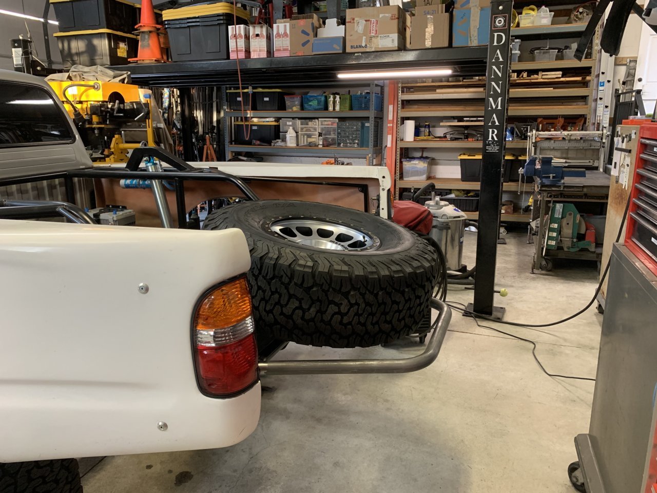

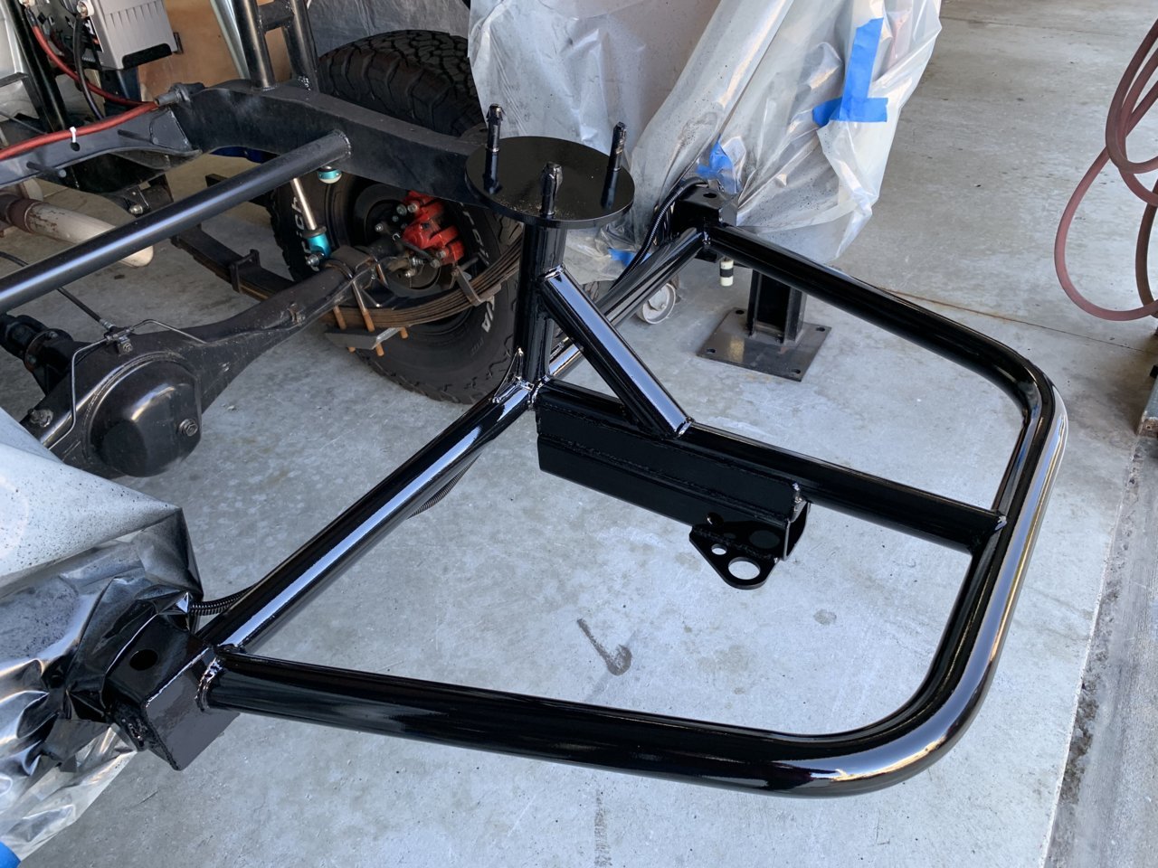

    Started on a rear bumper

    Bumper temporarily finished. Need an upper tube to give it some extra support but that won’t happen until I modify the bed cage

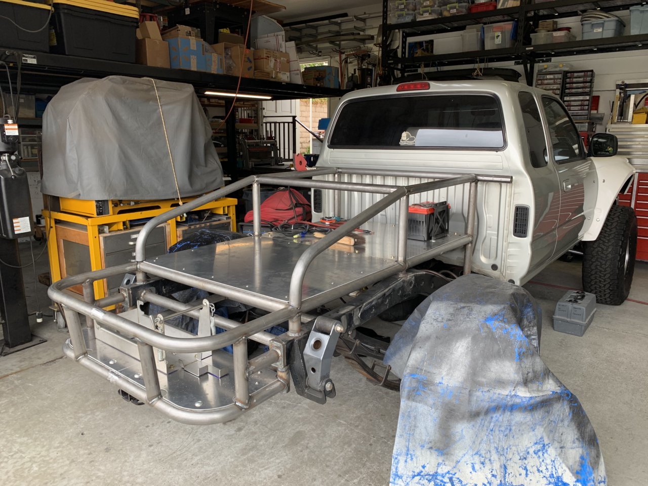

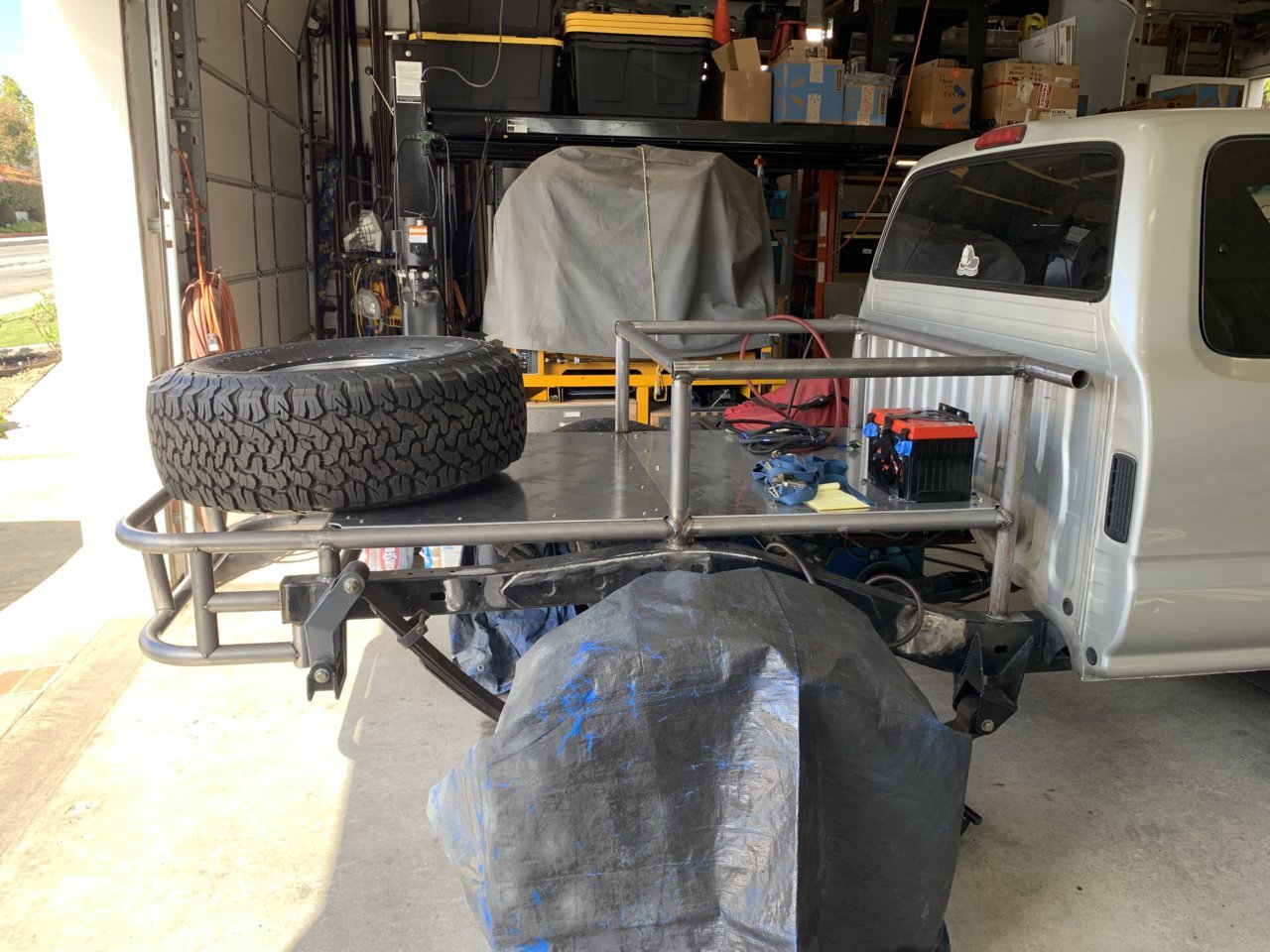

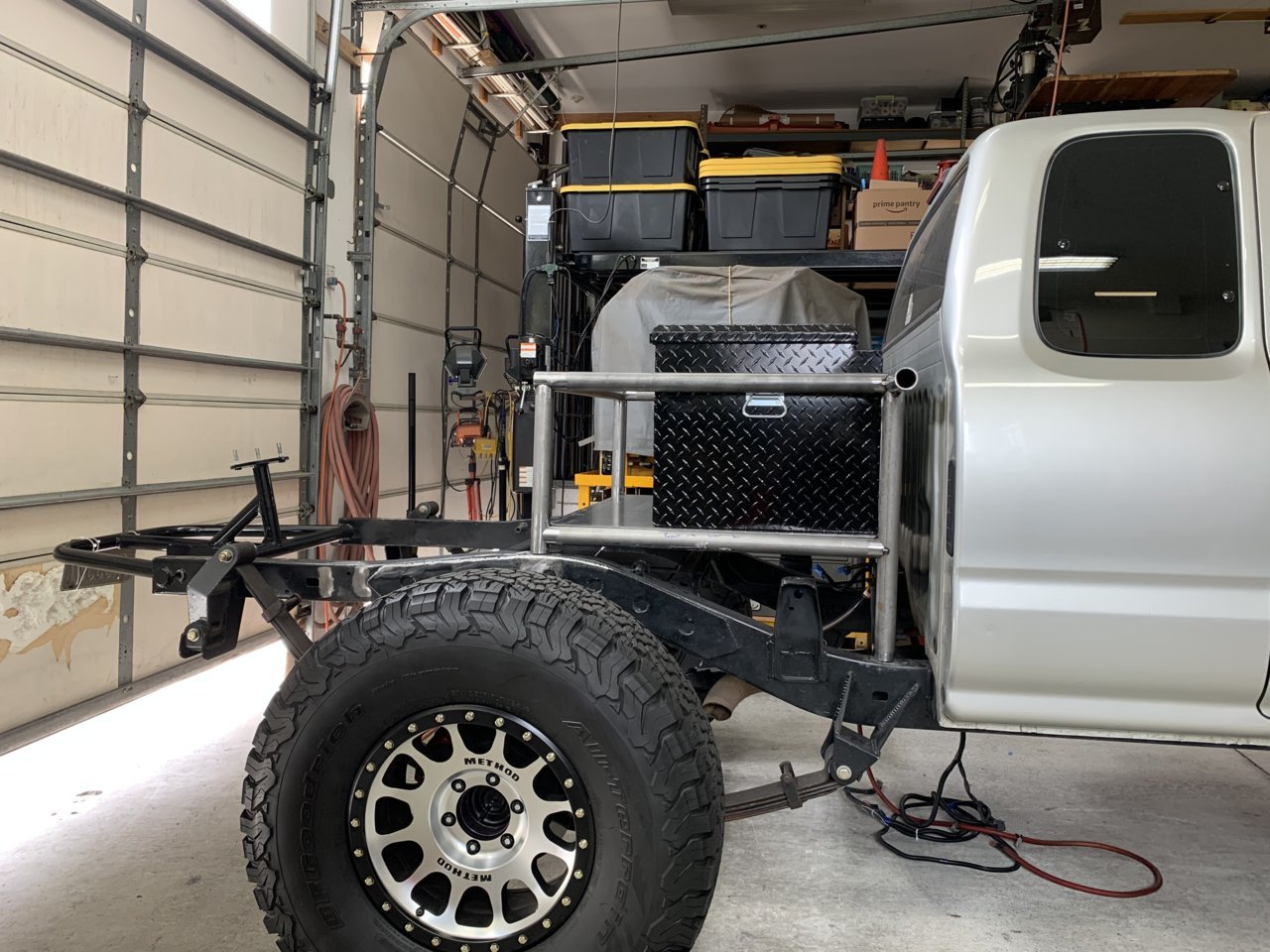

    Bed cage 2.0 started

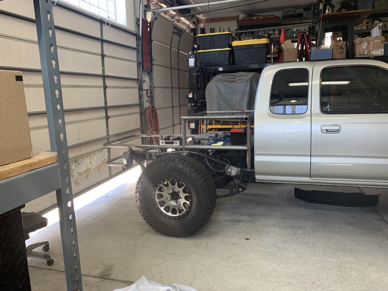

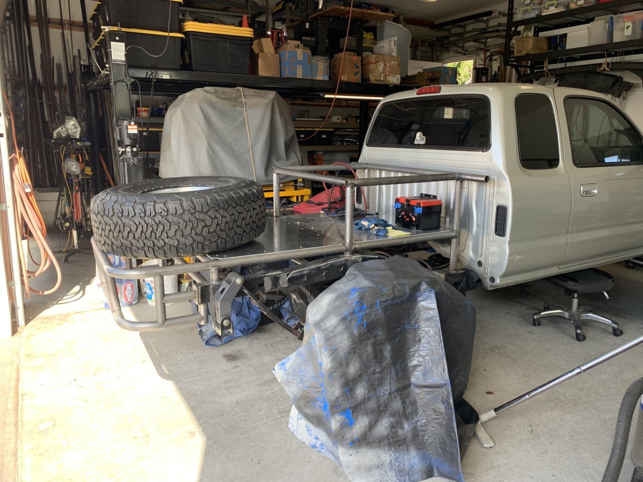

    More tubes added. Hoping to be done by the end of the long weekend

    What tubing is the bedside mount made out of?

    3/4" .060 wall (?)
    im guessing here, those are long gone

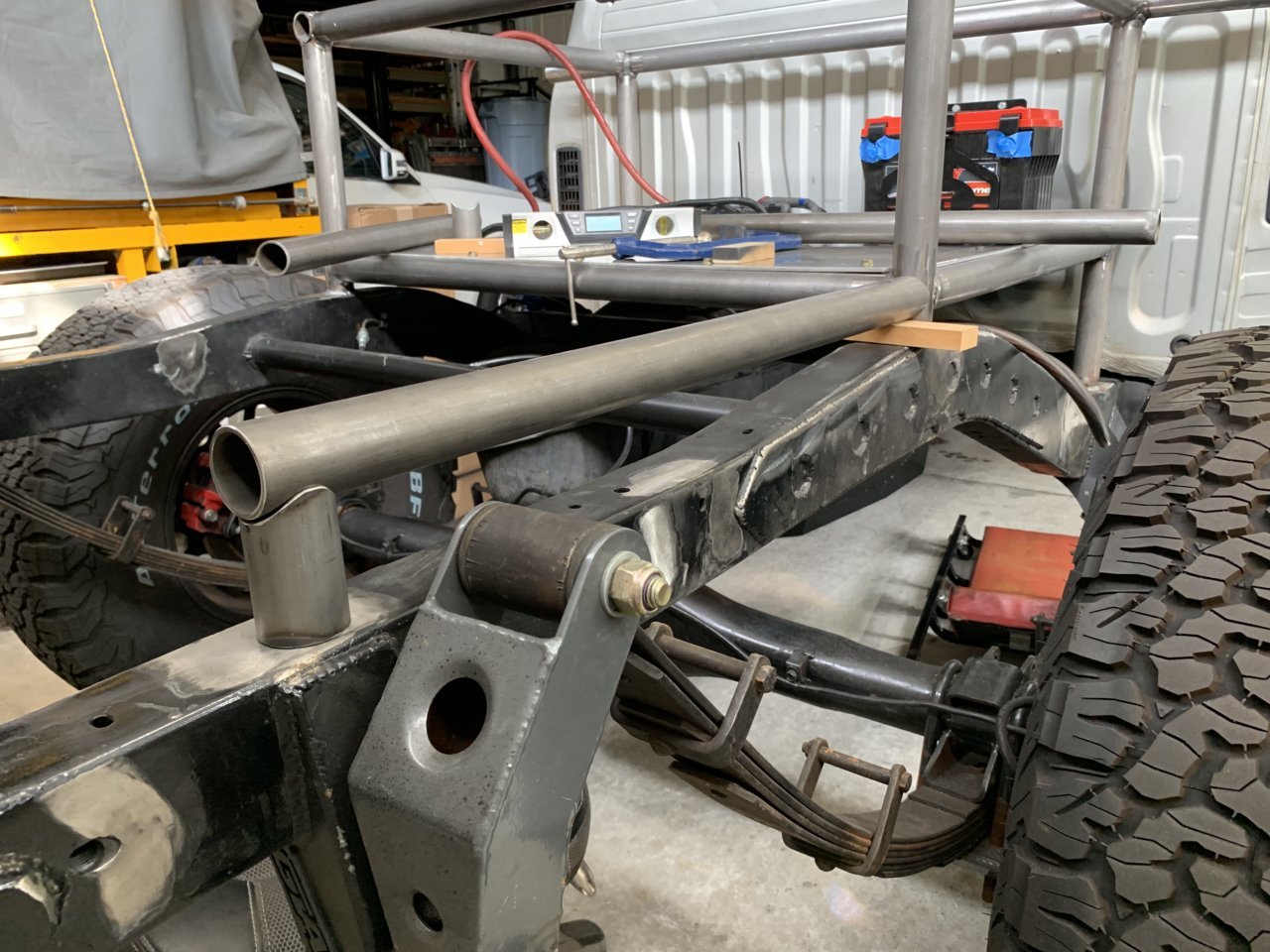

    Did you just crush it in a vise - I bought some thin 3/4" tube from HD and some 1/8" plate and was thinking of making something similar.

    i used my press, but a vice would work.
    just be careful, ive broken vices before trying to use them like a press

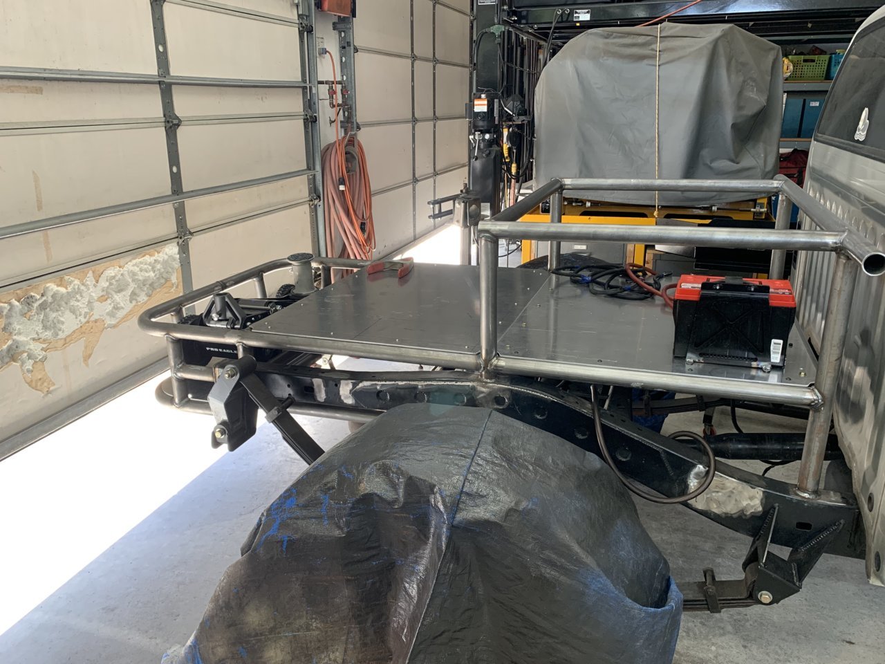

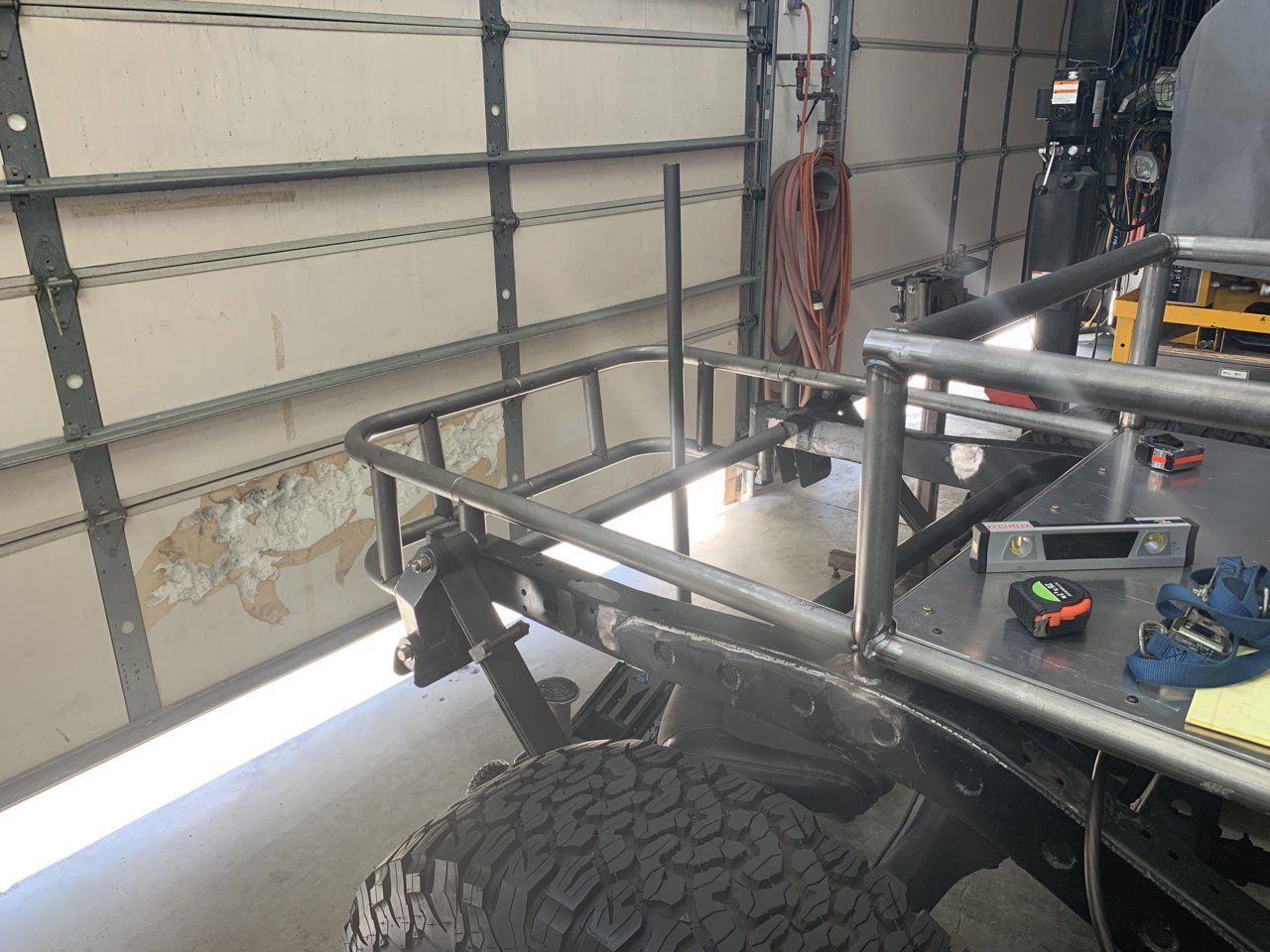

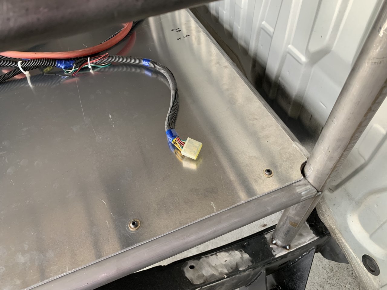

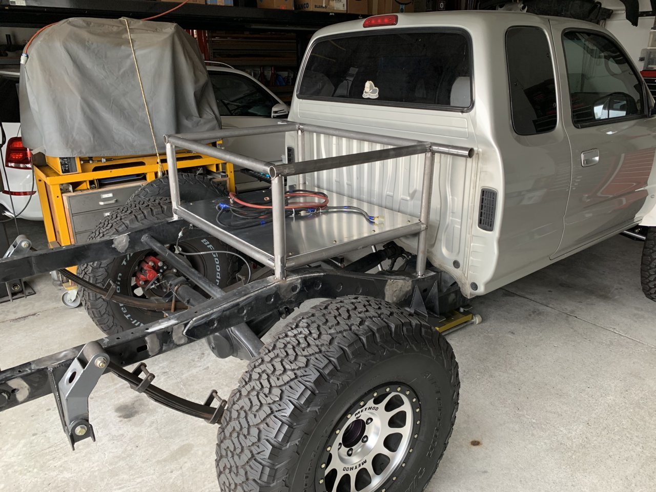

    More progress

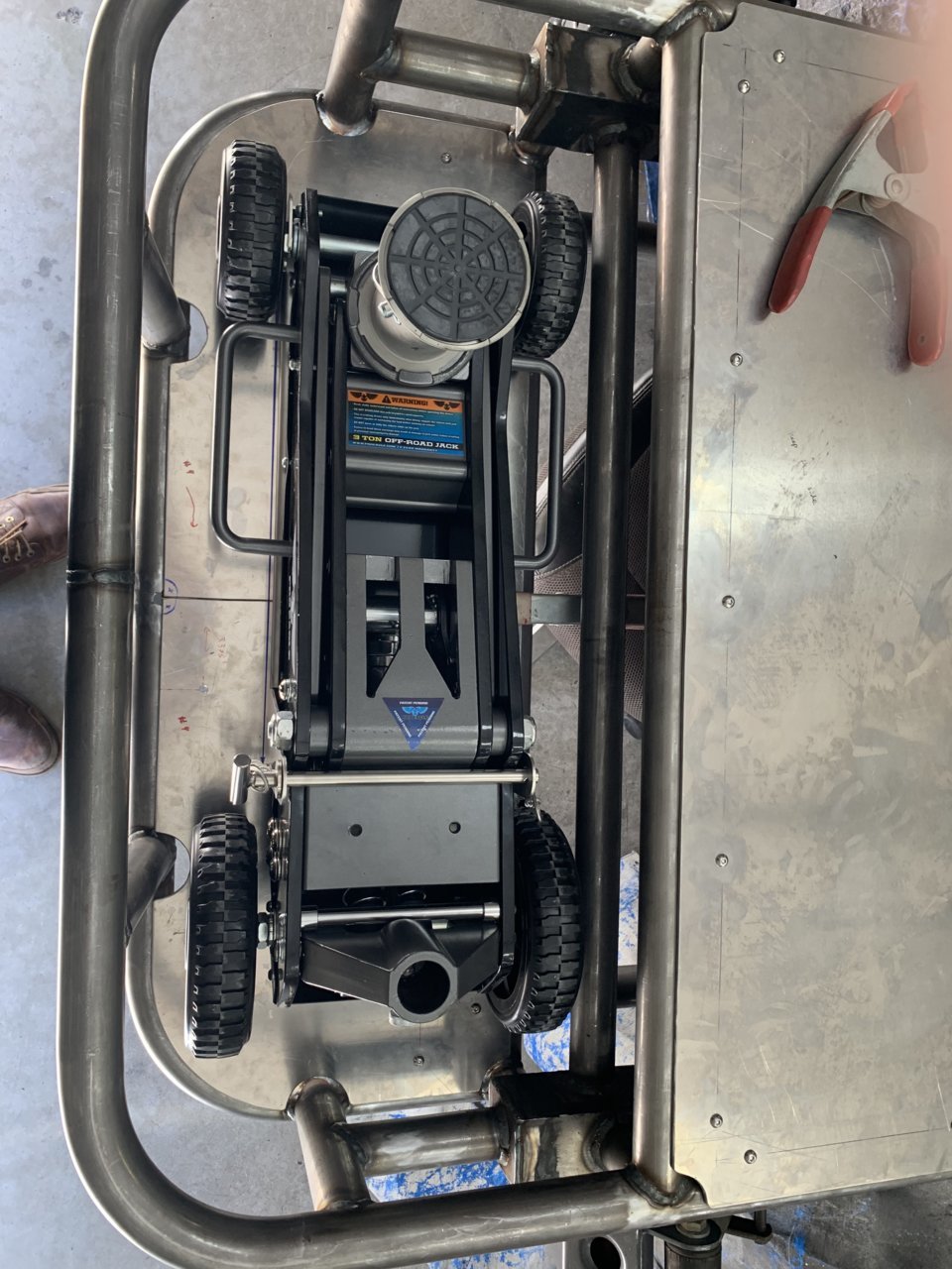

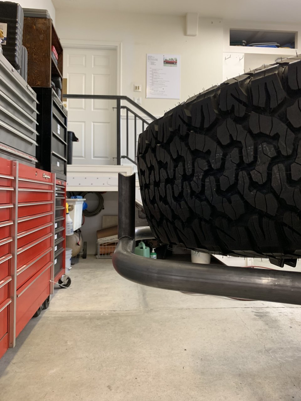

    Not finished, but decent progress
