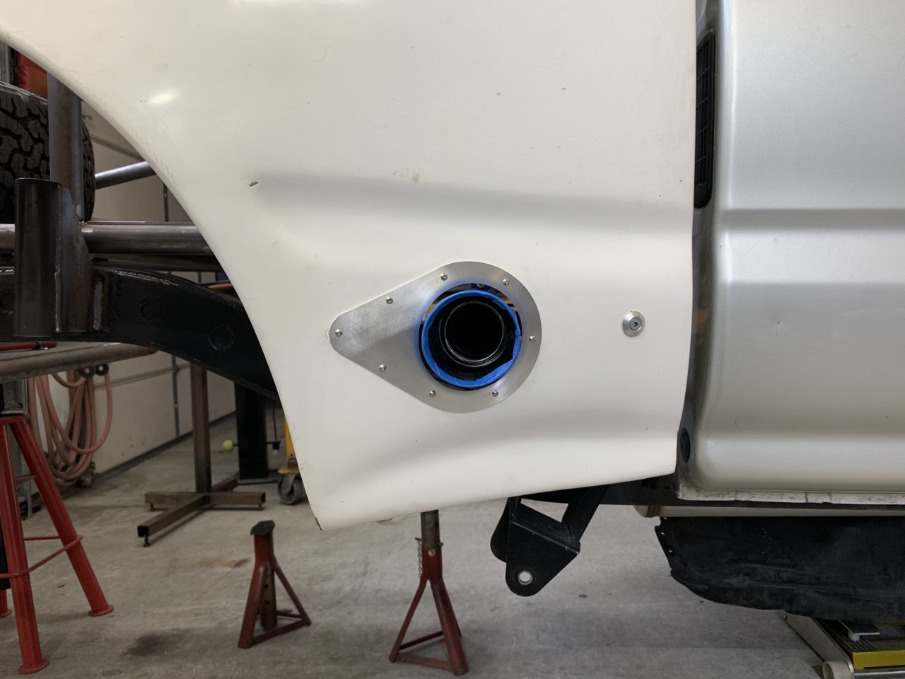

  2. Jun 23, 2019 at 3:57 PM
    #342
    SanClemTaco
    SanClemTaco [OP] Well-Known Member
    Sep 6, 2012
    #86354
    566
    Sean
    San Clemente
    01 Prerunner on 37's
    Solo Motorsports XLT Kit, Giant 64

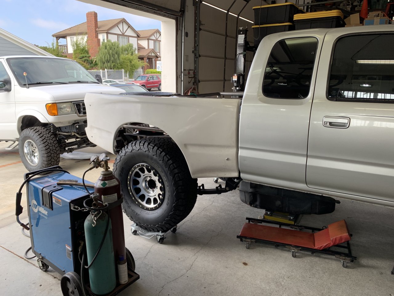

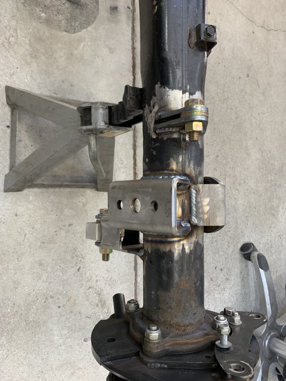

    One side mocked up

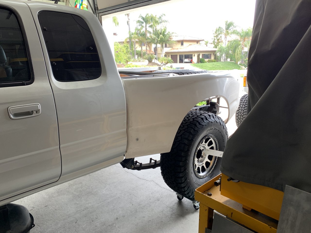

  3. Jun 24, 2019 at 11:27 AM
    #343
    SanClemTaco
    Sep 6, 2012
    #86354
    566
    Sean
    San Clemente

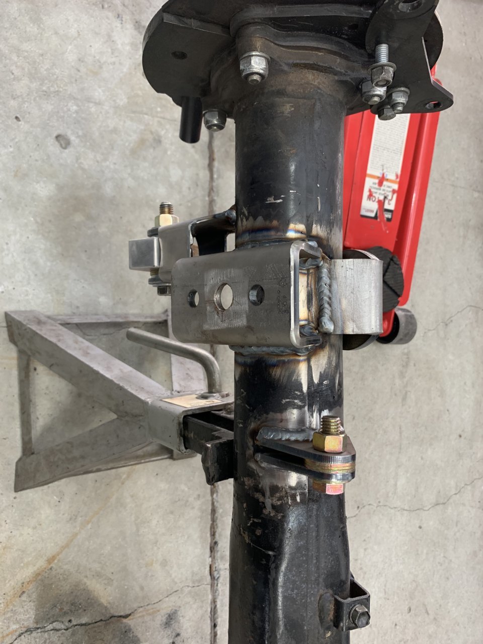

    Driver side
    LukeCC and Dalandser like this.

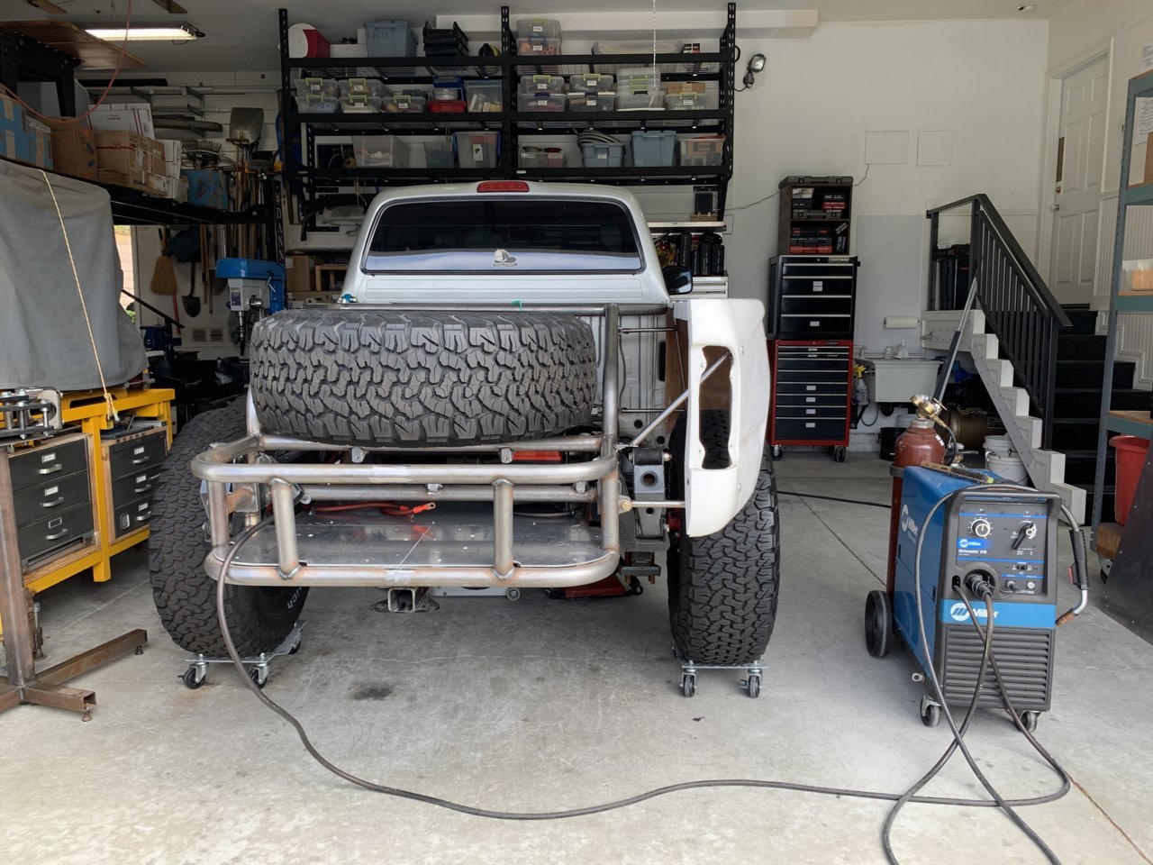

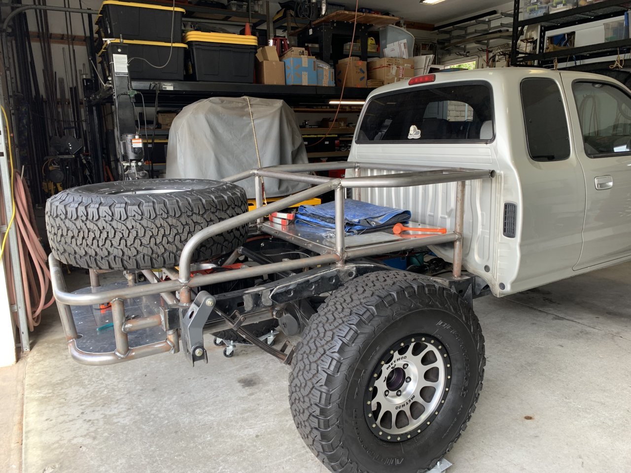

  4. Jun 24, 2019 at 4:29 PM
    #344
    SanClemTaco
    Sep 6, 2012
    #86354
    566
    Sean
    San Clemente

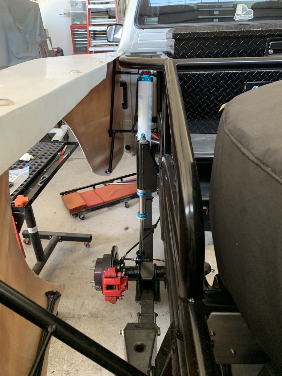

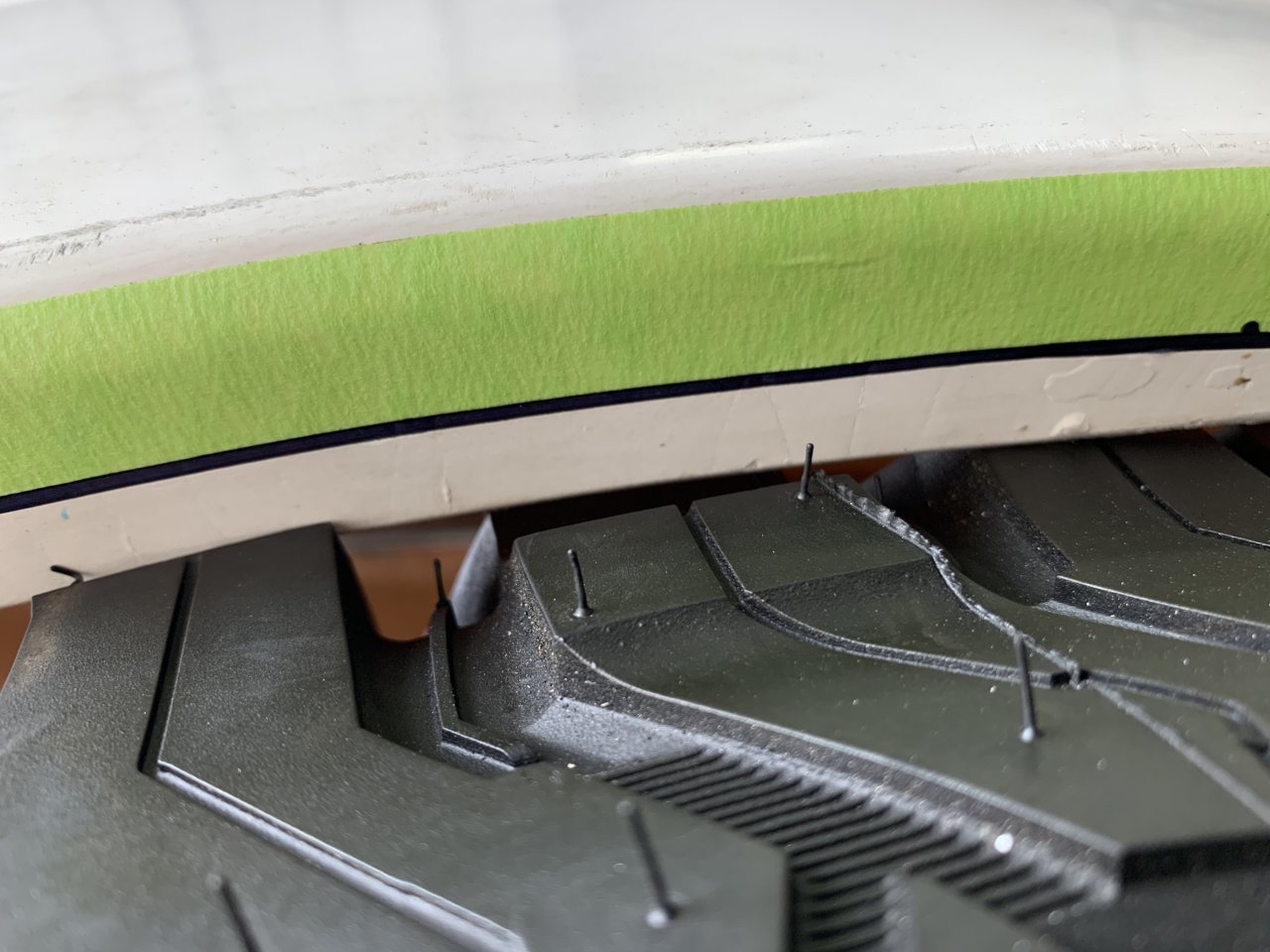

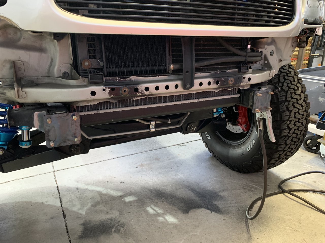

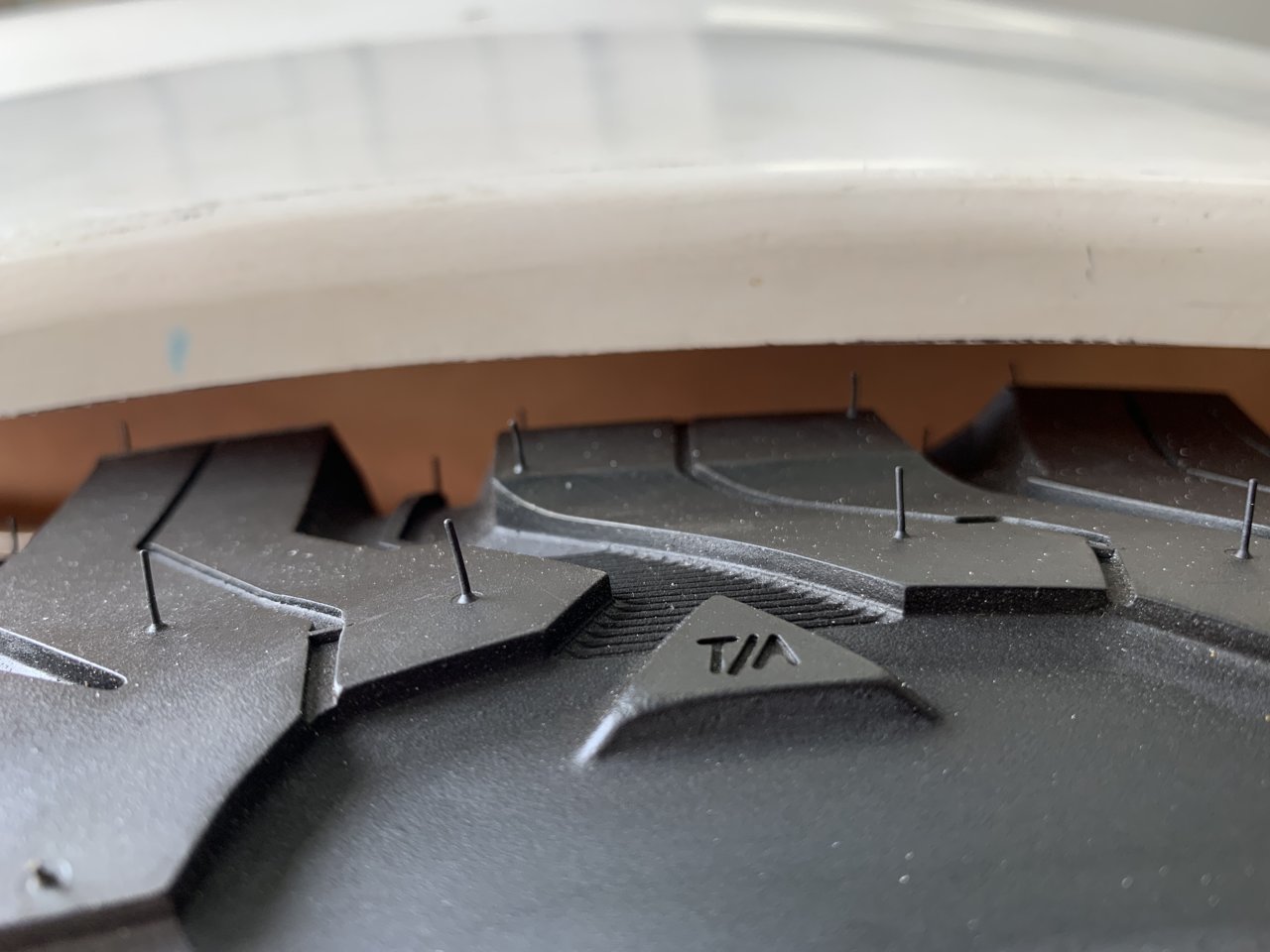

    Running out of clearance, and yet to hit full bump

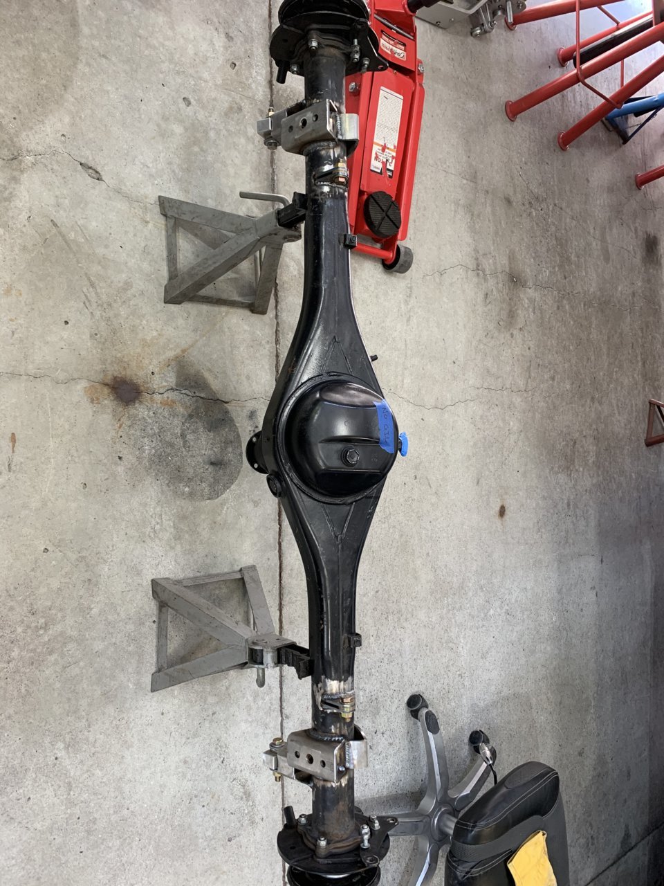

  5. Jul 5, 2019 at 3:33 PM
    #345
    SanClemTaco
    Sep 6, 2012
    #86354
    566
    Sean
    San Clemente

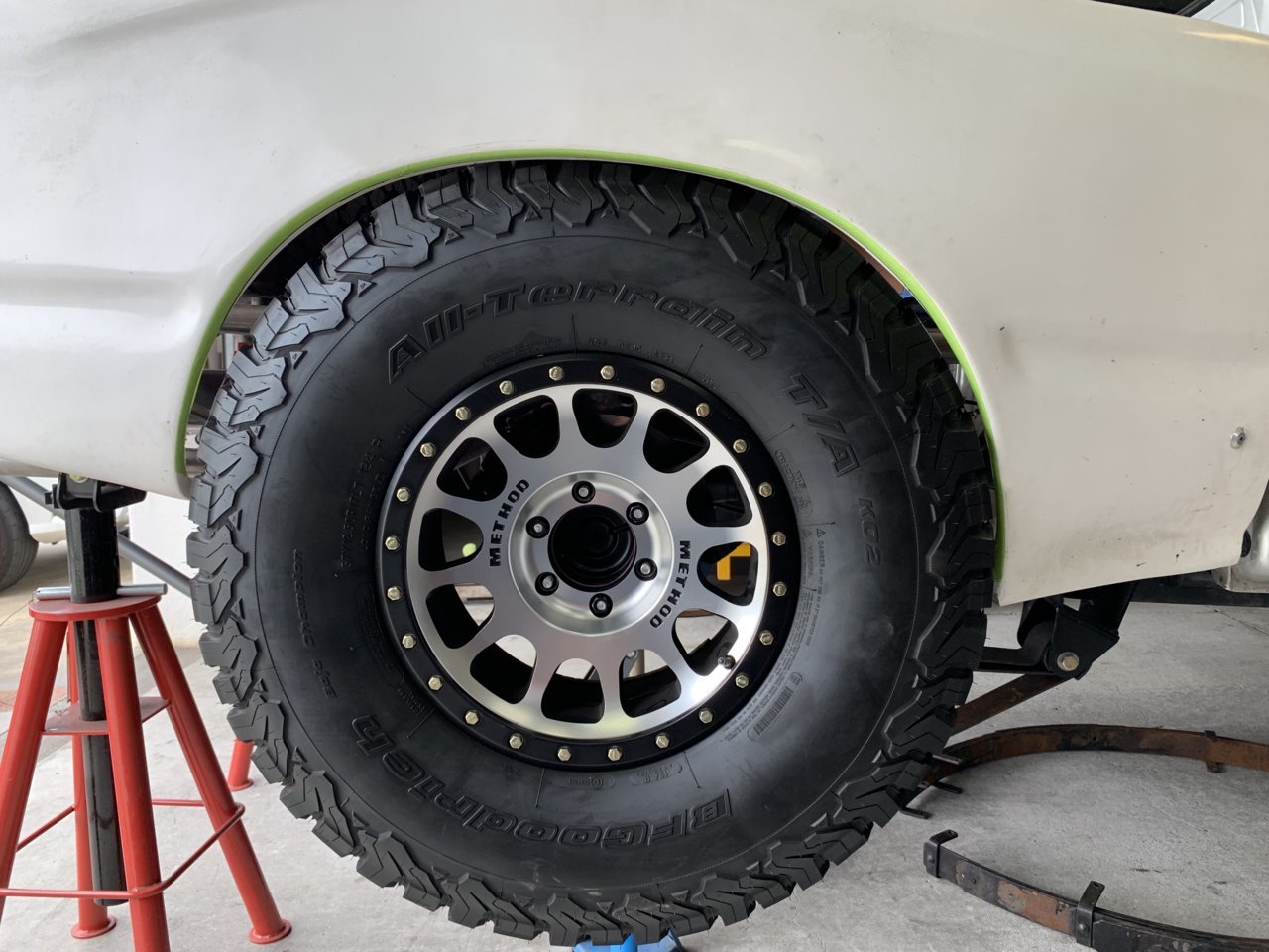

    New axle setup

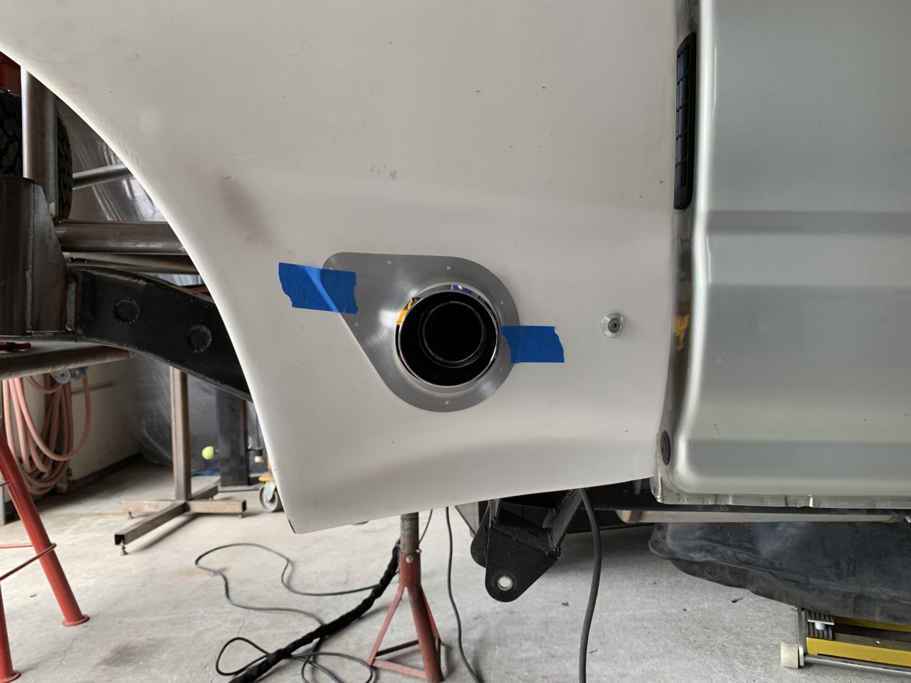

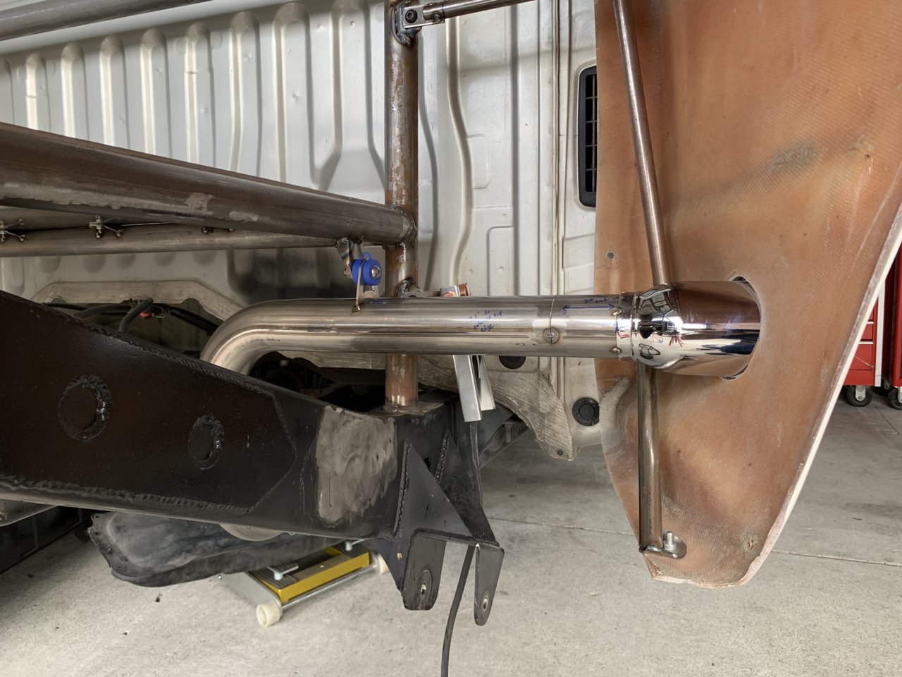

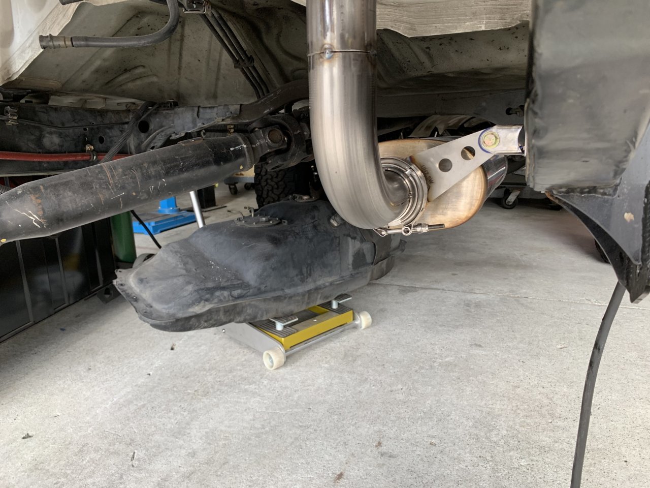

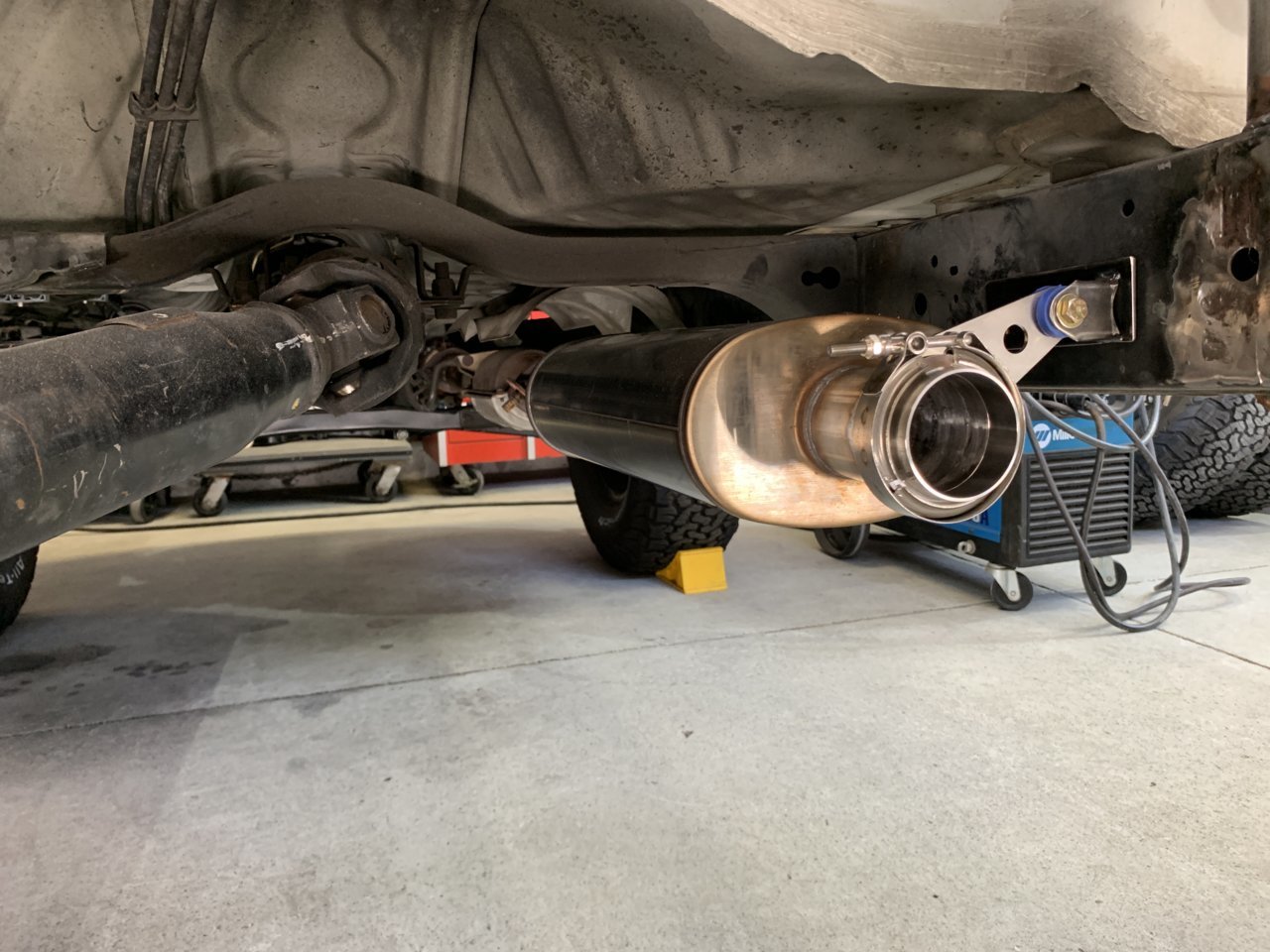

    Exhaust going down

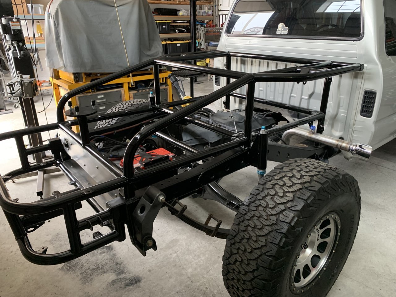

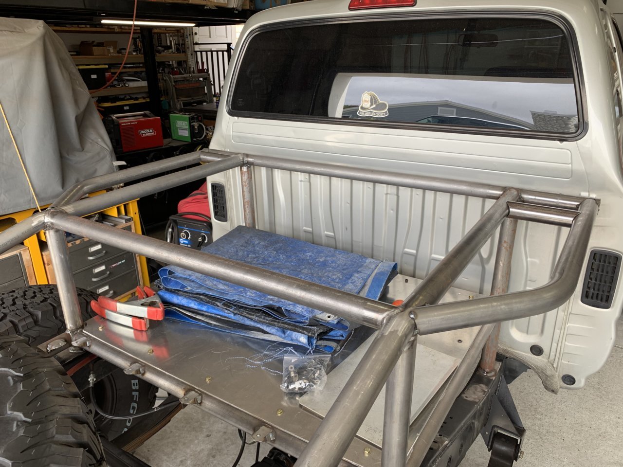

    More

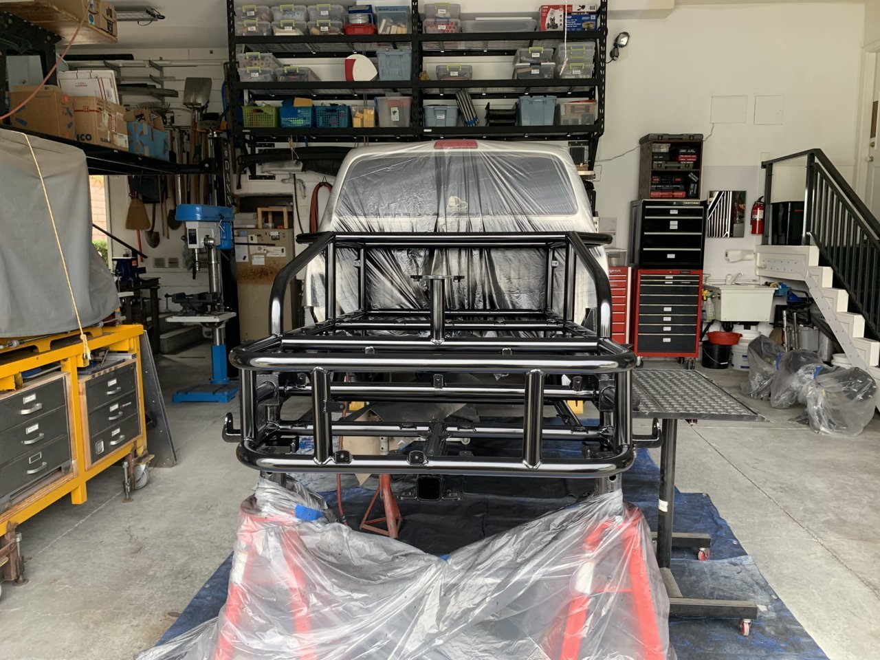

    Painting. Hoping to assemble next weekend

    Looks awesome! What muffler, v-band (for the down pipe - I'll only use one), and cat did you buy? Just got my engine to idle (didn't know the upper O2 sensor needed to be hooked up and the idle kept rising above 1800). I'd like to recreate your exhaust!
    Tacomoto23 likes this.
  10. Jul 10, 2019 at 8:46 PM
    #350
    SanClemTaco
    Sep 6, 2012
    #86354
    566
    Sean
    San Clemente
    cats are stock, i cut the exhaust about 4" part the second o2 sensor, flared it to fit a v band, cut it after flaring such that the v-band would be flush.
    after that is full custom. vbands on both sides of the muffler, custom hangars using rivnut "stock" holes.
    90 deg up and 90 deg over and out the bedside.
    i can get yours set up if your interested. final welding is not something i want to do again, too many burns and too much effort into weld position on the bench

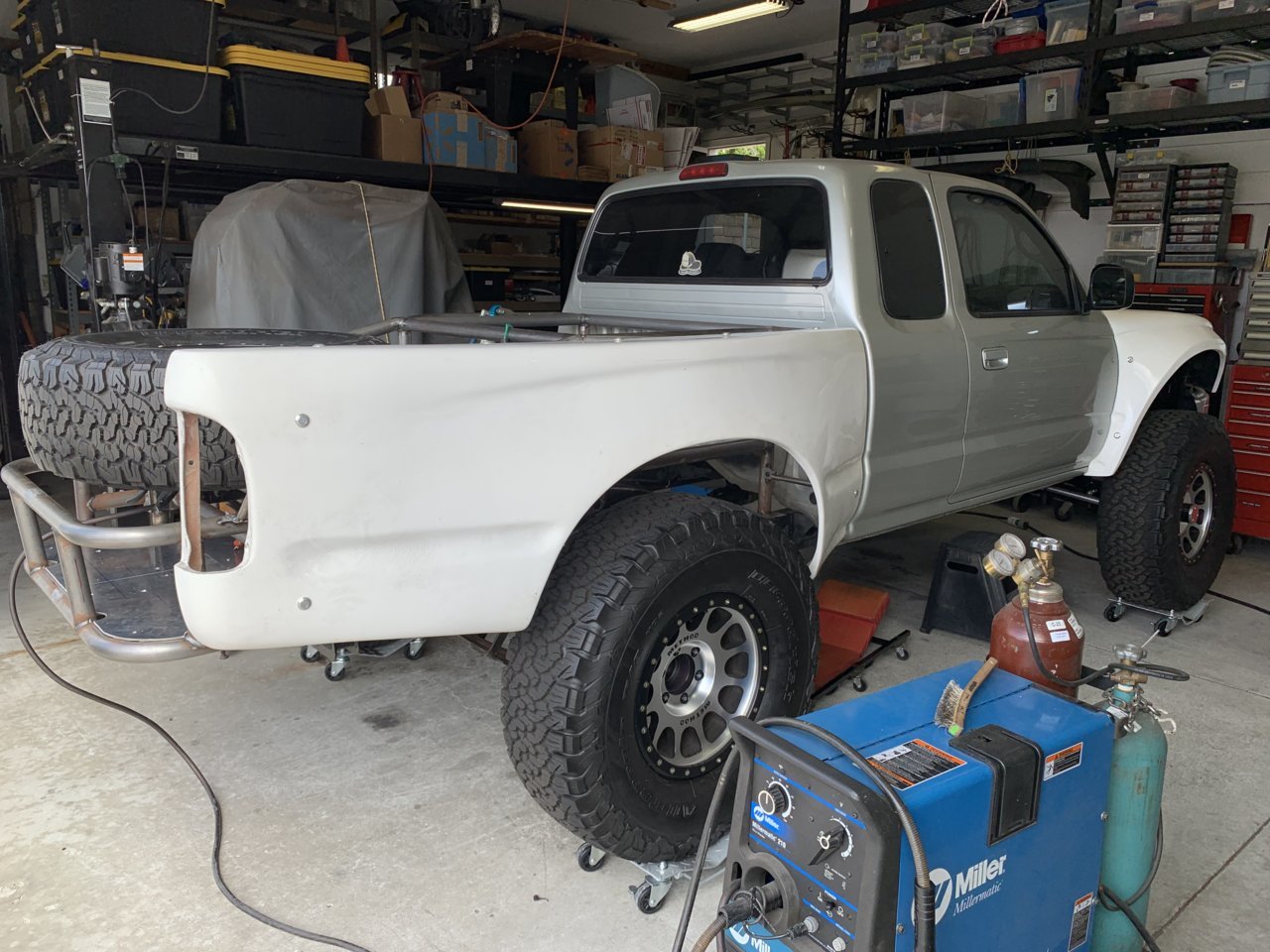

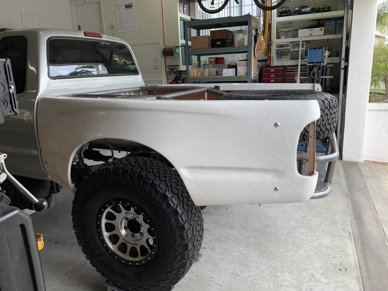

    Back on its own weight. Need to finish some of the finicky details

    you cycle the front to clear the 37s at full bump and through turning?

    front clears full bump lock to lock

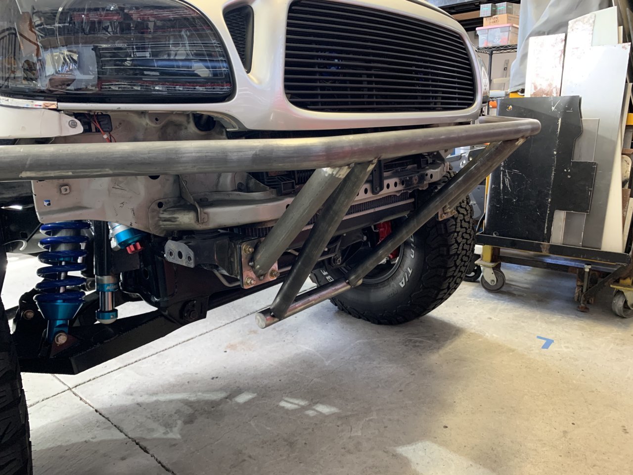

    Start of a front bumper
