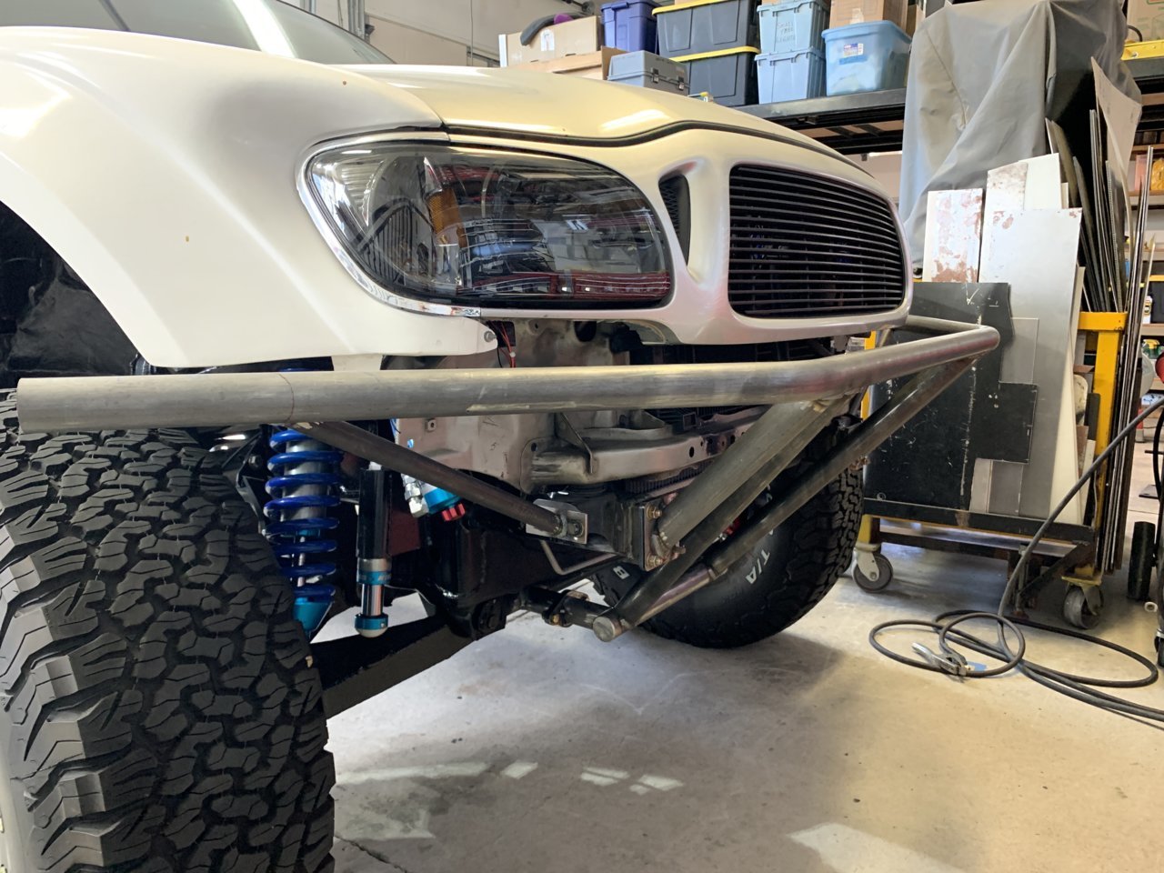

    More bumper, need to trim off excess on sides and finish the welding

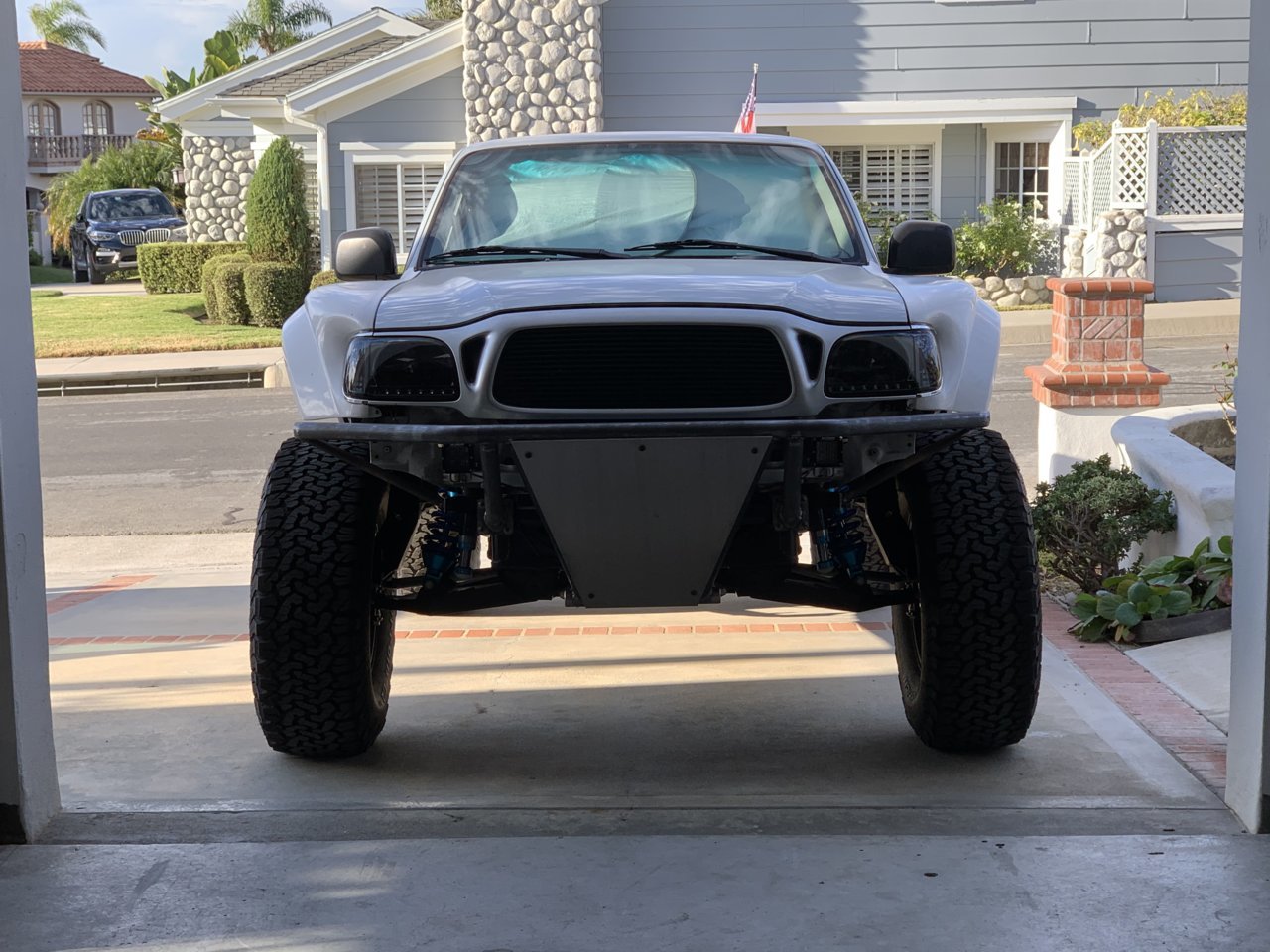

    Bumper ready for paint

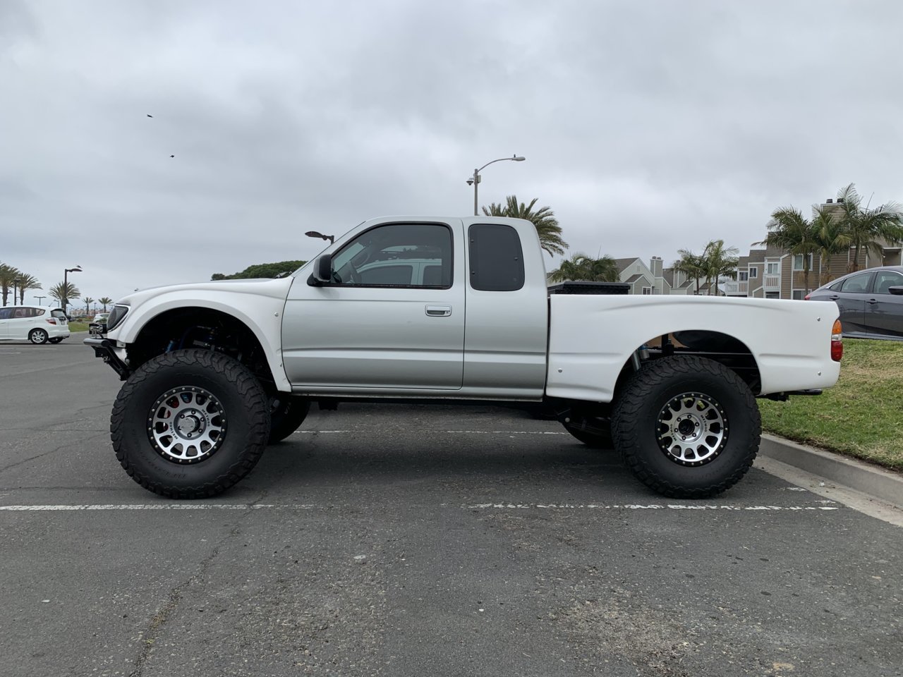

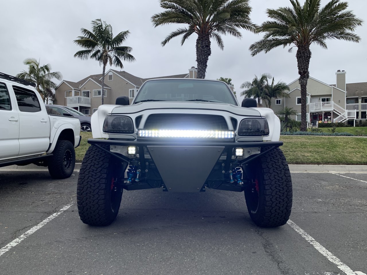

    Technically “done”. So here some beauty shots

    Looks amazing!
    How do you like the Solo kit? I think that's the direction I want to go down the road.

    ill know how it does in the dirt in a few days, im taking it out to go watch KOH over the weekend.
    for street driving, just get the standard kit.
