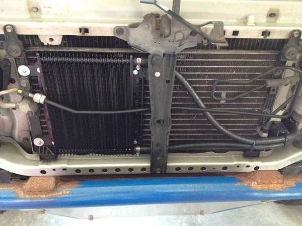

    added a trans cooler hopefully will save the transmission from premature death
    oops pic is upside down

    do trans coolers work for manuals? cause if so id like to get one. but where from?

    No such thing as a manual trans cooler, cause your gear box is bathed in oil and doesnt circulate the oil. Automatics circulate the trans fluid through the valvebody and clutch disks
