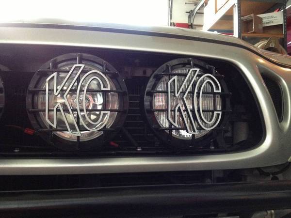

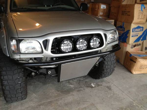

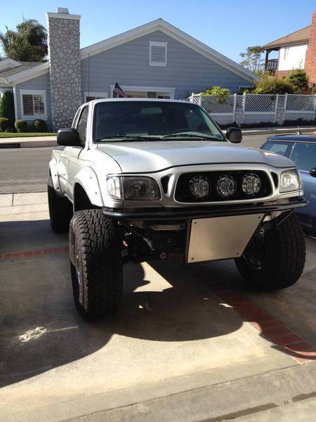

    Update:
    Few pictures of the completed bumper and light arrangement

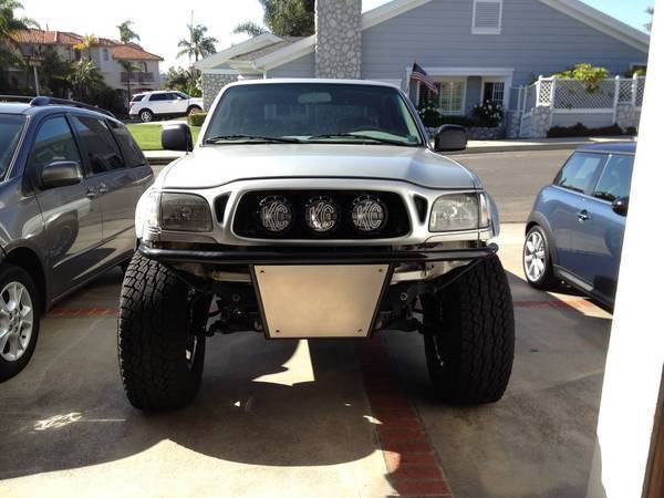

    Solo Motorsports XLT Kit, Giant 64
    new parking arrangements
    not sure i like them

    Lol. I wouldn't.

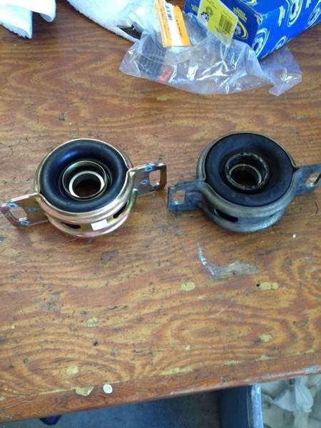

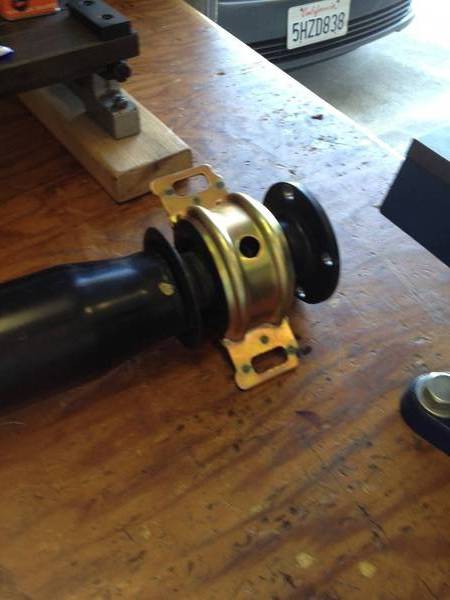

    changed my carrier bearing, hopefully it removes the lumpy feeling under my seat

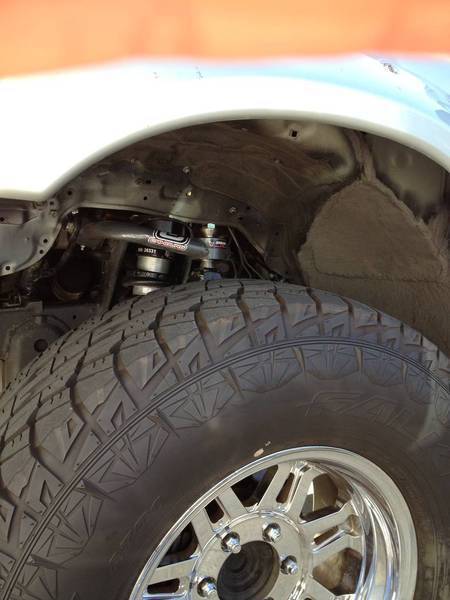

    I'm curious what style Bushwacker fender flares you have because I love the look. Are those the Cut-Out style or the Pocket style?
    I have a 1st Gen Double Cab running 285 75 r16s with a 2.5" OME suspension lift. I have minor rubbing up front on the control arms, which I can live with, but in the back, when off road, I get rubbing on the stock fender flares, which tears up the tires. I don't mind cutting away at the body -- that's what trucks are for, right? I don't see myself running 35s, but ample clearance with my 33s would be nice, or I could see going to 34s some day.
    Thanks
  14. Apr 1, 2013 at 10:45 AM
    #54
    SanClemTaco
    SanClemTaco [OP] Well-Known Member
    Sep 6, 2012
    #86354
    566
    Sean
    San Clemente
    01 Prerunner on 37's
    Ill take some pics of the bottom of my flares so u can c how much I clearanced them. To answer your question the flares r the cut out bushwackers. However they've been trimmed on the bottom so the tire can tuck into them(which means the fender is cut significantly higher then the directions require for their installation.
    I would get fiberglass if I was you. Only reason I used these flares is that they where on the truck so it was a "free" upgrade.
    Hope that answered what you needed
    Oh and wheel spacers can fix the rubbing, I use them for such a purpose until I can save for long travel

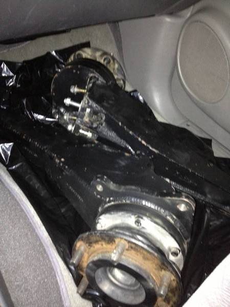

    Prob shouldve updated this months ago, but got new tires (the falkens) cost of four falkens was same as three bfg's so couldnt pass up that deal
    picked up a set of lift spindles from member on here (David)
    finally have a good alingment and no more tires rubbing the frame, at least at ride height. Finally can u-turn without running over pedestrians on the sidewalk
