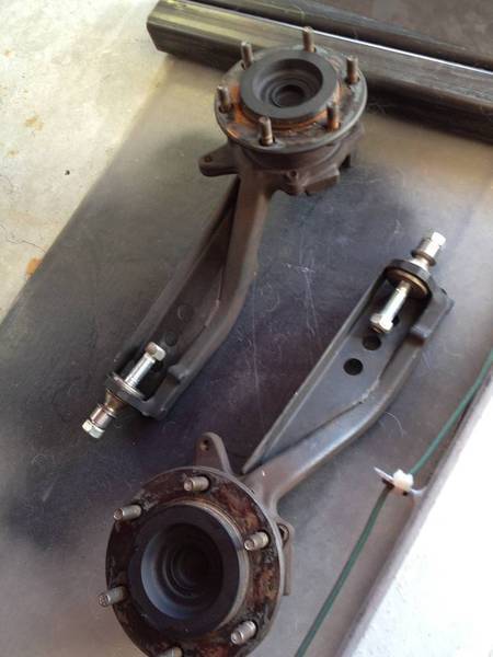

    I might sell my stock spindles if the price is right
    they are non-ABS spindles with total chaos gusset, tig welded by local welding shop (certified welding)
    The back side is fully welded and he said that was adequate cause welding the front fully would cause warpage

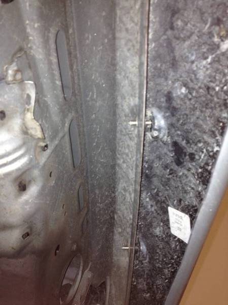

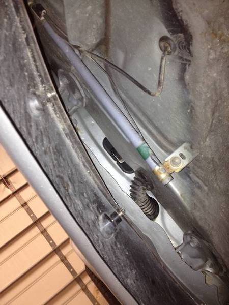

    Figured pics are better than words, is this adequate or should i try to explain, itll get a little wordy?

    Awesome thank you. I might give this a try thanks a lot.

    One thing, I lost the lower mount (wher the fender bolts up under the door) on the flare to i could turn lock to lock, so if u can pull the shock and cycle your suspension so you have adequate clearance. Im going to trim more off my bedsides because my tire decided to become good friends with it and the bedside has a nice bend in it under the flare

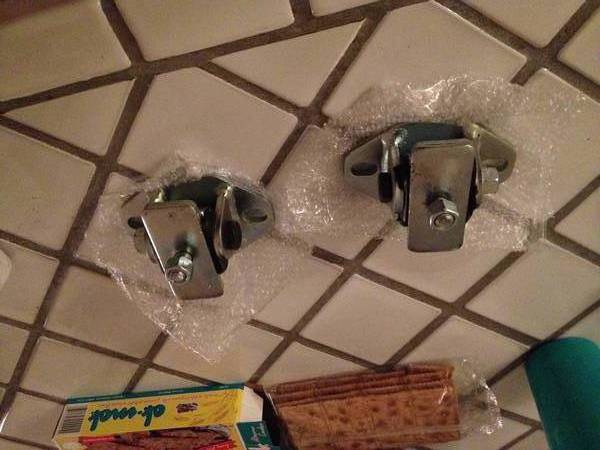

    Solo Motorsports XLT Kit, Giant 64
    Trail gear was/is having a sale on these so decided to pick a set up, hopefully will get them installed over a long weekend

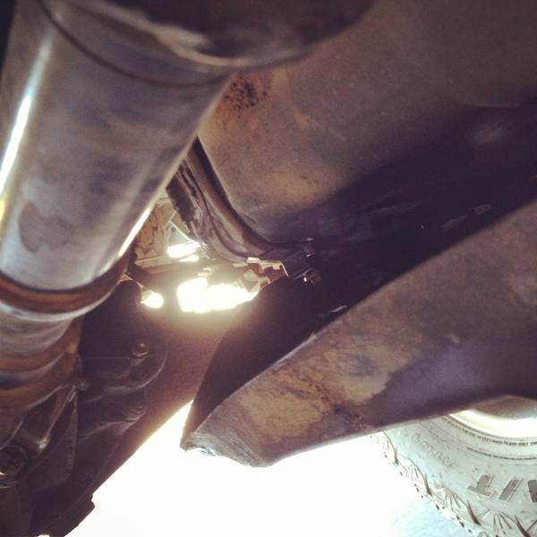

    All went well till the bolts holding the driveshaft sheared/fell off only found one it looked more like a nail and less like a bolt.
    Put a hole in my fuel tank and did this...

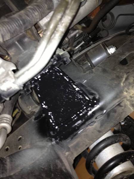

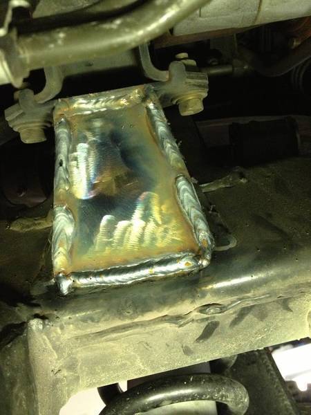

    not extremely happy with the welds, but at least its a motor mount gusset.
    Ill be getting the solid mounts installed soon and building a solid trans mount

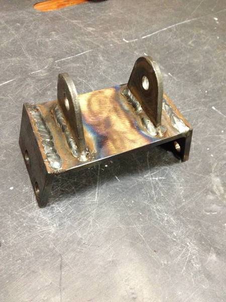

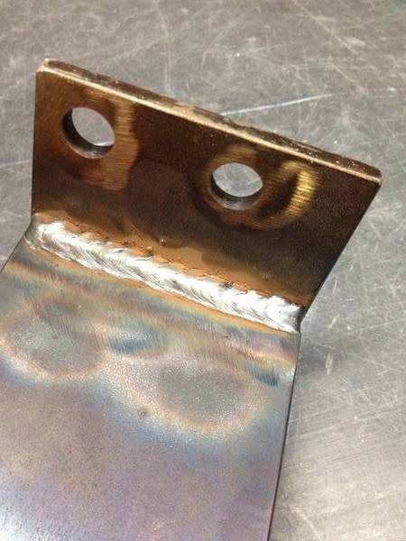

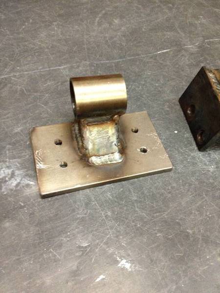

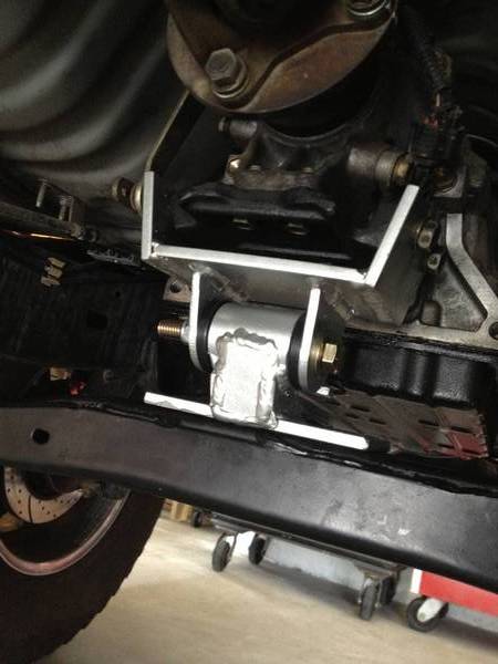

    Installed my solid motor mounts. ANd build and installed a solid trans mount.
