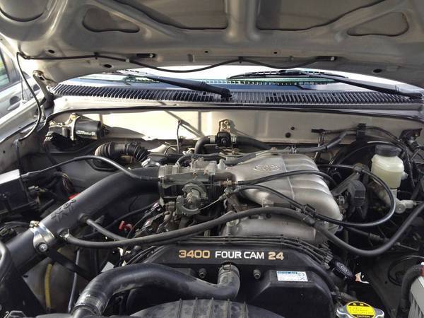

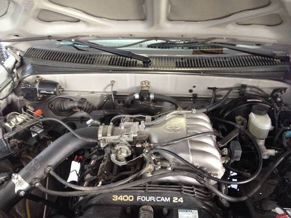

    Who can spot the difference?

    You removed something from the upper left had side. I don't have anything there either so I don't know the part.

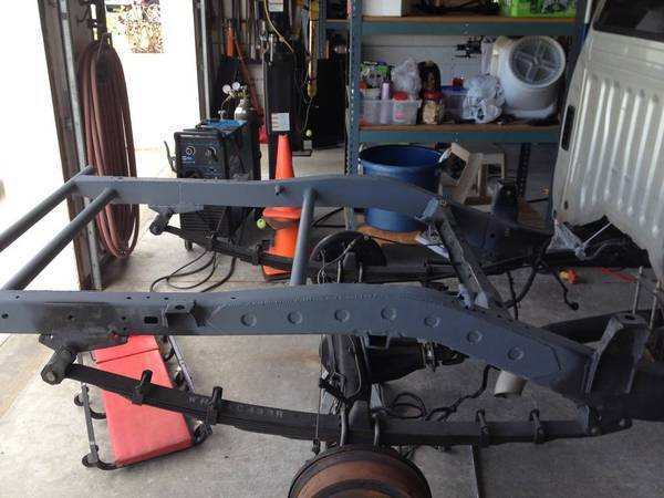

    Got a few big updates coming up. Once summer school is out new rear bumper, dual tire carrier (with tailgate), new front bumper and few other offs and ends

    still need to finish the tire rack, trailer hitch, license plate bracket, and few other odds and ends.
    but its boxed and gusseted now

    Hey I know I'm way late but in the pics above, did you add or remove ABS? If so how'd that go?

    i took it off. i lost it with the addition of the spindles, found which hard lines went from the master to each corner and kept those, took all the lines to the abs and tossed, em and the unit. only difference is the permanent abs light and a simpler brake line set up.
    you may want to look around and find the non-abs tacoma hardlines, im looking but my google searches have come up empty
