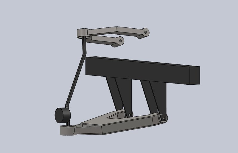

    Decided to try my hand at suspension design in solidworks.
    Turns out its not as difficult as I thought it would be
    Once I finalize the everything, I can start building fixtures and get the pieces cut out
    For those wondering:
    its 3.5" over
    5* caster at ride height
    .5* at full droop
    9.5* at full bump
    wheelbase is pushed forward 1"
    ~17" if i run a 10"coilover
    ~14" if i run an 8" coilover
    it will bolt onto stock mounts

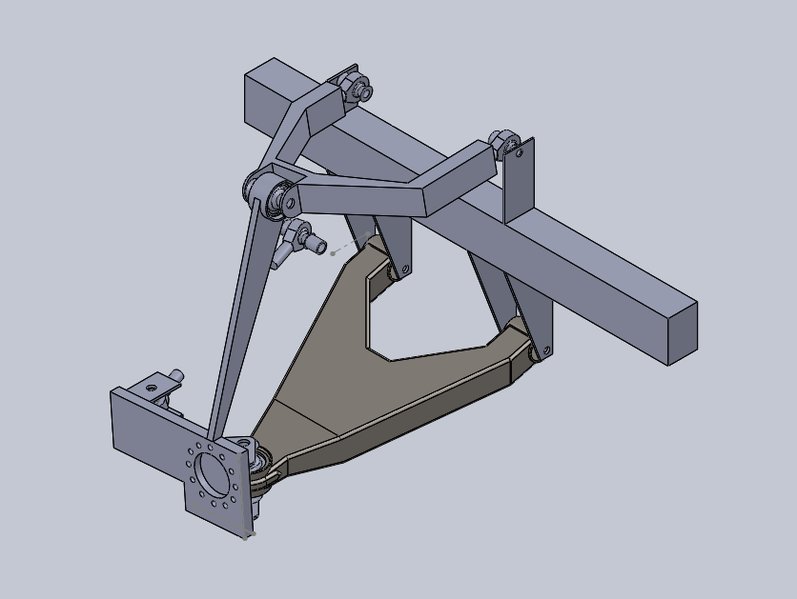

    Design has changed, the upper mounts have been changed to help with the camber and caster curve. but the lower mounts and steering rack will remain "stock"
    obviously things arent close to finished, a lot was done as quick as possible to confirm geometric constraints
    Edit: This has been scrapped too; scrub radius once measure was 3" which is wayyyyyy toooo much

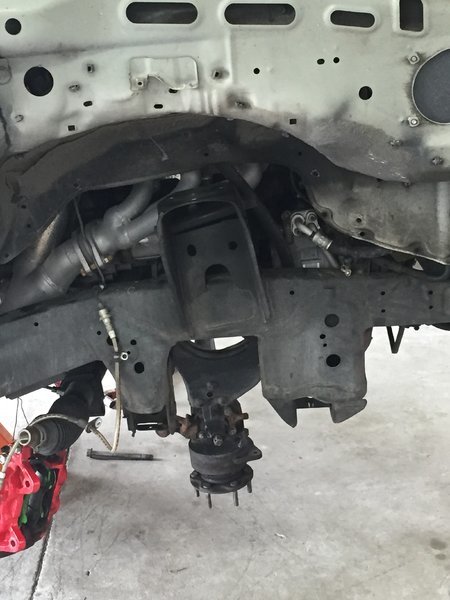

    I caved....so now this is on order
    While designing my own kit would have been awesome. The parts cost alone was more than just ordering a kit. Granted the DIY would have had more travel, but being my daily running an unproven kit just didn't sit right with me

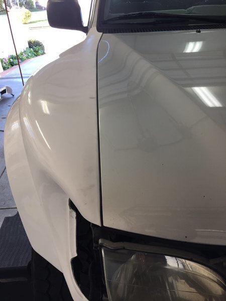

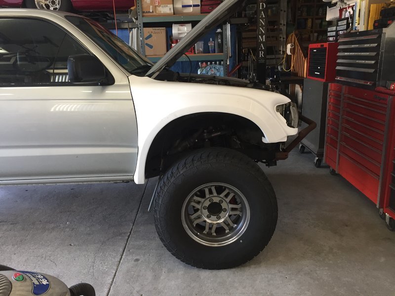

    It's begun. Going to do the entire installation of the Christmas weekend, but got to test fitting one of the fenders.
    ChadsPride and jules04taco like this.

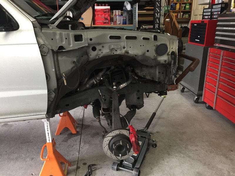

    It's begun

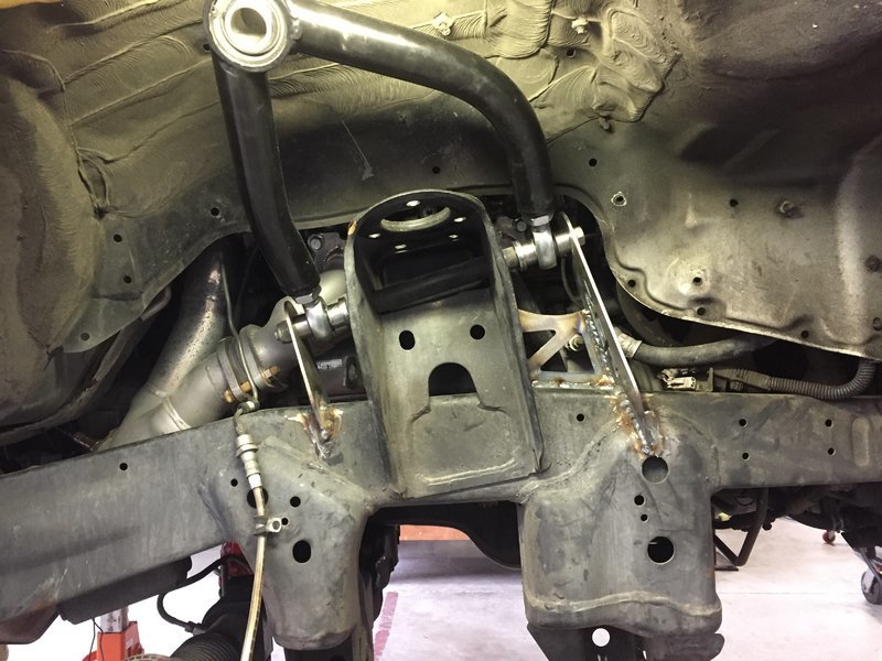

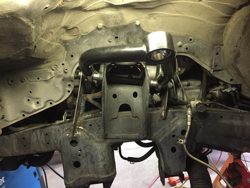

    Uca gussets all finished minus paint
    ChadsPride likes this.
