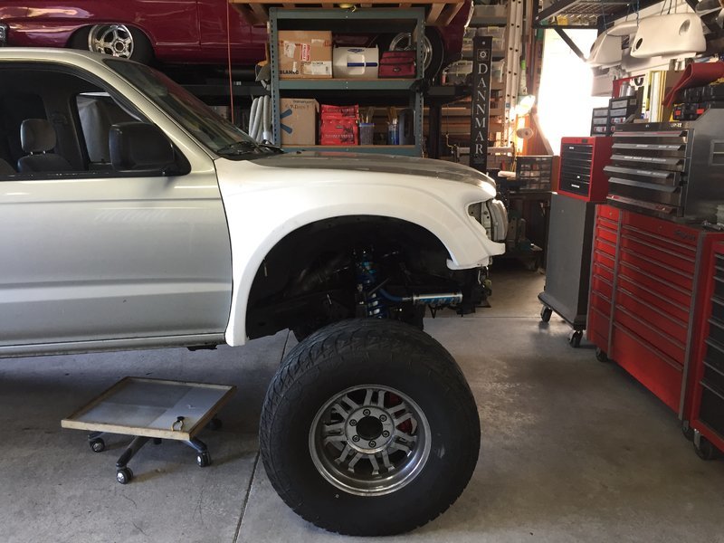

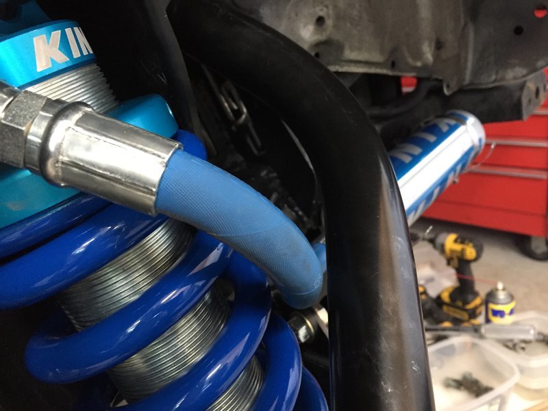

  3. Dec 26, 2016 at 12:06 PM
    #123
    SanClemTaco
    SanClemTaco [OP] Well-Known Member
    Sep 6, 2012
    #86354
    566
    Sean
    San Clemente
    01 Prerunner on 37's
    Solo Motorsports XLT Kit, Giant 64

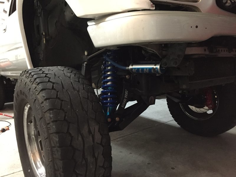

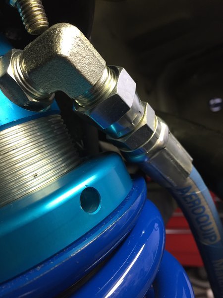

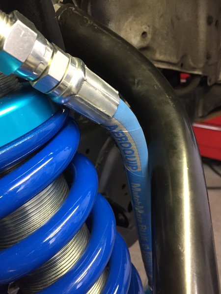

    Can anyone help me out? The uca is hitting the reservoir hose and I can't turn it enough to clear with out the fittings hitting the upper spring perch
  4. Dec 27, 2016 at 11:33 AM
    #124
    SanClemTaco
    Sep 6, 2012
    #86354
    566
    Sean
    San Clemente
    Fixed the ^ issue

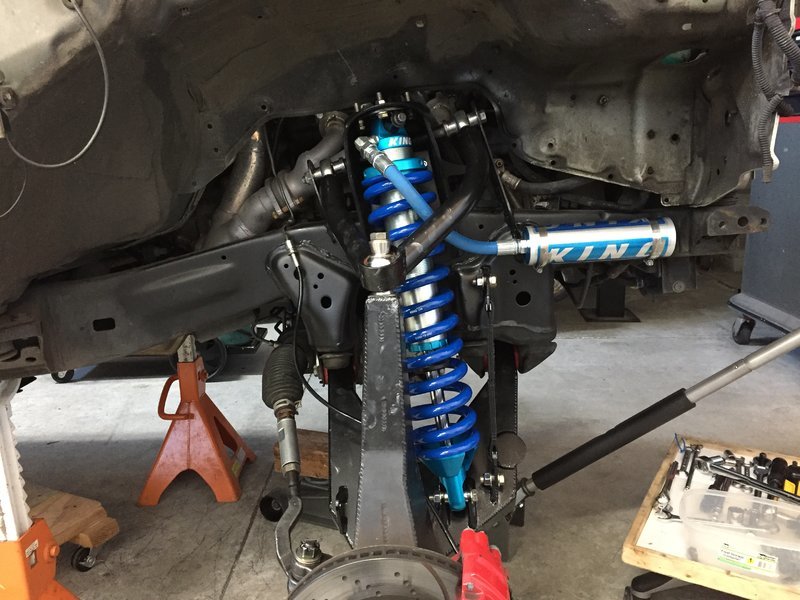

  5. Dec 28, 2016 at 8:12 AM
    #125
    SanClemTaco
    Sep 6, 2012
    #86354
    566
    Sean
    San Clemente

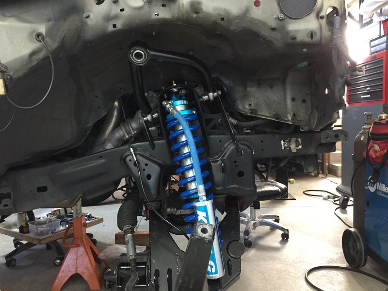

    After way too much bs the passenger side is done with the driver soon to follow
    boostedka likes this.
  6. Dec 29, 2016 at 11:48 AM
    #126
    SanClemTaco
    Sep 6, 2012
    #86354
    566
    Sean
    San Clemente

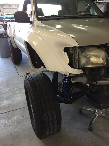

    The suspension hasn't settled down all the way yet, but passenger side is all but finished

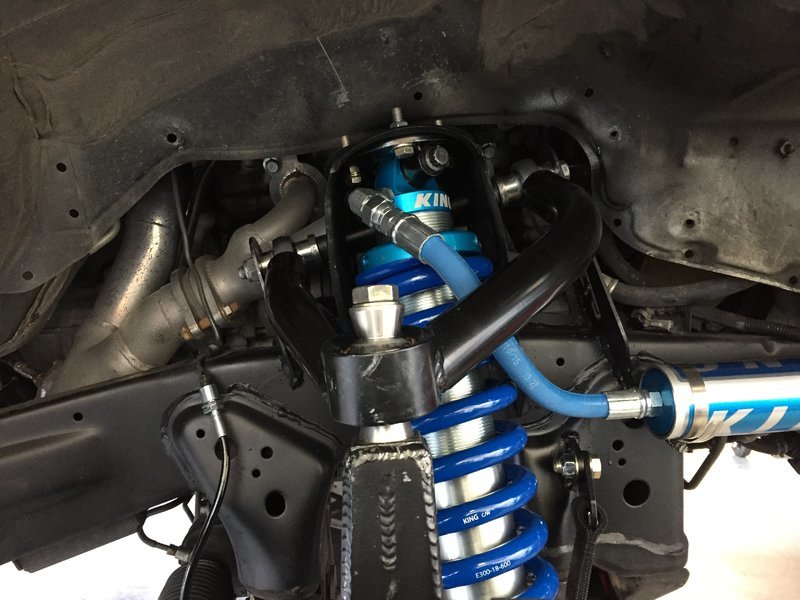

  7. Dec 29, 2016 at 1:45 PM
    #127
    Clay_916
    Clay_916 Well-Known Member
    Jul 30, 2015
    #160686
    1,501
    Fort Collins, CO
    2000 x-cab 4x4
    5100's, All Pro 3" Standard leafs, 32" KM 2's
    Don't think that top mount on the shock is correct. The bolt needs to be roughly parallel with the axle the UCA rotates around.
  8. Dec 29, 2016 at 1:59 PM
    #128
    SanClemTaco
    Sep 6, 2012
    #86354
    566
    Sean
    San Clemente
    It is, I called solo motorsports to confirm that this is the correct orientation. The upper mount can rotate around the misalingment spacers
    If i run into issues ill need to get a new reservoir hose so the upper mount can be turned to its original position, but for now i just need it to be drive-able to work and back. It doesnt have appropriate bump control either, the stock bumps need spacers to do anything the way they are mounted currently so it'll only see street use till everything is corrected, but thanks for the advice
    EDIT: See the following posts, i changed the orientation and fittings so now its inline as stated here

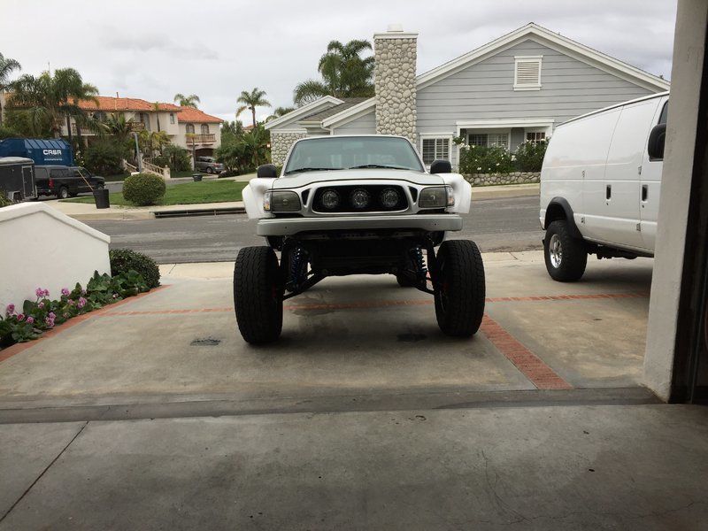

  9. Dec 31, 2016 at 4:08 PM
    #129
    SanClemTaco
    Sep 6, 2012
    #86354
    566
    Sean
    San Clemente

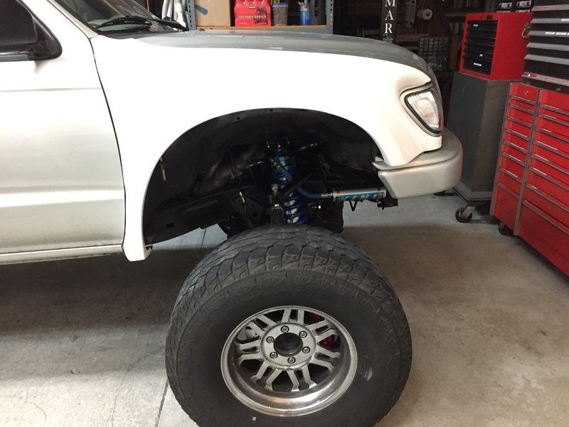

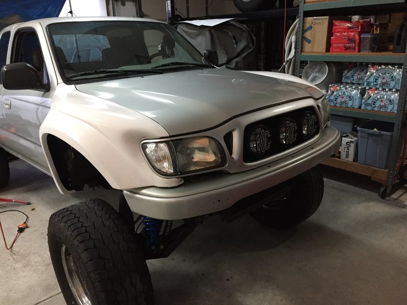

    She lives, need an alignment, but the car parked behind doesn't run so I'm stuck in the garage for now
  10. Dec 31, 2016 at 5:52 PM
    #130
    boostedka
    boostedka Well-Known Member
    Sep 29, 2011
    #64367
    6,013
    James
    NM
    2013 DCSB 6MT, 2004 4runner
    That shit is so wide! Looks sic! Nice work. You have any pics of the suspension now that it's sitting on the ground again?
  11. Dec 31, 2016 at 5:53 PM
    #131
    SanClemTaco
    Sep 6, 2012
    #86354
    566
    Sean
    San Clemente
    ya, 83" outside tire to outside tire
    I can go and take some more, it will come down a bit after i take it around the block because it hasnt settled yet, still basically at the height it was on jack stands

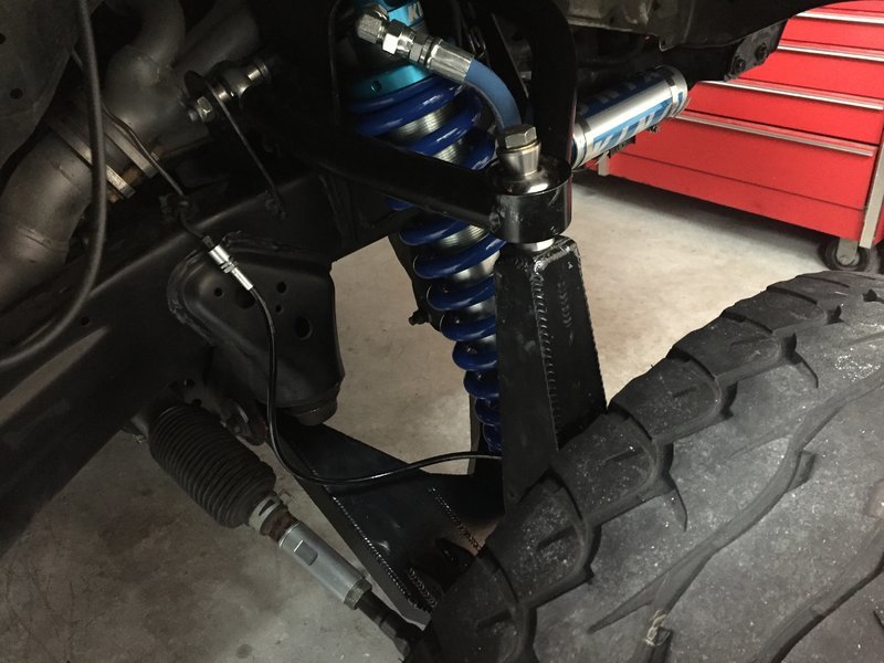

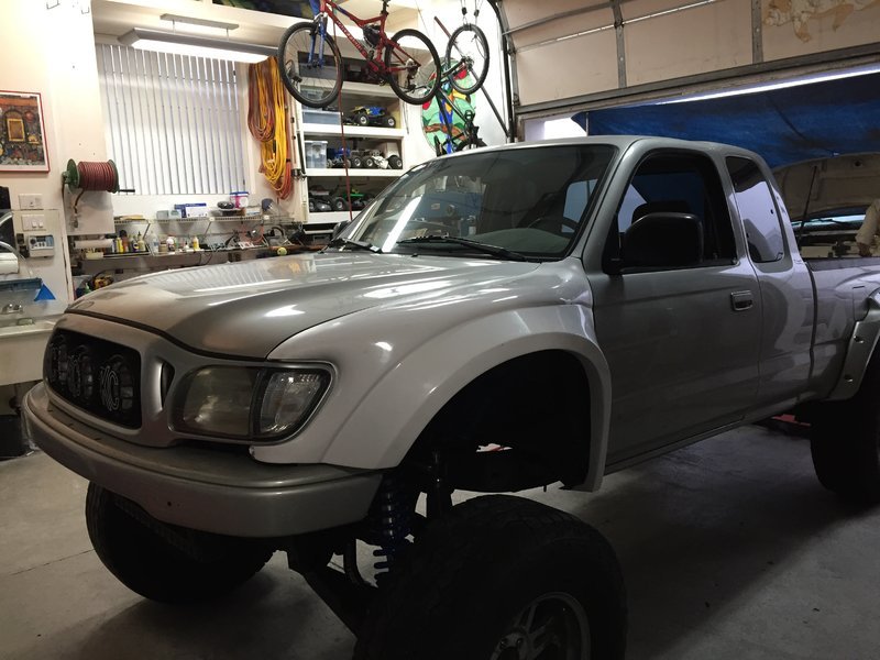

    More pics per request

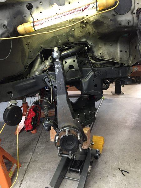

  17. Jan 3, 2017 at 12:51 PM
    #137
    SanClemTaco
    Sep 6, 2012
    #86354
    566
    Sean
    San Clemente

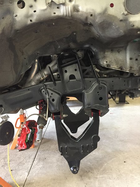

    Well no alignment shop anywhere near me was willing to touch my truck, so i used jberry's method and set an alignment used angle finders and tape measures.
    Also have new reservoir hoses on the way so I can swing my shock body more forward and pull some preload out because it sits way up there and i cant get it lower without hitting the coil nut (again...)
    Photo taken prealingment
  18. Jan 7, 2017 at 10:51 AM
    #138
    FlapJack935
    FlapJack935 i member
    Nov 25, 2013
    #117294
    3,191
    Jack
    Abq New Mexico
    Wannabe Trophy Truck
    Sick Gnar Trophy Truck Tacoma and King Ranch Raptor Killer
    those are the solo spindles right?
  19. Jan 7, 2017 at 11:50 AM
    #139
    SanClemTaco
    Sep 6, 2012
    #86354
    566
    Sean
    San Clemente
    correct, the 3" lift spindles
  20. Jan 28, 2017 at 11:48 AM
    #140
    SanClemTaco
    Sep 6, 2012
    #86354
    566
    Sean
    San Clemente

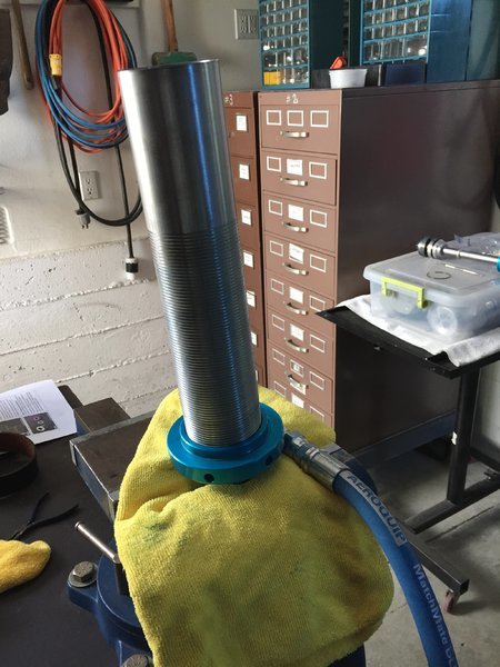

    Finally time to change the reservoirs
